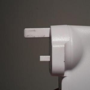

    There's been talk of tat Chinese imports of late so thought I'd pipe up. I've been asked if I can fix this... Extra low voltage power supply line and neutral pins snapped off leaving them not protruding, but exposed with shutter open, in a child's room. Pins are poor quality and appear undersized.
