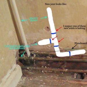

    This may make no sense or this may explain the set-up now. I've drawn on the 'before burying' photo to try to show how it now looks and the joints that could be leaking.

    Around 12.30 today Not specifically no. Cold feed - the suspect joint is likely to be where it splits into two and feeds the whole bathroom. One bit goes to the electric shower and the other bit splits (once in the bathroom) to feed the toilet, bath and wash basin. There is also a hot feed...

    Well like I said we go him through my builder, and he's listed of having up to 1million of public liability insurance so we're hopeful. But we just didn't know how to proceed other than trying to get in contact with him. Ideally we'd get an emergency plumber in as we could really do with...

    Copper with soldered joints. What are the rules on getting someone else in, since using him we have switched plumbers and get all of our plumbing done by our gas man. So we have someone we trust to rectify it but we have fully decorated since the job was done. We did a full refurb on the...

    We had some work done by a plumber from mybuilder - about 3 months ago now. We've just noticed today when moving furniture around to vac that there is a damp patch on the wall corresponding to some pipes he moved, rejoined and buried in the wall. We have sent him an email explaining what...
