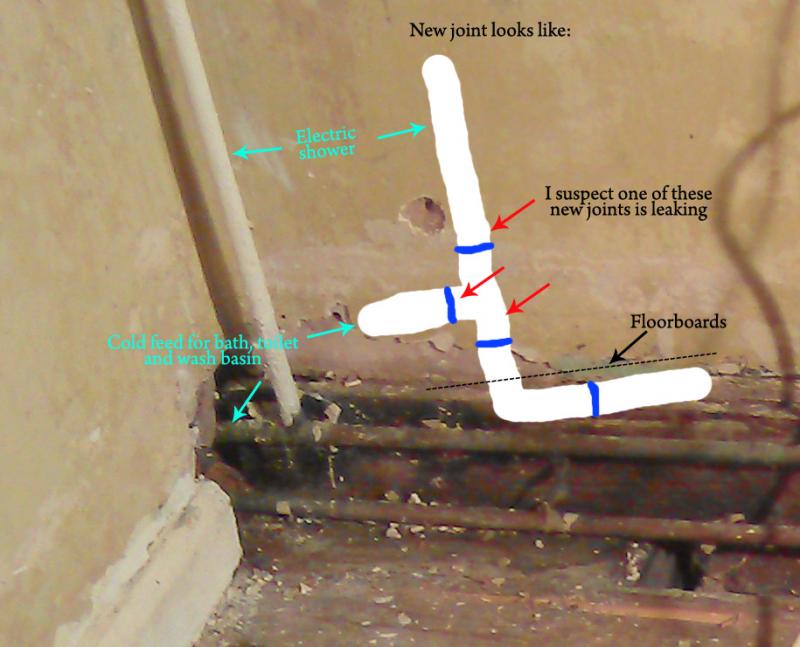

We had some work done by a plumber from mybuilder - about 3 months ago now.
We've just noticed today when moving furniture around to vac that there is a damp patch on the wall corresponding to some pipes he moved, rejoined and buried in the wall.
We have sent him an email explaining what we've found and have added pictures.
There is damp all along the adjoining bathroom wall and also two small damp spots on the kitchen ceiling.

It doesn't sound good if I'm honest, what kind of pipe work did he bury in the wall ? Was it pushfit plastic stuff or copper with soldered joints?
Copper with soldered joints.

3. What is the suspect pipe, or pipes, supplying - domestic hot and cold, or central heating, or rising main?
Cold feed - the suspect joint is likely to be where it splits into two and feeds the whole bathroom. One bit goes to the electric shower and the other bit splits (once in the bathroom) to feed the toilet, bath and wash basin. There is also a hot feed that he had to drop a bit, but we haven't used any hot since we moved in, to the point that we actually have drained the hot water cylinder.

Same as above, with how the bathroom is fed the leak is almost definitely on the cold joint that splits the main supply. So we have to isolate the whole bathroom or nothing. Unless there is something I'm missing, after all I'm obviously not a plumber.
This may make no sense or this may explain the set-up now. I've drawn on the 'before burying' photo to try to show how it now looks and the joints that could be leaking.
Going by your drawing If it was leaking from the Tee Joint the main damp patch would be some distance from the floor, can you get to the pipework from the Bathroom or does it all run at floor level.

Could the flooring covering the pic area be lifted?
