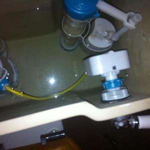

  5. R
    Toilet continually running
    that was my thought. by top part do you mean the whole central part and the yellow wire? thats the bit i can get off really easily. would MKM or similar stock something like that? thanks
  6. R
    Yeah I think that is where it is. When I push that down it does stop, its like it goes down halfway atuomatically but whatever mechanism makes it go all the way has broken/come apart. I have taken it out but can't see anything and not sure how to get 'inside'.
  7. R
    Hi My in-laws are having a problem with their toilet continually running through into the bowl. A visiting friends child pulled too hard on the flush which seemed to cause the problem. I have included some photos of the mechanism incase someone can identify it and where I may get a...
