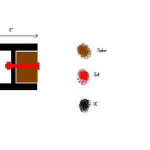

    Timber in steel web.
    I put my pads in as low as I could get them without disturbing the existing ceiling joists. Since which the building control officer (brilliant bloke) has been round. He took one look at the pads and said... "Could of just put a plate in, that would of got them lower" In a nutshell he...
    Sorry in advance if I'm being plain old thick...... but... How can I notch joists on to the steel when my finished floor level is (roughly) the underside of the steel?? Joist are to be 150x50 covering 5.8m span (3m lengths bolted in the middle, resting on load-bearing wall) Thanks for...
    This is what I'm getting at, or am I completely off target?? The finished floor level is roughly the bottom edge of the steel.

  5. J
    Have just installed my steel (UC's) at the weekend. (Up through the house with the aid of 4 friends, 1 length of chain and some adult sized nappies...) Now, the timber that gets bolted into the web (for the joist hangers).. Does it have to be a specific type/grade of timber?? Or just...
