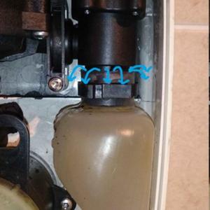

    Mira Event XS shower leaking
    Well great news, I put a metal jubilee clip on last night and it worked a treat! The leak has completely gone, even with the pump on full pressure. Well chuffed! Thanks a lot for your help St0rmer66, it is really appreciated! Cheers, Andy
  7. R
    Thanks St0rmer66 for the suggestion about the jubilee clip I will give that a go. What happens is when I turn the shower on the clear plastic damping vessel fills up with water as it should but when the water reaches the top of the vessel where it meets the solenoid valve it spills out of the...
    Hi all, Today I replaced the Solenoid Valve Assembly (part # 453.13) on my Mira Event XS Thermostatic power shower as I suspected the old one was no longer working correctly. The shower seems to work ok now, however I have a leak where the Solenoid Valve Assembly meets the Damping Vessel. I...
