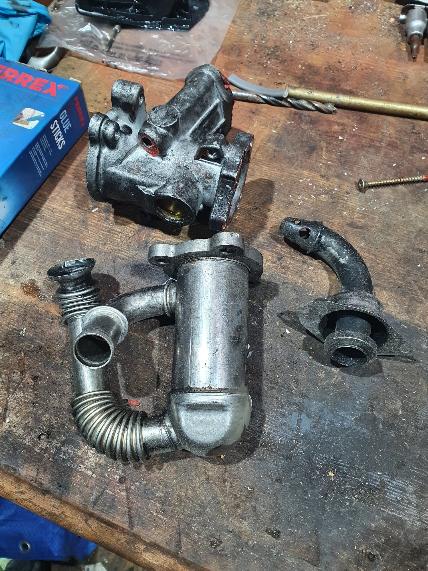

Hi folks,
I took on a project in the full knowledge that the vehicle didn't run properly , so only have myself to blame!
Vehicle - Fiat Panda 1.3 multijet diesel 2010, 100k mileage, full service history.
Issue - vehicle struggles to start and when it does it cuts out almost instantly. It will eventually tickover but it smokes grey out of the exhaust and is very reluctant to rev , it misses badly. Any attempt to drive the vehicle and it stalls.When the car reaches temperature it stops smoking and will move , but is massively down on power, far more than limp mode would be. The engine sounds sweet as a nut , just completely gutless.
What I (and the previous owner) have changed tried to date:
MAF
MAP
Cam sensor
Turbo (brand new)
EGR (brand new)
Previous owner removed cat to check for blockages
Wiring checked as much as possible
Air intake checked for blockages and whole intake system swapped with an identical vehicle (see below)
Fuel filter housing swapped with identical vehicle
Fresh fuel added
Fuel rail switch swapped with identical vehicle
So far nothing I have done makes any difference . There are no fault codes and live data seems with my limited knowledge to be in acceptable parameters , but very happy for someone else to tell me otherwise.
I have an identical model Panda as a donor vehicle for parts swapping if required , but I still can't make sense of it ☹️.
Any genius ideas ? (please)

It is/was. It was replaced 3 months prior to me purchasing the car. What I didn't know until I ripped it sort was that they changed the valve but not the solenoid! Two blanking plates later and it goes like the clappers :cool:
Obviously it was stuck fully open then! Ghastly things but they do reduce pollution and your MOT test shouldn’t be affected - as far as I’m aware.
