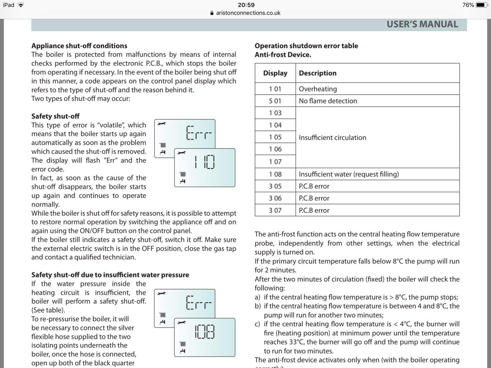

Have a look at this quick video I made of my boiler fireing up and the water pressure going right up and then it cutting out with a 404 error. what do you think?
FF
Good evening ff,
According to your manual (if it’s the correct one Ariston E combi evo) e104is insufficient circulation, and judging by that video, appears that there seems to be a couple of issues. My advice is to obtain the services of a gas safe engineer to sort that for you.

I think you have a 104 error code and not a 404 error code, your pump has stuck/failed

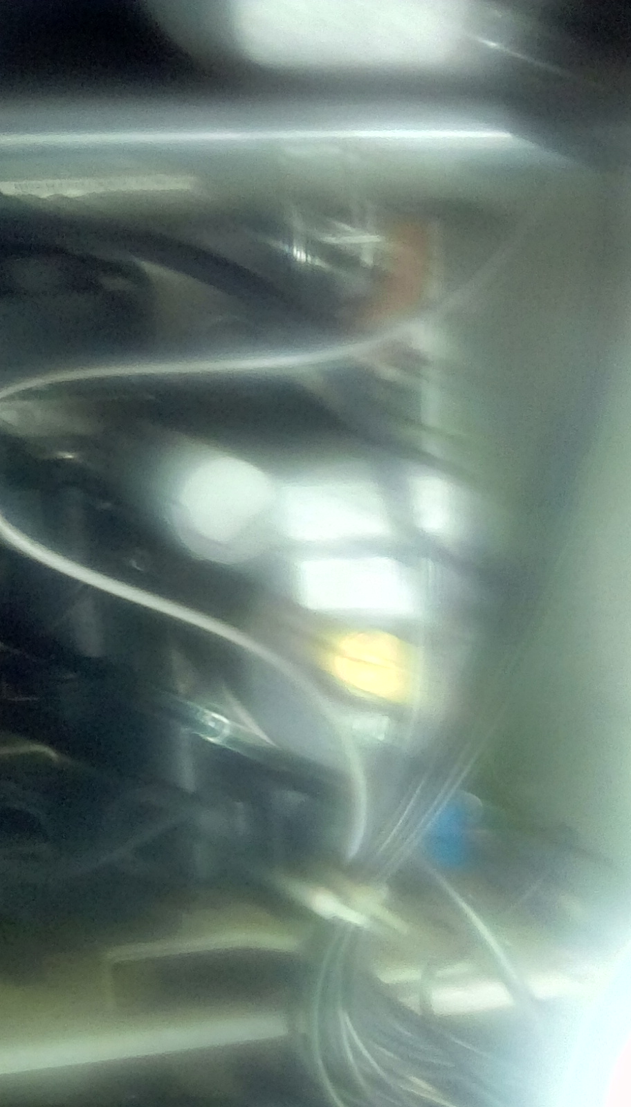

So should I start by checking there is no blockages to the pump first?
check to see if the pump is spinning
how are you supposed to see if it spints, do i have to remove the pump and strip it down or something?
No the big brass srew at the front of the pump, is just a cap , remove that and see if the shaft is spinning, if it isnt that is your problem but you can sometimes free them by spinning the shaft with a screwdriver , have a towel undr the pump when you do it as some water will come out
so you unscrew the brass cap and water squerts out, should it stop pooring water out at some point?
