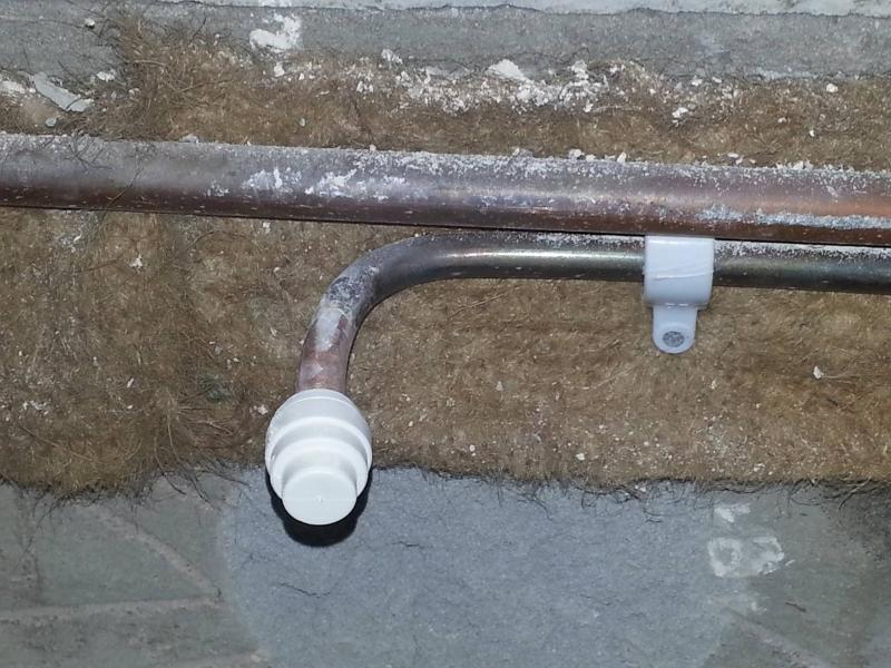

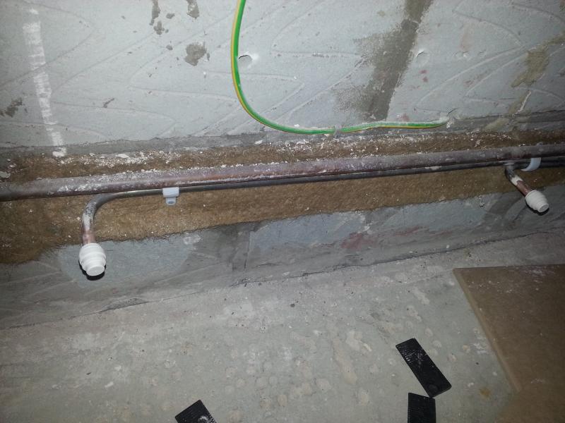

This is the 10mm (microbore) pipes coming out of the wall. What a disaster this downstairs toilet has become. Having tiled the whole room I wasn't happy entirely with the tilers work. Only one way to do it and that was the right way (perfect).
I had to bash all the tiles off with plasterboard......
Anyway below are the pipes. The left one is slightly curved inwards, a slight kink compared to the right side. I measured just under 490mm pipe centre probably more 480mm. I am limited to what chrome towel rads are out there with this pipe centre. So alternatively I could find the rail I want which is close to 480 and make an adjustment to the left pipe? How would I do this? Any suggestions first before I resort to a plumber who pick their jobs... :roll:

The above rad (link) has been discontinued (after I had ordered it) but might be available on another site. £290-£311!! But it has the btu and pipe centre I want. So is it worth making serious adustments to alter the pipe centre? Or search high and low before I find thar towel rail that meets my pipe centre? :roll:
