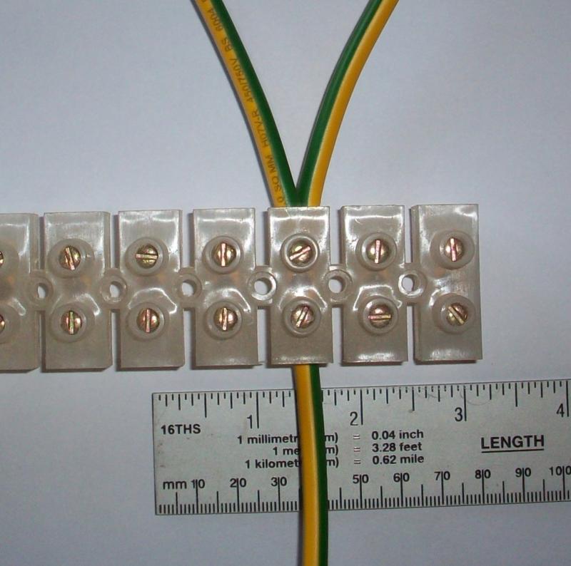

What's the best (neatest) way of connecting 2x 10mm 3 core SWA and 10mm singles inside an adaptable box? The electrician suggests putting some Henley blocks inside (presumably plus an earth bar for the third core/armour). Would Pratley end connectors, or a DIN rail solution, allow a smaller box? Or any other connector?

Henleys (probably just one DP one), plus something for the CPCs/earths, would certainly be one way to do it, but wouldn't a simple 60A connector strip be adequate?

It looks like 3x10mm2 cables will fit 60a choc block ok, but they don't look as substantial and one screw will clamp two cores. Are they just left loose inside the box and wrapped in insulating tape?
True, and I'd probably be inclined to use a small Henley for that reason. However, 3 x 10mm² will go into a 60A connector strip:
You don't even really need the tape.
