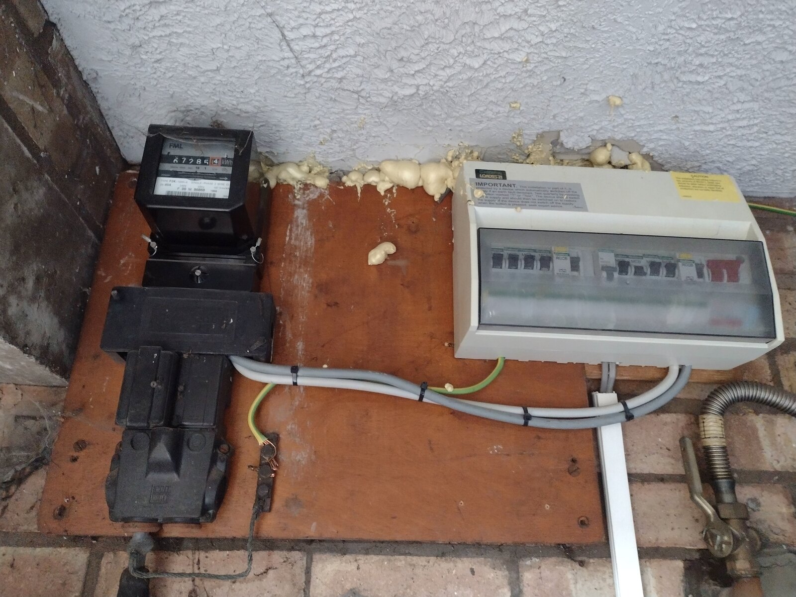

Such as this example:
Read more: https://www.diynot.com/diy/threads/a-real-moan-tonight.552183/#ixzz7NAeTUnba
the white conduit on the left would ideally have entered the side of the CU but there was an obstruction below the conduit.
The black SWA is glanded straight in.

Oh I wasn't trying to point to the thread, I only used part of the picture to show the white conduit box as an example of where a box would be an advantage.
The additional box on the right side of the CU happened to present a significant risk to safety but it wasn't the box that caused the risk, (and indeed an additional box is highly unlikely to cause such a risk) it was a rare external fault and (in my opinion) poor practice that created the hazard.
