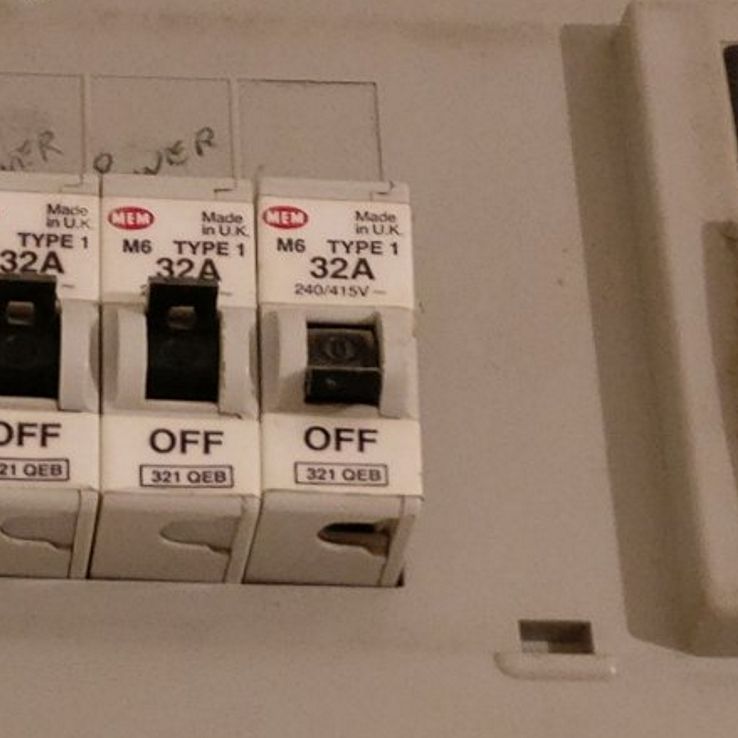

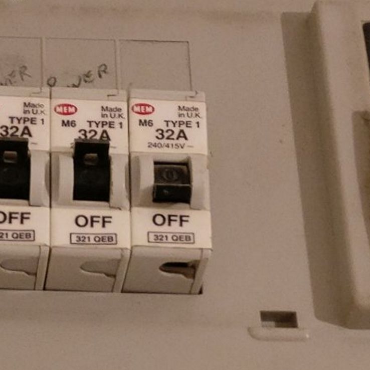

This is the CU and location I am trying to get to
The right hand MCB has a hole in the bottom, and live parts may be exposed.
It's also undesirable to add a new circuit to an installation which only has a single RCD - it's non-compliant already and by adding another circuit you are making it worse.
Thanks flameport, I will replace that MCB, that is the one I plan to use as supply for the SWA as it was originally for a power shower that has now been removed.
So are you saying I would need a new CU to achieve what I want to? Or could I get by with what I have?
To be compliant with BS7671 you would require a new consumer unit.
The arrangement you have is not unsafe, but does not comply as a single fault will trip the RCD and disconnect power to the whole house.
Adding the garage circuit makes this even more likely, particularly as garages are often damp/wet, the sockets within are likely to be used for things outside, and outside lighting is often installed.
It's still not unsafe - but could result in non-trivial inconvenience in the event of a fault, since you won't be able to switch the power on until the fault is located and repaired.
Thanks again! As long as there are no safety concerns I will go ahead with the current CU for now and perhaps look at replacing it down the line. I will replace the damaged MCB with a new one when I connect the supply.
