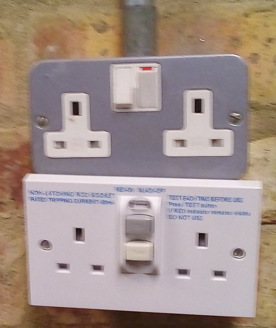

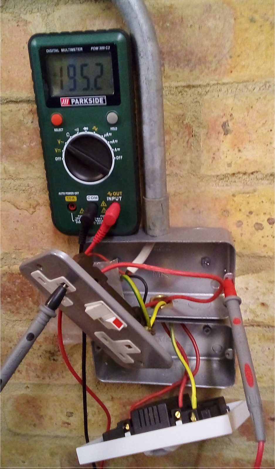

It is one of those 'several people have had a look so can you go in and sort it out' jobs, I popped in to aquaint myself with it with the expectation I'd get the call when required.
This is an outbuilding [happens to be an ex telephone exchange] currently used as changing room and pump house for a swimming pool and a koi pool. There is a foolscap log book for all of the history of the complex including all repairs etc, dosing, feeding, etc.
Problem: Intermittent RCD tripping, but when it happens it seems to occur for a number of days then fades away again.

Customer has generator and flood lamps so I was able to turn off main isolator to remove face plates.
Apologies for the poor quality pictures.
So I removed the RCD socket [which was installed only a few months ago by a previous electrician to overcome the tripping issue] and found 2 red wires then removed the screws for the metal clad and nearly got thrown across the room as I pulled it off the back box

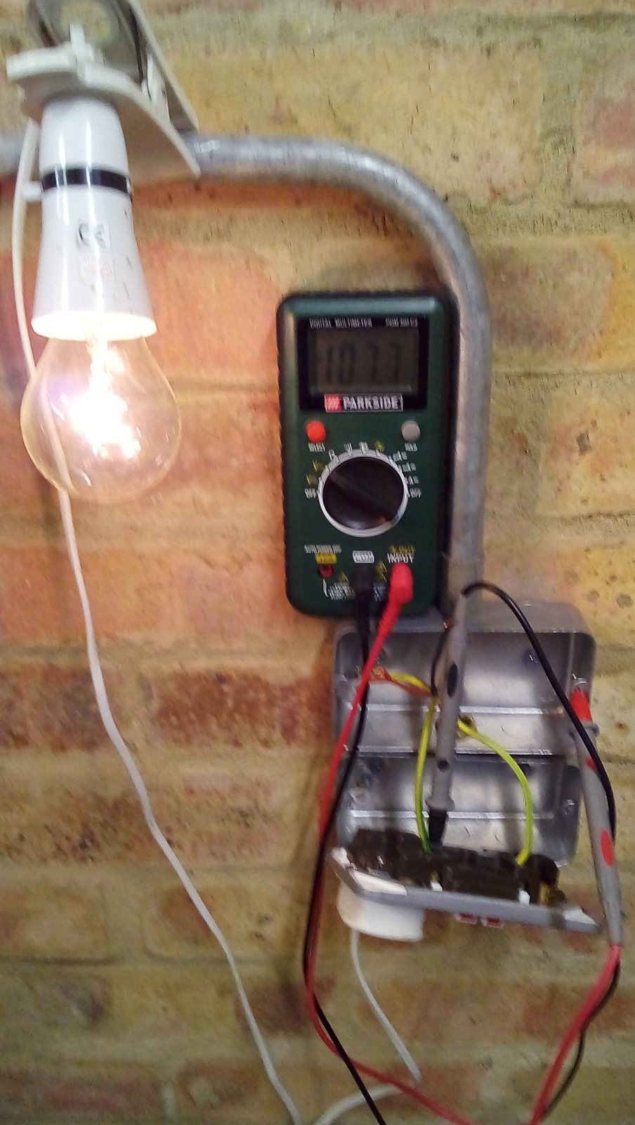

A bit later I rigged this to see if the volts between CPC and back box are real.
I've connected the L & N of the socket to CPC and earth terminal in back box to power a 60W bulb to double check this isn't a high impedance meter issue.
That voltage was changing as rapidly as a fiddlers elbow.
The horizontal tube on the right feeds those sockets and the same voltage appears between the CU and the termination box as appears at the sockets.

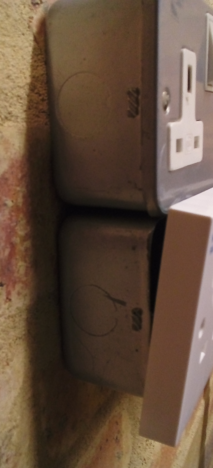

I need to make a confession here, having tripped the RCD in the house twice I swapped over the 2p isolator in the CU and the RCD in the house for convenience and it could have been me [but I don't know] who got the black a brown feed round the wrong way.
Customer states the white plastic fitting between the box & CU was another of the things done to sort the problem.

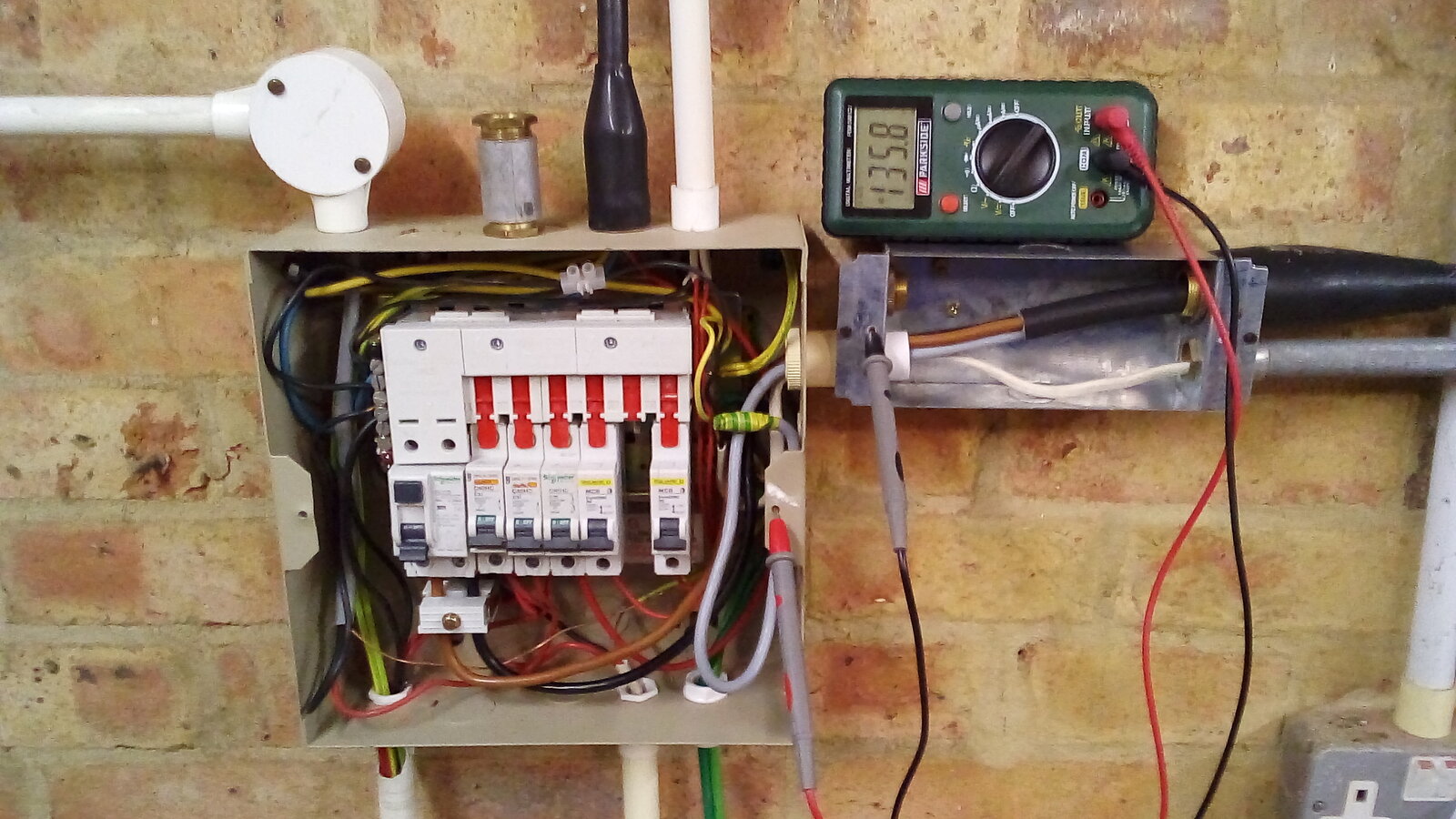

So this is where I've got to so far:
The T&E feeding the 2 sockets links the CPC with the backbox & conduit effectively bridging the gap between the box & CU, the SWA is the DNO earth and the CU is a TT earth, being the original P.O. telephone exchange earth it is a very effective TT earth - thats the lighter G/Y wire at the bottom, the water feed into the building is galv and bonded using the dark green wire. I didn't have decent test gear with me but the cheap meter indicates 1.6Ω between the wires [1.1Ω with probes shorted together]. So there seems to be a low resistance path between water pipe and TT earth.
DNO arrived within 20 minutes, did some quick tests and went to the sub, shortly after they shut off the sub.

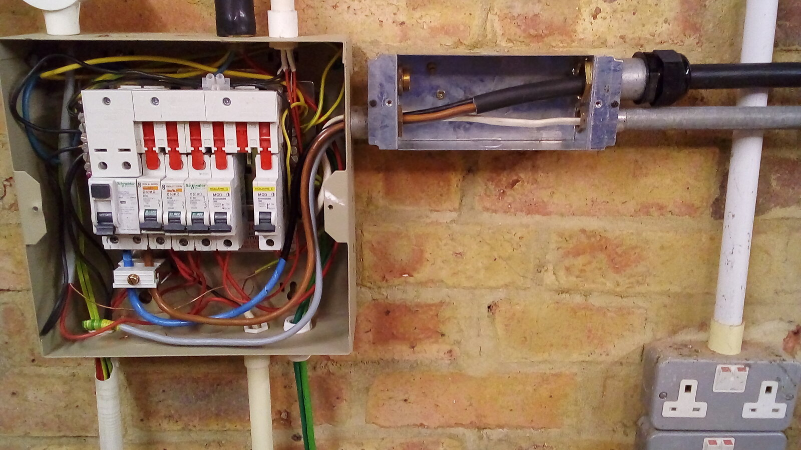

My moan takes the form of 2 questions:
Why do people insist on terminating the SWA into a silly add on box rather than the destination device?
and the second and more salient, When will people realise there is more than one way to terminate a SWA? They do not always have to have a brass gland and on this ocassion it created a dangerous situation.
My solution:
After removing the brass gland I put a few turns of a strand of 2.5mm² 7x round the armour to get it back snugg to the inner, covered with self amalgamating tape then heatshrink. that is inside the 32mm stuffing gland and coupler. I would have preferred to take it directly into the CU lower down but there was no slack anywhere. Even the original coupler between the box & CU had been left on top of the CU [as stated by customer] for me to refit.
I left at 01:30 but left the CU powered down as DNO had not restored power, going back later to finish off.
I have advised customer this building really needs upgrading [as have others before me], they seem keen to get to the bottom of the problem rather than just trusting it will dissappear with a rewire.

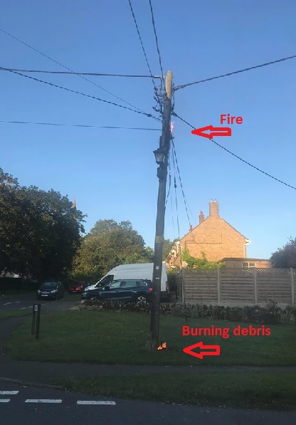

It was initially said that this fire was due to a fault in the telephone junction box, ? ? or was it a overloaded / defective Neutral to Ground electrode bonding cable. OpenReach and Western Power at the time denied responsibility. The burnt pole was removed before it could be properly looked at by independent eyes to see if there had been a bond cable.

Investigations revealed the blast was caused after a piece of cable was cut from an overhead line. This affected the earthing of the electrical network in the area and resulted in some unusual electrical activity, which affected some of the gas pipes within the properties. This resulted in the fires and explosion.
Yorkshire Post Saturday, 11th February 2012,
Initial fires were caused by overloaded Main Bonds to metal water mains,

Quite right, it may have been noticed all the breakers in the CU are off and aqequate testing for dead was performed.
Not importing the DNO's earth into the building would have removed so much danger, as would not exposing within the building. This would effectively negate any percieved requirement to use a device to disconnect anything.
Excuse the patchwork but a basic version of a nicer way to put this SWA in:
Woud have been just as easy to the right of the pic but 10% of the difficulty at the CU. Unthreading and rethreading those 16mm² wires innthat quite restricted gap by the earth bar was a PITA.
