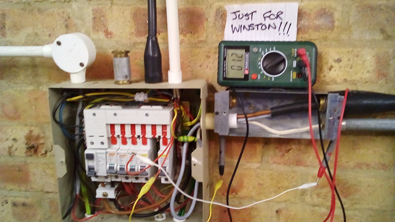

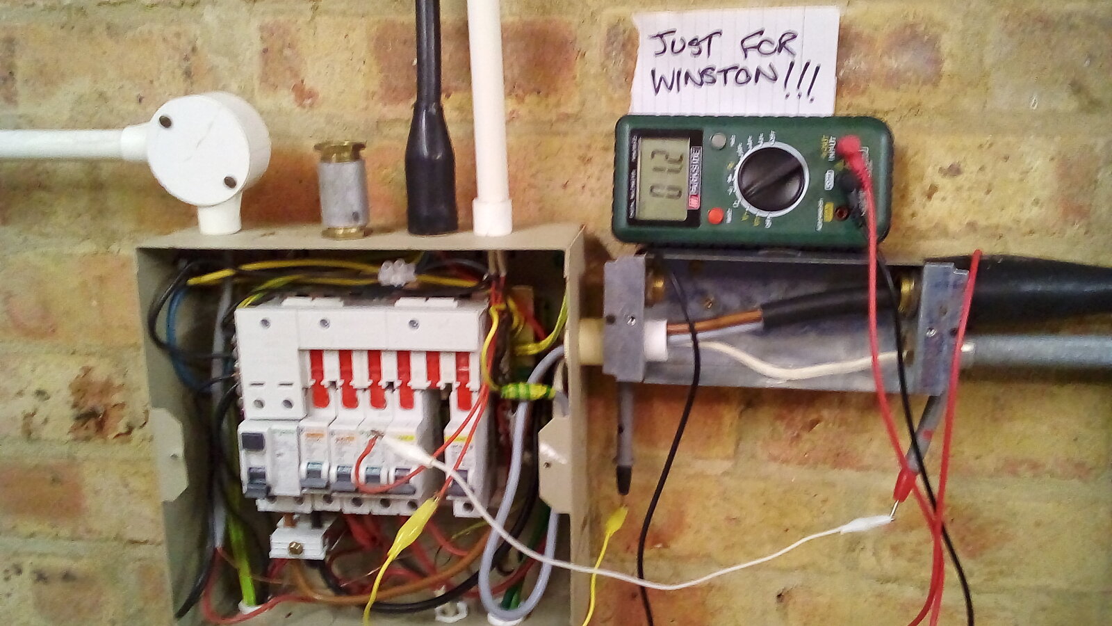

As I mentioned earlier there is an excellent log book for the building which the customer encourages the use of as a note book and there are several sets of dead tests showing ~0.35Ω of L & N end to end resistance and my first thought at 11pm on a callout in the cold and damp was Winstons repeated and incorrect bleating so I just had to do this:View attachment 203839
So once and for all will you PLEASE keep your factually incorrect and rude/arrogant statements to yourself.
I find it so sad that while dealing with potentially life threatening situations one of the first thing that goes through my head is the comment from a silly little know nothing.

I assume the supply is TN-C-S but the cupboard containing the Isolator, Henley block, earth bar and 4 sets of tails doesn't include the cut-out and meter which is a fair treck round the garden and not one I elected to do in the horrible weather.
I did manage to speak with the crew on site earlier this afternoon who have said there were no earth connexions in their network due to metal thefts. If that is correct it is just about possible [at a very big push] that the only earth feeding what I count as 5 or 6 farms and 4 houses was a length of 1mm² T&E. I will be replacing it with 2.5mm² singles and give it a decent inspection then.

Metal thieves at substations tend to go for the Neutral as the risk of fatal shock is much lower than if they went for a phase conductor,,
Could someone give me a one line summary of the fault.
Loss of supplier N ?
Did the polarity reversal have any Relevance?
Also please consider if someone put one hand on the cu and the other hand on the termination box, I guess they would get a belt across the chest
