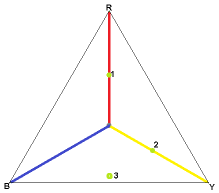

One has to remember this is a 3ph circuit even though there is only access to a 1/3 of it in the form of L&N and for our purposes lets assume we are using the red or brown phase. However if there is no stated reference point we can nominate one. This is usually the star point or N.
As an example:
Let's make some assumptions that all 3 phase voltages are 230V [called R, Y, B] and points 1 & 2 are 100V all referred to N.
Now lets make the reference at point 1 [let's not get into how or why] then N = 100v, red=130V, Yellow= 293V
Likewise
Use 2 as the reference at point [let's not get into how or why] N = 100v, red=293V, Yellow= 130V
Furthermore use Y as the reference point [let's not get into how or why] N = 230v, red=400V, Yellow= 0V
The reference point can be anywhere within the black triangle or even outside it if the loads are very reactive, for your calculations to be correct it would have to be directly antiphase with L, I've shown is as point 3 at 100v from N. Therefore N = 100v, red=330V, and if its of interest Yellow= 200.6V with resistive loads it could never exceed: N=115V, L=345V [& Y would be 200V] unless there is any additional stray voltage, bearing in mind this is derived from HV and could concievably be floating on 11KV
All voltages quoted are rounded to some extent.

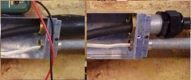

Personally I don't like the brass gland on the end of a SWA when its earth is different to the earth in use at the location, as has been so eloquently demonstrated on this installation it can and does cause problems.
My solution is an insulated gland with the armour being kept well out of harms way.
And yet again I'll ask why even bother with the additional effort and cost of an additional enclosure, why not just gland it directly into its final location?
This would have been so much easier and quicker and lets be honest tidier too.

The problem with a fault like this is knowing how much info to put in a post.
If I'd put everything in the OP it would have been stupidly long and most likely very confusing.
However, as is common, this thread has gone a long way away from the salient points I was highlighting, namely:
The silly practices of insisting on using a brass gland when it must be obvious it is not required, and
The even sillier practice of unnecessarily making the installation more difficult by adding a superfluous box.
On this ocassion the inclusion of both could have caused serious injury to the customer, or my bigger concern to me.

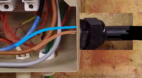

Noticed the Black core is Neutral, fairly common in the early days, luckily taped Blue as can easily catch you out if ever reconnecting.

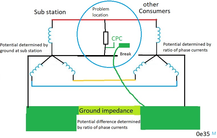

This is what I think is the situation. The Neutral from the substation extends into the area where the ground potential is being pulled by the star point potential to be different from the ground potential that the sub station Neutral is connected to.
The loads at the consumer's location are the totals of several consumers and are not equal to each other.
