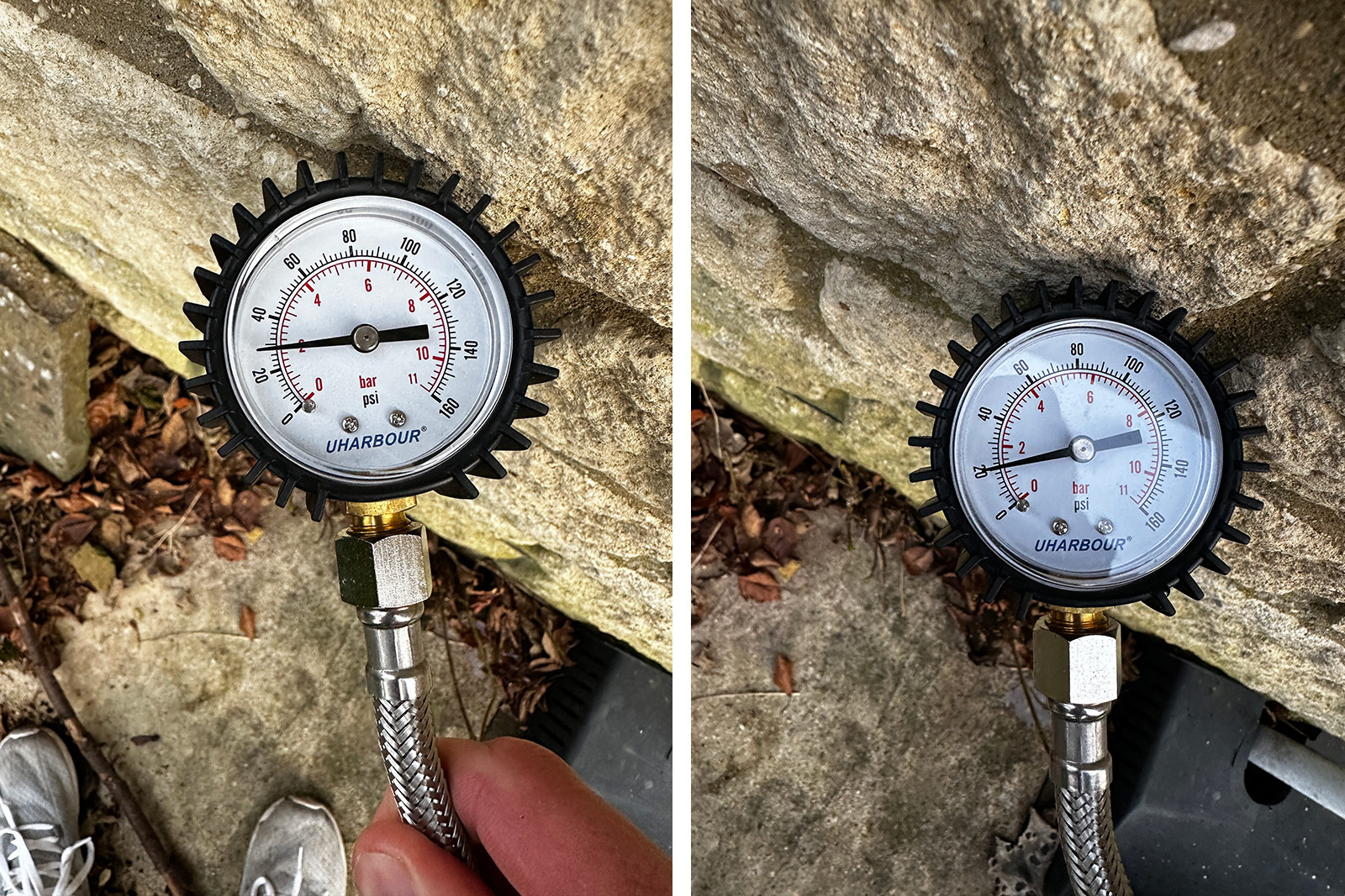

@Madrab I brought my own pressure gauge. It's 2.0 static and when I turn on the kitchen tap fully it's 1.4 - I guess this is the dynamic pressure?
Is that good or bad or somewhere in between :)

It's terrible because it shows that the water board are only providing a 2bar supply at their end, you might normally expect 4 to 6bar IMO.

It is a dynamic figure, yes and unfortunately it's not the best, where is you location roughly? What happens to that figure when you open up another 2 mains outlets?
I think you said the kitchen tap flows 10.0LPM, the pressure drop is, 2-1.4, 0.6bar, if you wanted 20LPM then the pressure drop will be 2.4bar, if you require say 3 bar dynamic pressure d/stairs at this flowrate then the water board would have to give you a dynamic pressure (at their end) of 5.4bar.
If you settled for 2.5bar dynamic d/stairs at 20LPM then the supply needs to be 4.9bar say 5.0bar.
If you were happy with 15LPM at 3 bar d/stairs then the dynamic supply pressure needs to be 4.35bar, if you settle for 2.5bar dynamic d/stairs at 15LPM then a dynamic mains pressure of 3.85bar will suffice.
OK so I have opened 3 mains outlets, 2 x outside taps and 1 kitchen tap. *The pressure gauge is on one of the outside taps.
It goes down further, to 1 Bar when all 3 are open.

OK - 1 bar isn't the end of the world and will be more a 'true' dynamic figure especially given that would be closer to the high end use. Hopefully you did a flow test on one of those outlets and just didn't detail it? That would then give us the same 'true' dynamic flow rate and will give an answer to this

I don't think we quite got 3 outlets running with the gauge on the 4th but I think the 1 bar dynamic is indicative of where the mains is going as far as worst case dynamic figures are concerned. We have gone from 2bar static to 1.4 w. 1open > 1 bar w. 2 open then I would suspect there would probably be a further drop with 3 open. With the external mains @ 2 bar dynamic though then that would suggest to me the supply pipe to the property could be the bottleneck
