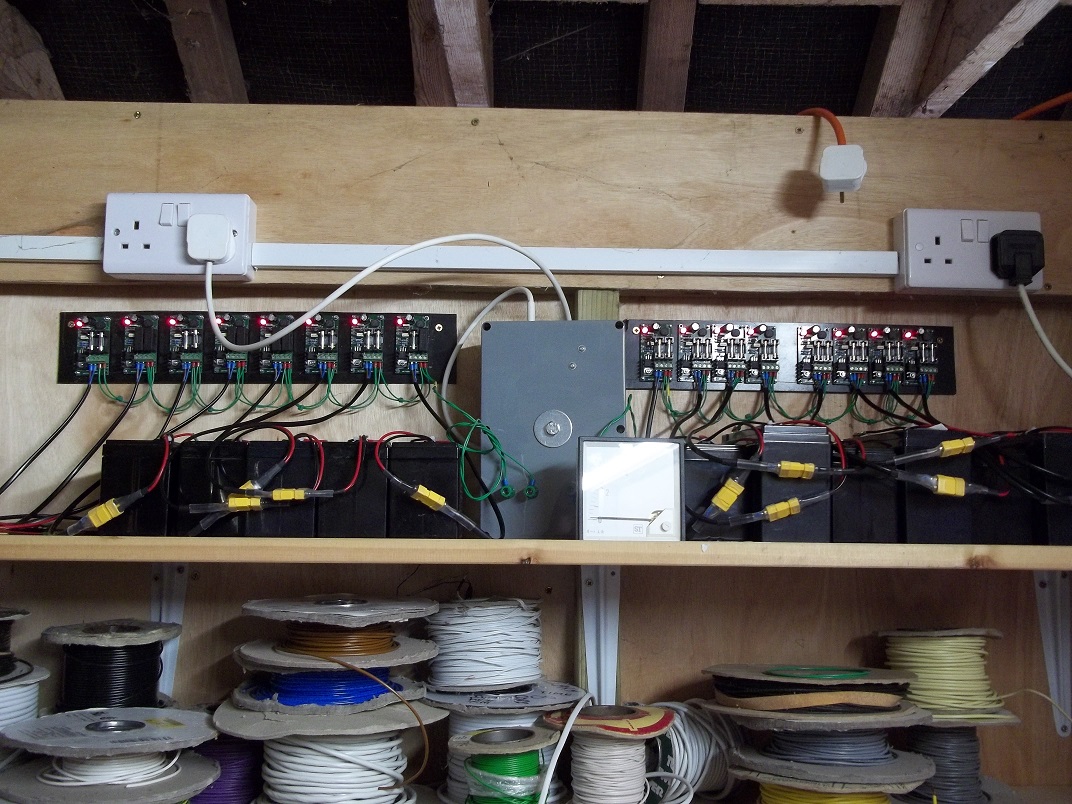

I have a few sealed Lead Acid batteries some of which are 8 years old and still have more than 80% ( estimated ) of their rated capacity.
They are kept on float charge at 13.8 Volts ready for when ever they are needed. Most frequent use is for temporary event lighting.
