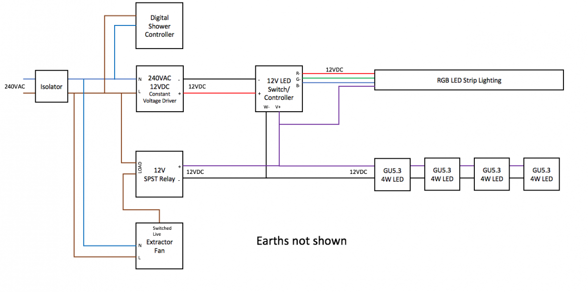

Hi,
I'm doing a lighting project and I'm mixing some LED strip lighting with some LED spots (GU5.3).
When I've like-for-like replaced other 12V halogen spots for LED spots in the house I've just swapped the bulbs directly keeping the existing AC transformers. Presumably these 'bulbs' have a built-in rectifier that allows them to run properly from an AC source?
Question is, for the new project, I have a 12VDC (100W) constant voltage driver which is driving the LED strip lighting and the lighting controller, will the same GU5.3 spots run correctly (and safely) from the 12VDC source?
One more question - I also want to drive the switched-live line of a timed extractor fan from the same 12VDC circuit - can I put a 12V SPST coil relay on this line driven from the 12V output from the controller?
Anything to watch out for?
Thanks!
Essentially this:
Depending on what W- and V+ are that plan should work. Make sure the relay has at least 500 volt isolation between coil and contacts. Do NOT use a 12 volt relay intended for use in a vehicle.

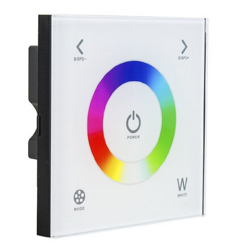

Well, honestly, that's where the experimentation is going to come in. According to the LED controller specifications, the controller has a single +12VDC (V+) terminal, then the R- G- B- negative terminals are PWM dimmed to allow colour mixing for the strip light. It then also has a switched -12VDC terminal designated for white lights (W-). Whether or not that is suitable to drive GU5.3 spots and a relay is the real question here.
I intend to rig this all up on a bench before installing anything. This is what the controller looks like for reference. The Power button should turn everything on/off (inc the extractor) the colour wheel works the RGB outputs and the 'W' button switches the white output. Fits on a standard dry-wall box.

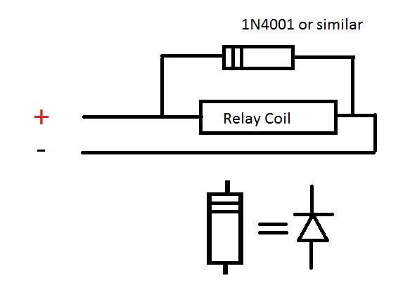

A diode? Excuse my naivety but I'm not sure I've ever seen a diode used for this purpose, which orientation should it be in?
'Reverse orientation' - i.e. so that it only conducts if/when the polarity of the potential difference across it is opposite to the polarity of the potential difference across the relay coil when it is energised.

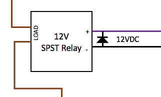

Thanks John.
Like this?
What type of diode? Zenner, voltage suppression...
