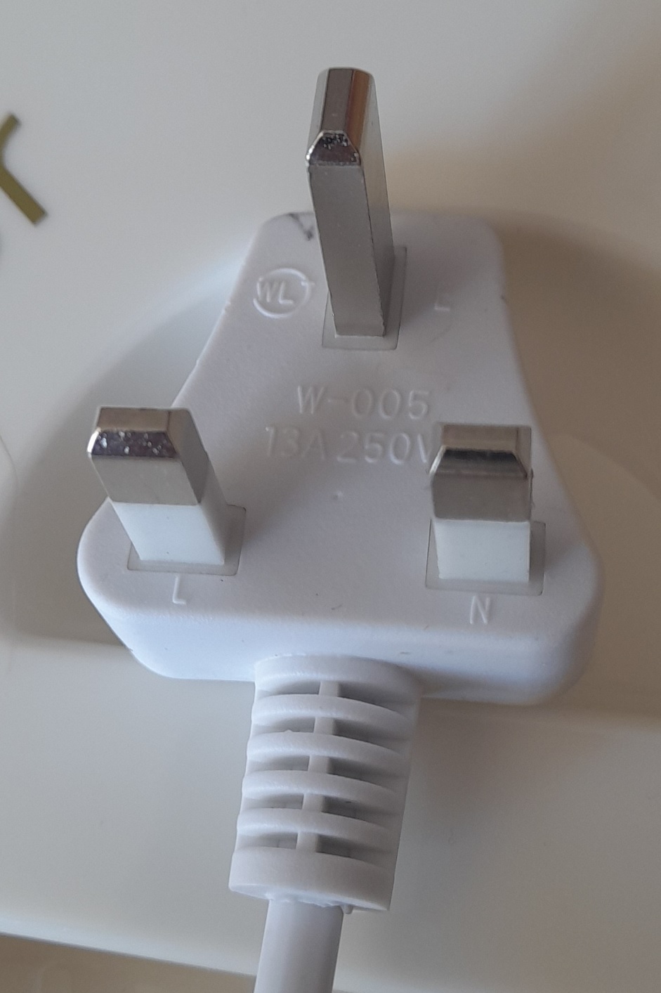

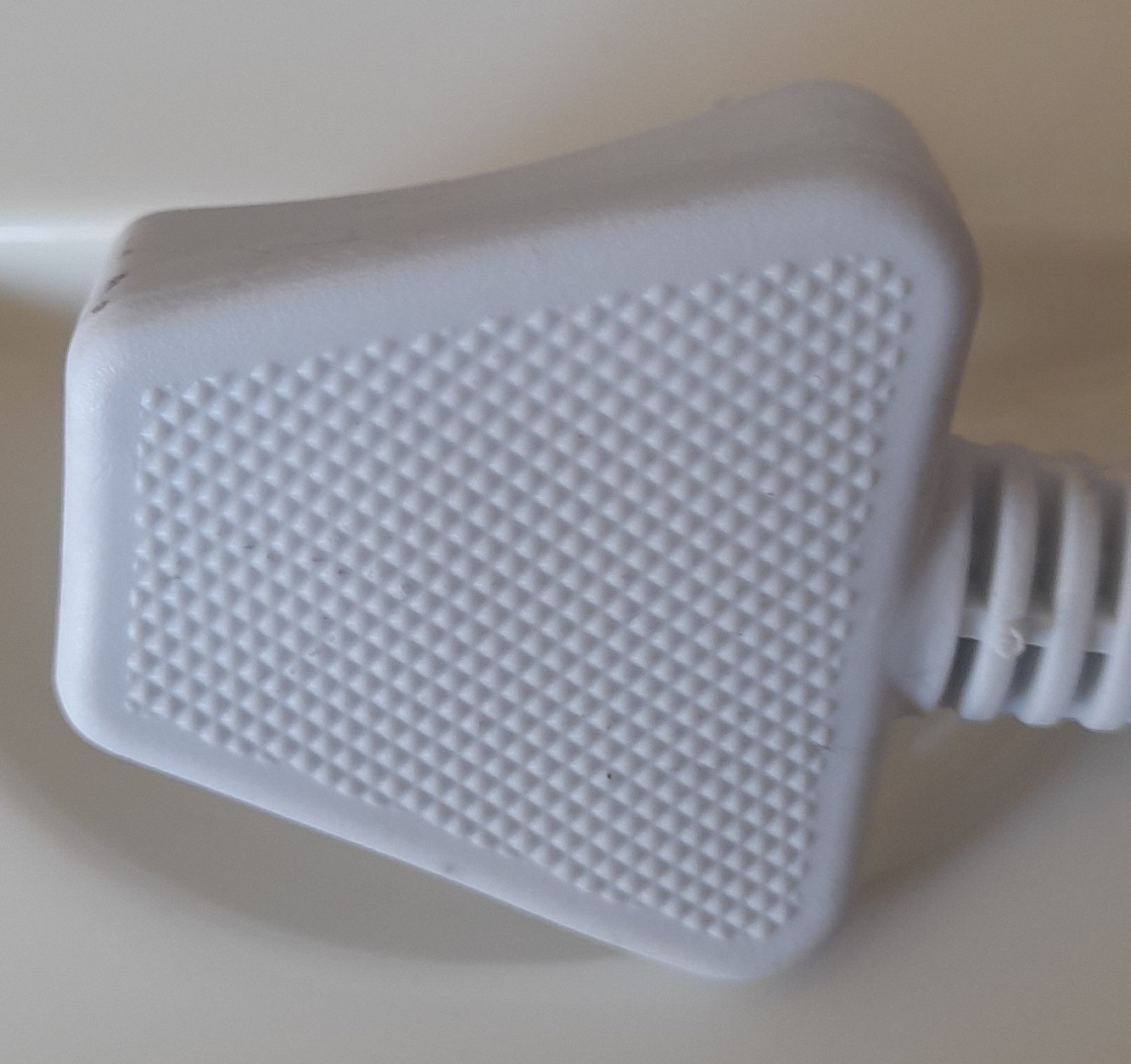

Plug1.jpgPlug2.jpg No sign of a fuse, although instructions say there is one in the appliance, and thought had to cover more area? But it was a freebie, Temu, I think. "The distance from any part of the line and neutral pins to the periphery of the plug base must be not less than 9.5 mm." I measure 4.3 mm. It has no BS marking, the plug in the main rings alarm bells for the rest, but since a gift, not sure if I can do anything. Specially and not upset wife.

Personally I would cut it off and fit my own - rather be safe then a fire

I think I will decide if the fruit dryer is worth having first, may put the lot in the bin. If she had bought it, it could be returned, not sure when items given away though. But the plug is so clearly out of spec, at least everything is RCD protected.
which one do you have - the reviews are not good - and if she left plugged in, even though on RCD - what else will trip , when you are out ... reviews talk of melting trays

In my experience the wiring will also be very suspect , likely so small you will struggle to fit a plug to it .

2 options
1. cut off plug and replace with one with an appropriately sized fuse
2. return product and get a full refund
Either way you need to inform the seller that the product is dangerous
Replacing the plug does have a minimal risk that the "plug" supplied contains a PSU ( power supply unit ) or other electronic components to power an item with a voltage that is not 230 Volt

This has been my experience as well. Very likely the whole product is not fit for sale in the UK or EU, all too common with the likes of Temu, Aliexpress and similar.

If it was a business, need to tell them they've broken multiple laws - and they need to recall any others they've given away. If a family member or friend, I'd suggest they need to send it back and report the seller.
I took that as someone bought it from Temu, but I see now - a freeby from Temu.
They need telling it's dangerous junk - though I suspect they have a filter for that straight into the bit bucket.
