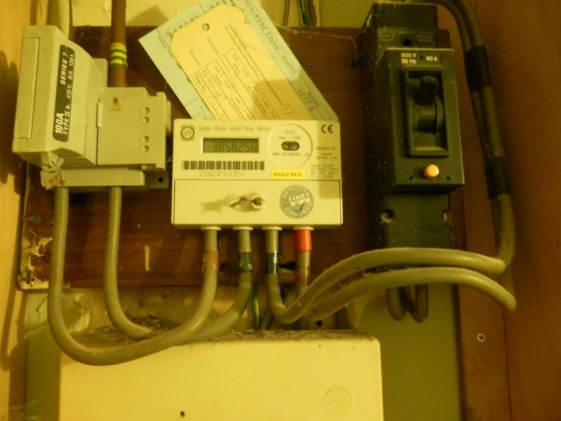

I spoke with Npower and another electrician today, Npower will be fitting a Isolator Switch later this month, but the sparky I spoke to said as I have a switch next to the 100amp fuse that kills the power I do not need another one. ... Will post a picture so you guys can see but im starting to get confused on what I do and do not need.
I'm a bit confused, too - as you suggest, I think we need to see a picture of this "switch next to the 100A fuse" to understand what is being said!
Kind Regards, John

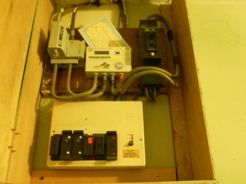

Hopefully someone may be able to tell me if I do indeed need an isolation switch fitted or if what is there is in fact ok.
Ooooh - I think we may have some problems here. I think that black 'switch' is probably a voltage-operated earth-leakage circuit breaker (a very old predecessor of an RCD). If so, it needs to go, and probably to be replaced with an RCD. Did your 'electrician' not comment on that - or did he think it is just a switch? Does your electrical installation have an 'earth rod' outside?
I also fear that your (equally old) consumer unit may well not be suitable for a 40A/45A MCB. Rather than needing a separate additional CU for the cooker, it could be that you need a new (single!) CU for everything, including the cooker.
I'll be interested to hear what others have to say.
Kind Regards, John
We will be getting a brand new consumer unit john, we would never keep that old thing.
Yes the earth is staked outside, but we are running 2 10mm earth cables in for that.
That old voltage-operated earth leakage circuit breaker will definitely do duty as an isolator. But you'll only need an isolator once the CU is replaced, so if Npower are going to fit a new one for free, then go for it - you don't want the old breaker going wrong.
He wants to replace my current 6 way consumer unit for a 21 way consumer unit, but im only adding 7 more circuits
Bear in mind that some people count the total number of positions in a CU, not just the ones with MCBs in, so if the CU has a main switch and 2 RCDs then it would be left with 15 ways for circuits. And 6 + 7 = 13, so depending on what your electrician means, a 21-way CU might not be overkill at all.
