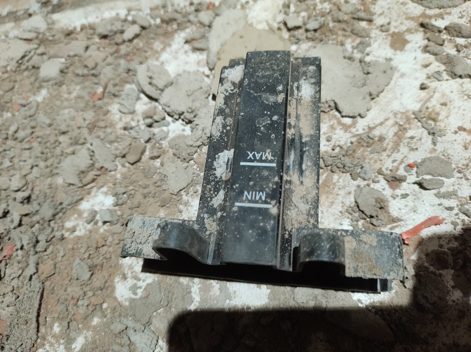

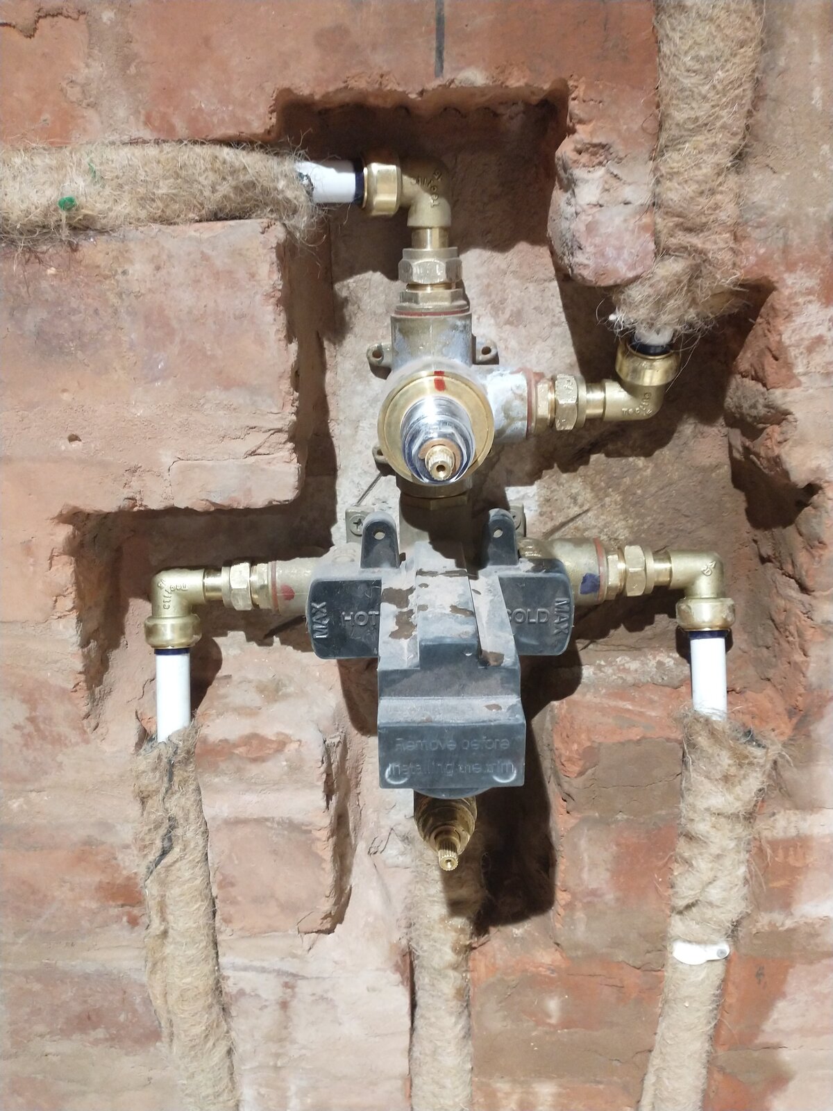

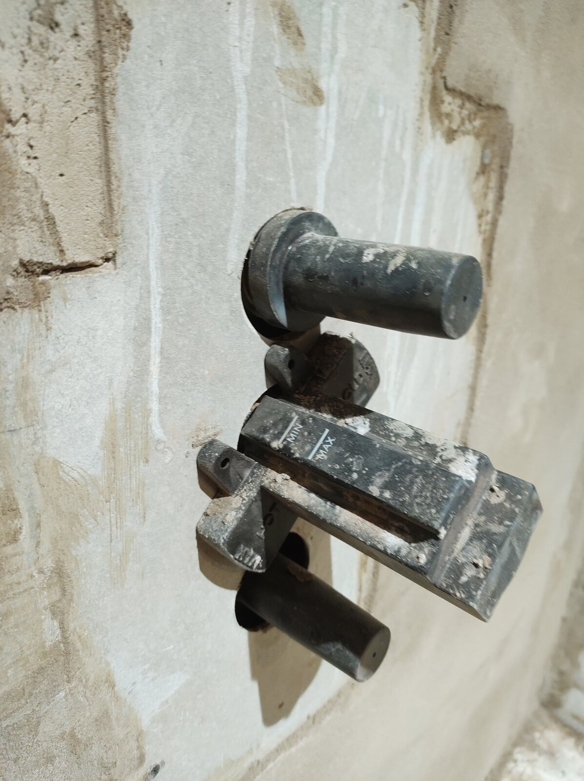

If a plumber is fitting then buy the valve and leave it to him, but you will need it sooner rather than later. If you're DIYing with limited plumbing skills then get it in place and pipe up to it. There's a limited range of how much or little it can stick out of the wall so you need an idea of the depth of the finish on the wall (plaster/tiles) and/or a bit of flexibility on the depth. The valve should have a couple of screw holes to screw it to something.
You'll want to get some hot and cold to it to pressure test it before you cover it up (not forgetting to connect up or isolate the outlets).
And don't use pushfit/compression fittings like me!
Why not? reliability issue?
Would you recommend copper/ solder instead?
People will tell you not to use compression/push fit in unaccessible areas as they are potentially less reliable. Unfortunately I have more confidence in them than my soldering skills. Worst case I'll keep a few spare tiles in case I need access.
