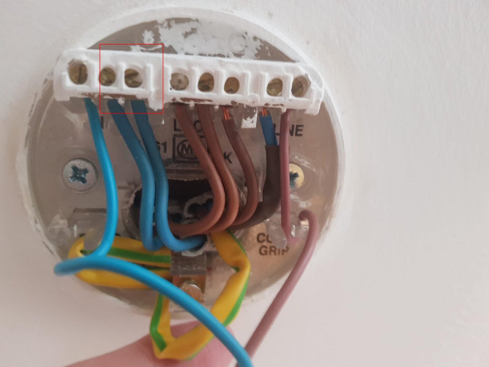

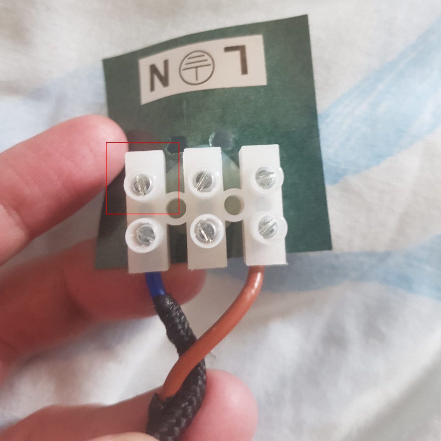

On the old fitting i have two neutral cables fit separately, on the new fitting I only have one fitting to plug them into.
Is it safe for me to plug the two separate neutral cables into the one neutral socket on the new light fitting?

you also have 3 lives - the 3 brown wires which will need to be connected up to a separate connector - NOT that light fitting one
you have a loop
Live and neutral wires coming in and then going out to the next light - hence the 2 neutrals
in addition to the 2 lives - you also have a 3rd wire which takes live to the switch and then comes back as a switched live - Blue wire with the brown sleeving to the separate connector - where the light itself is wired.
so the connector you have on the fitting will not work for all those wires

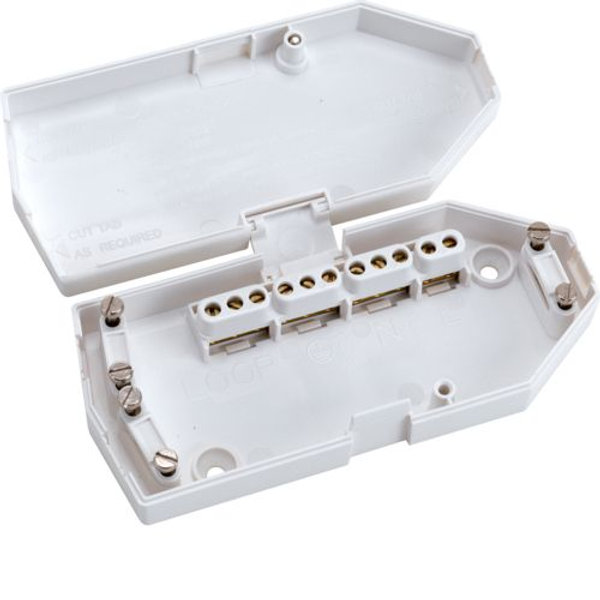

here is a picture of what you have
Yes ,you can put the 2 neutrals into the new terminal blocks neutral terminal. And you will need a fourth terminal block for the 3 brown to go into ,or a 3 way wago.
Does your new light fitting require earthing or is it a class 2 ?
Wondering why there is no earth conductor in the terminal block ?
Thanks for confirming that, just so i am on the same page, the two neutral cables I can screw into a single neutral block on the new connector?
