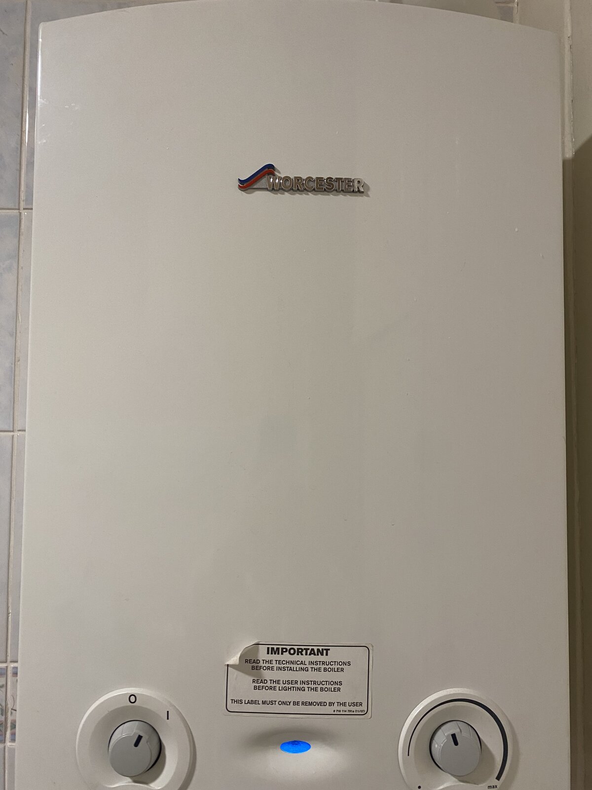

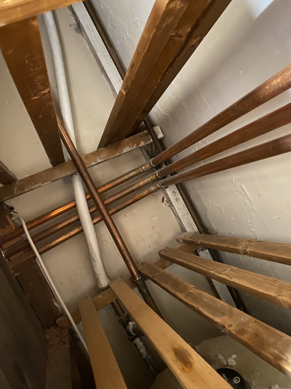

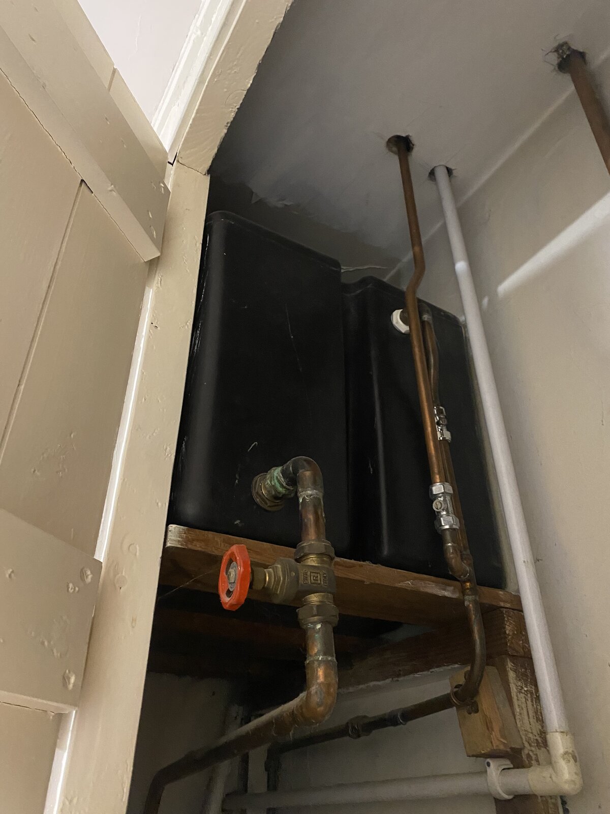

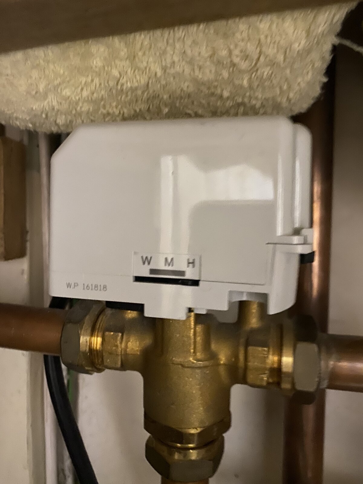

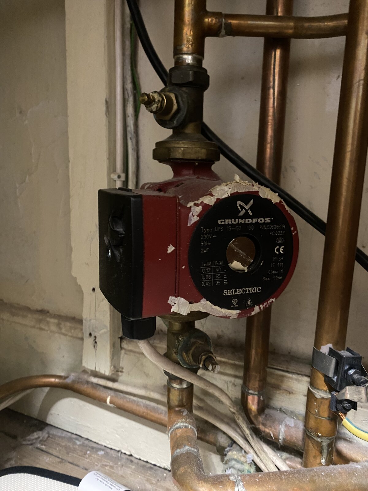

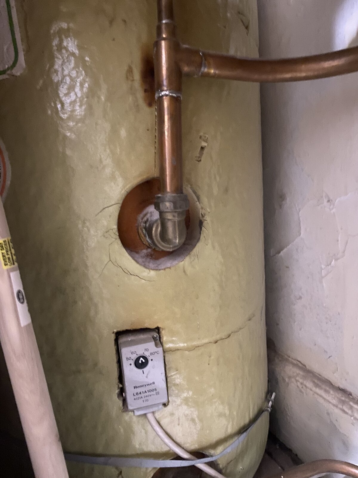

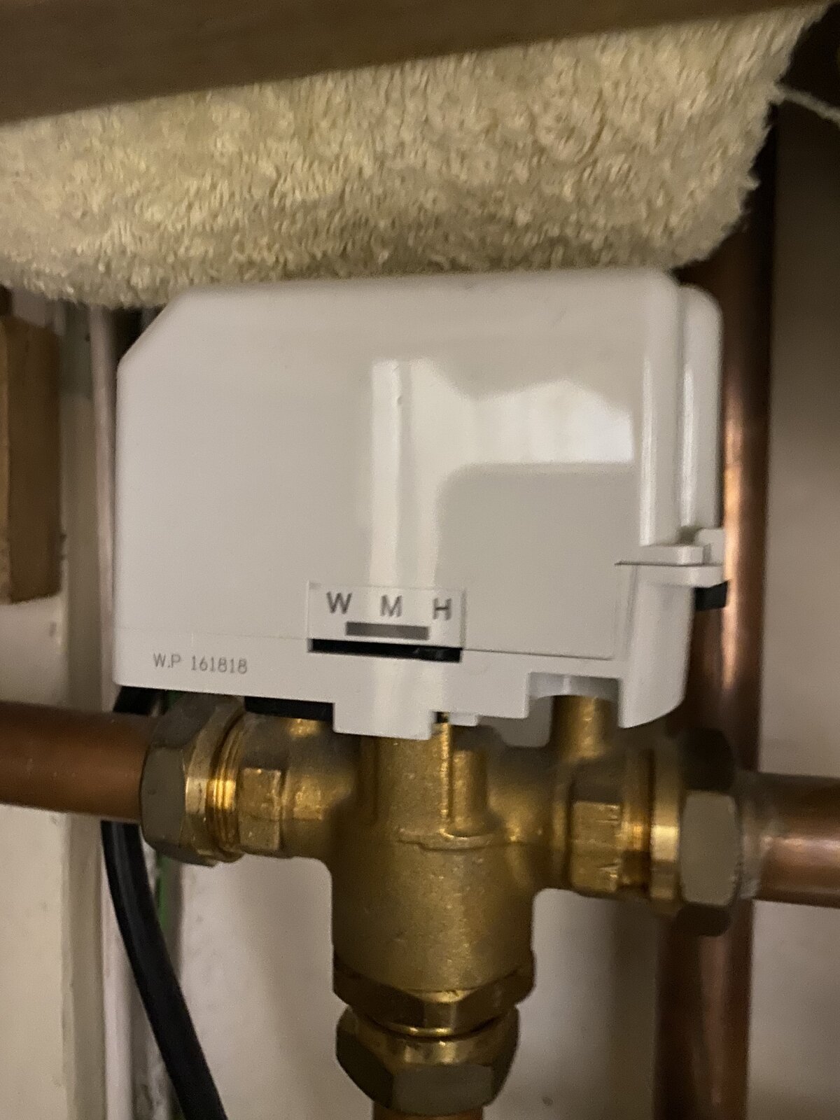

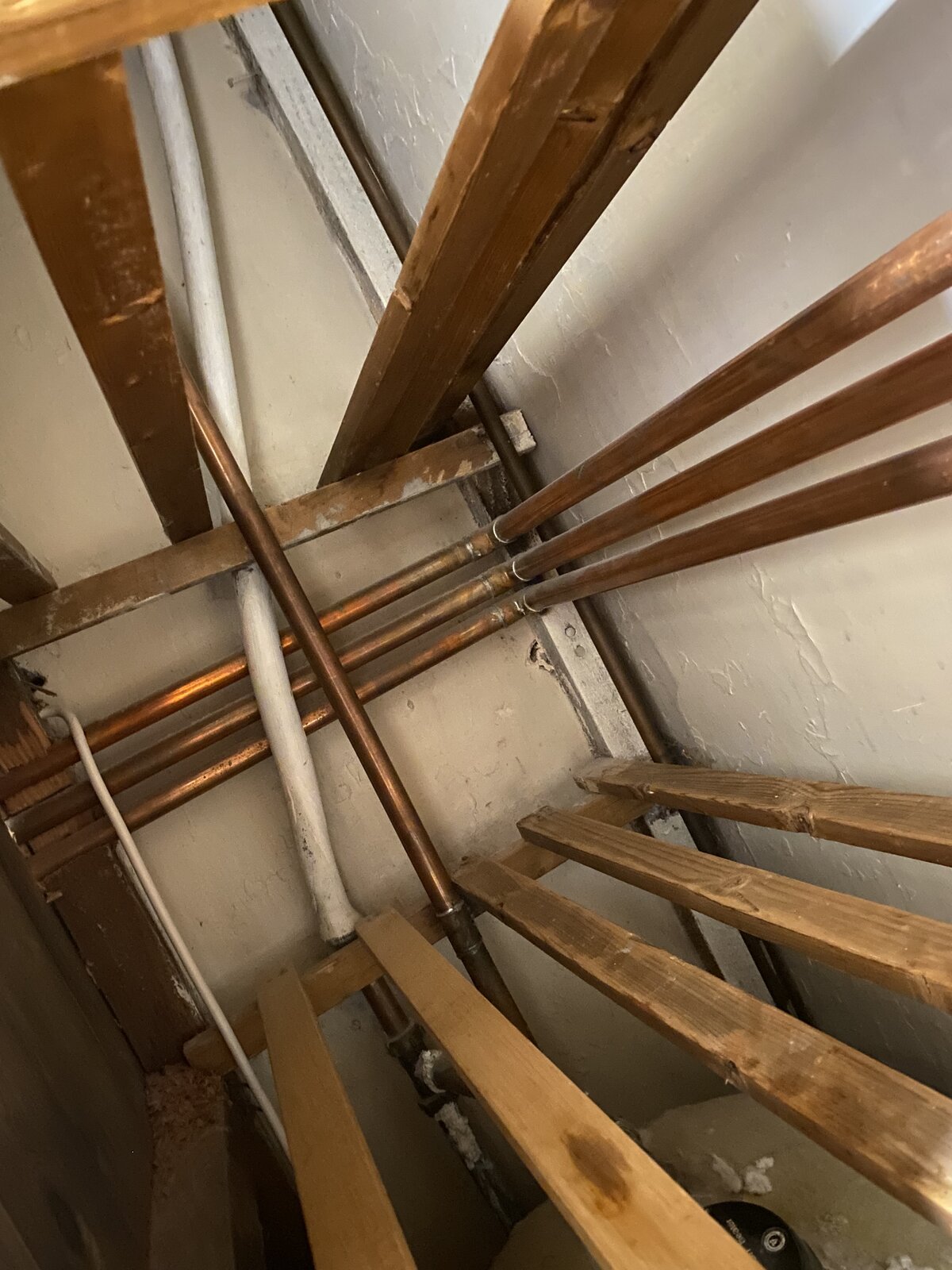

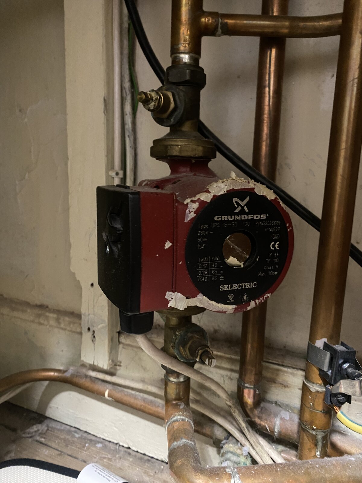

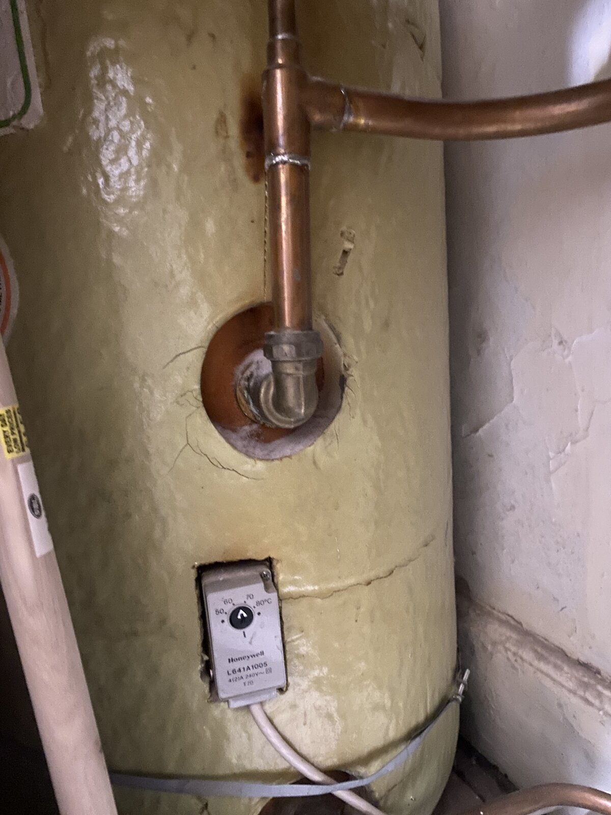

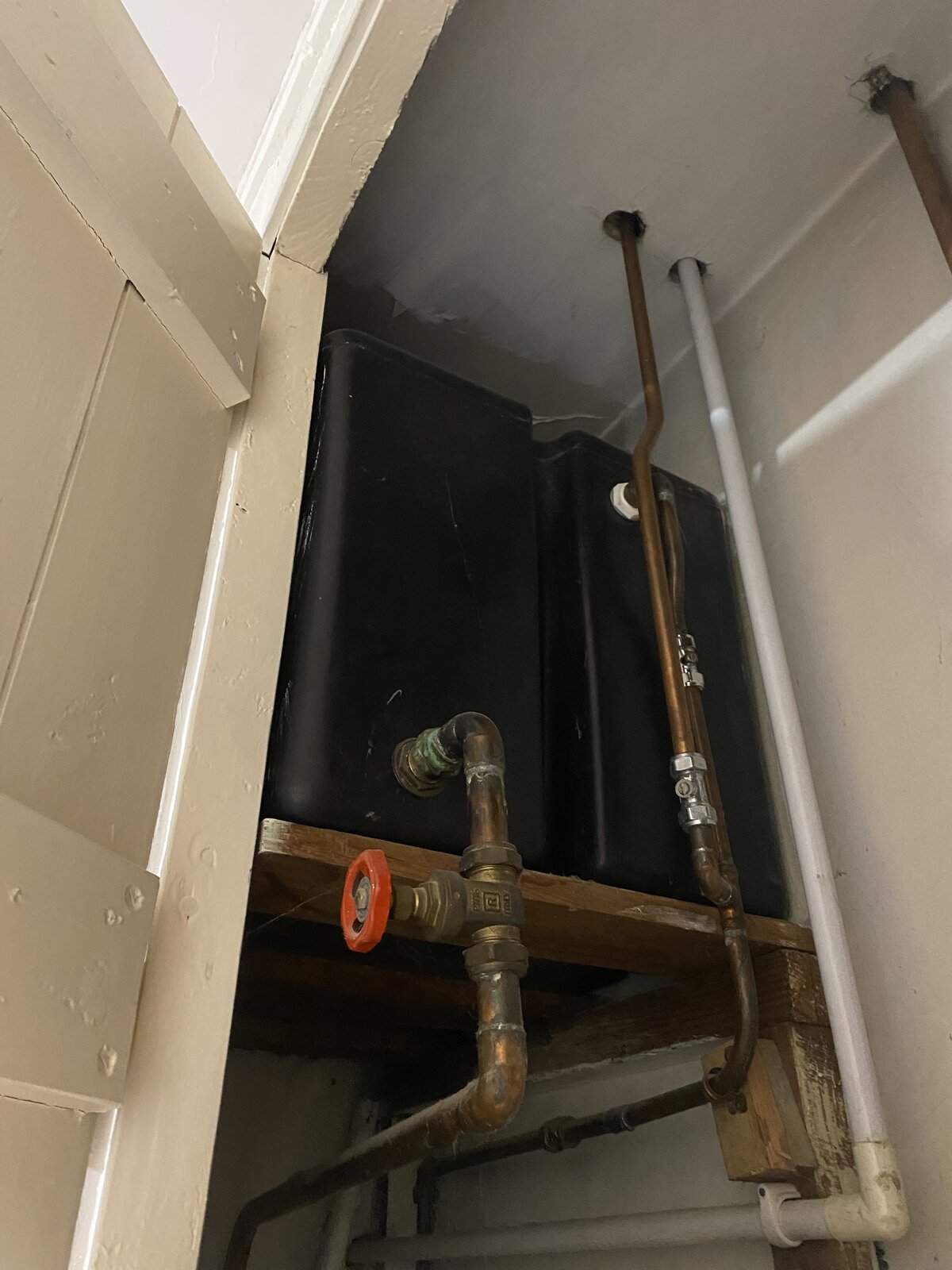

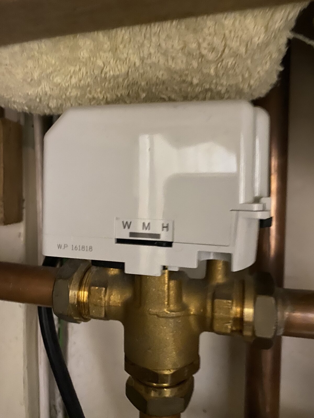

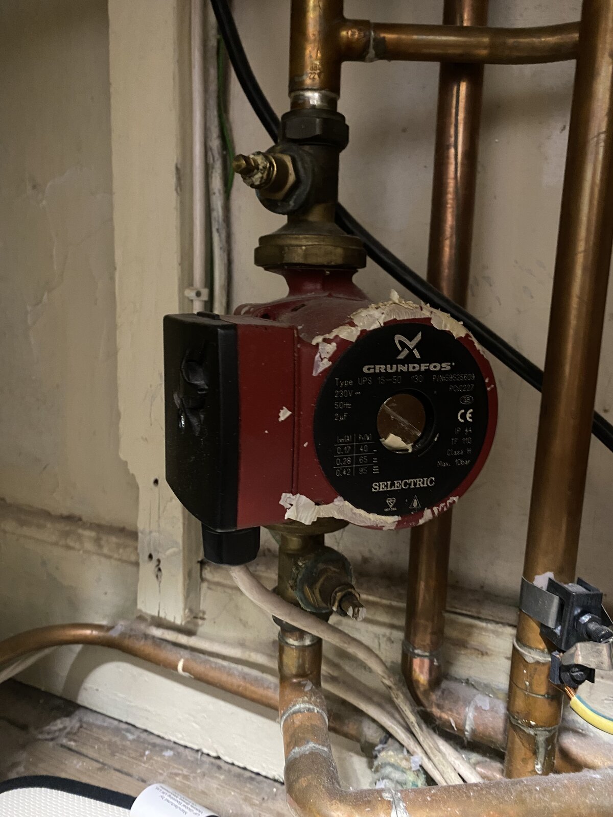

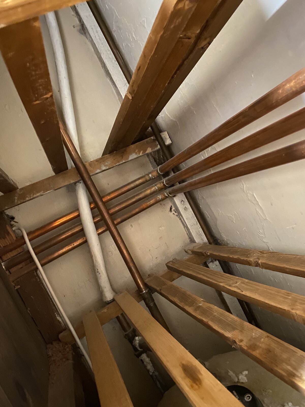

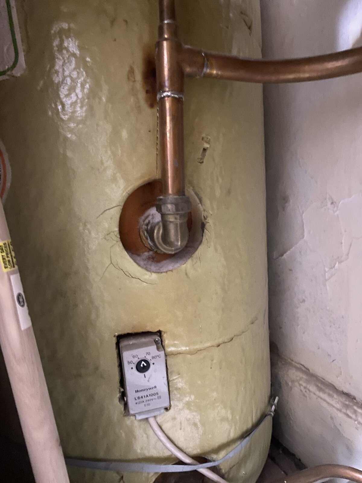

I know nothing about boilers , only some of my radiators working . 2 are Luke warm and one cold, others are hot. I thought it might be something to do with not enough water in them and a filling loop ? Not sure , I added some pics if anyone can help me

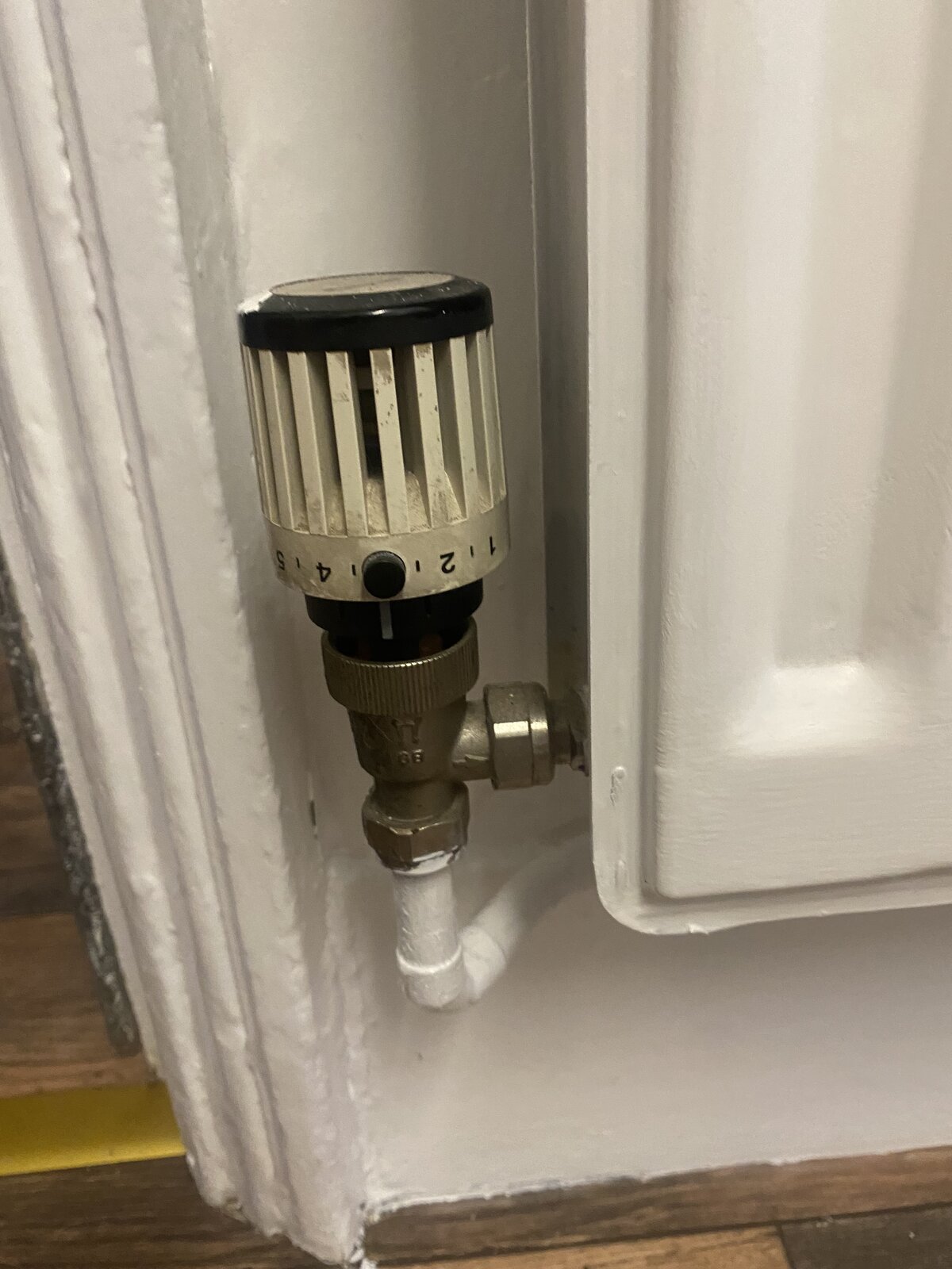

Have the rads that don't heat up ever worked well in the past ? Do they have thermostatic radiator valves ,they can stick closed and stop rad from heating ?
Have you bled the cold rad's of air ?

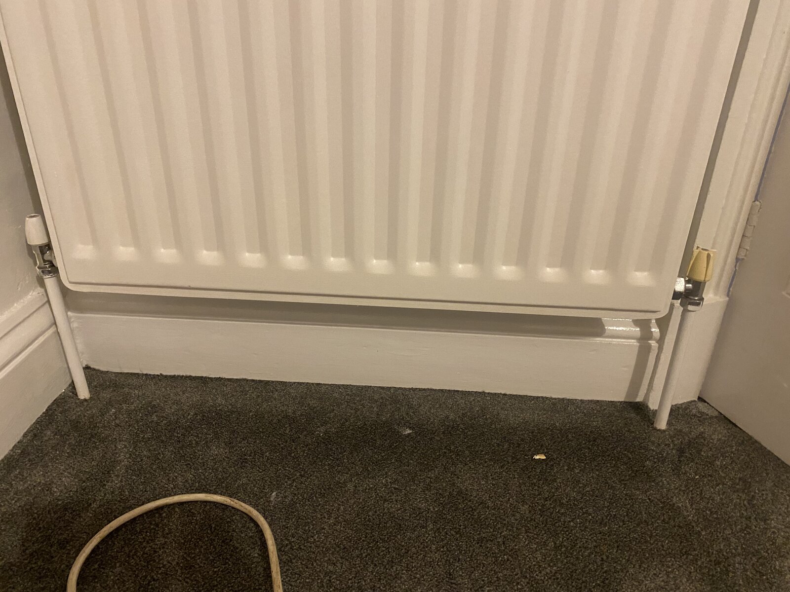

We only moved in a couple of months ago and this is the first time using. They have been bled.all rads have valves that seem to work apart from 1 radiator which just has the white knobs on. Can you tell from my photos if my rads top up water auto or do I have to do something ?

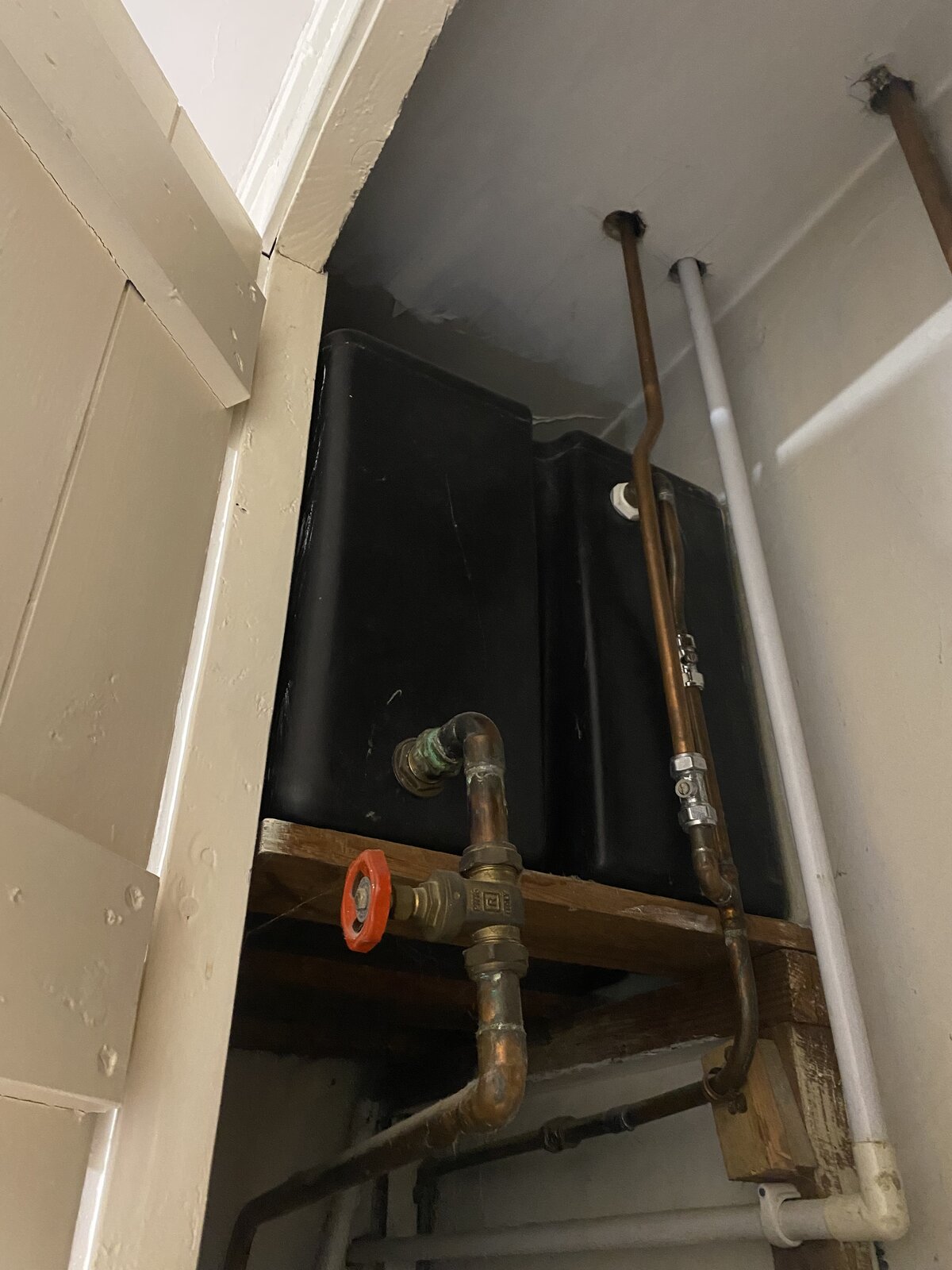

If water comes out of the bleed valve then the rad is obviously full of water. If you have a small tank in the loft, that will feed the rads. The large black tank in your pic appears to fill the hot water cylinder.

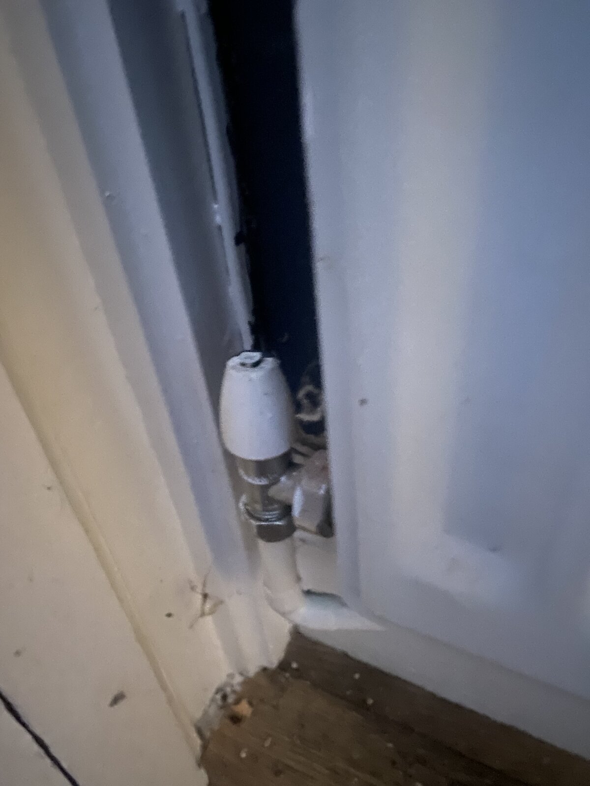

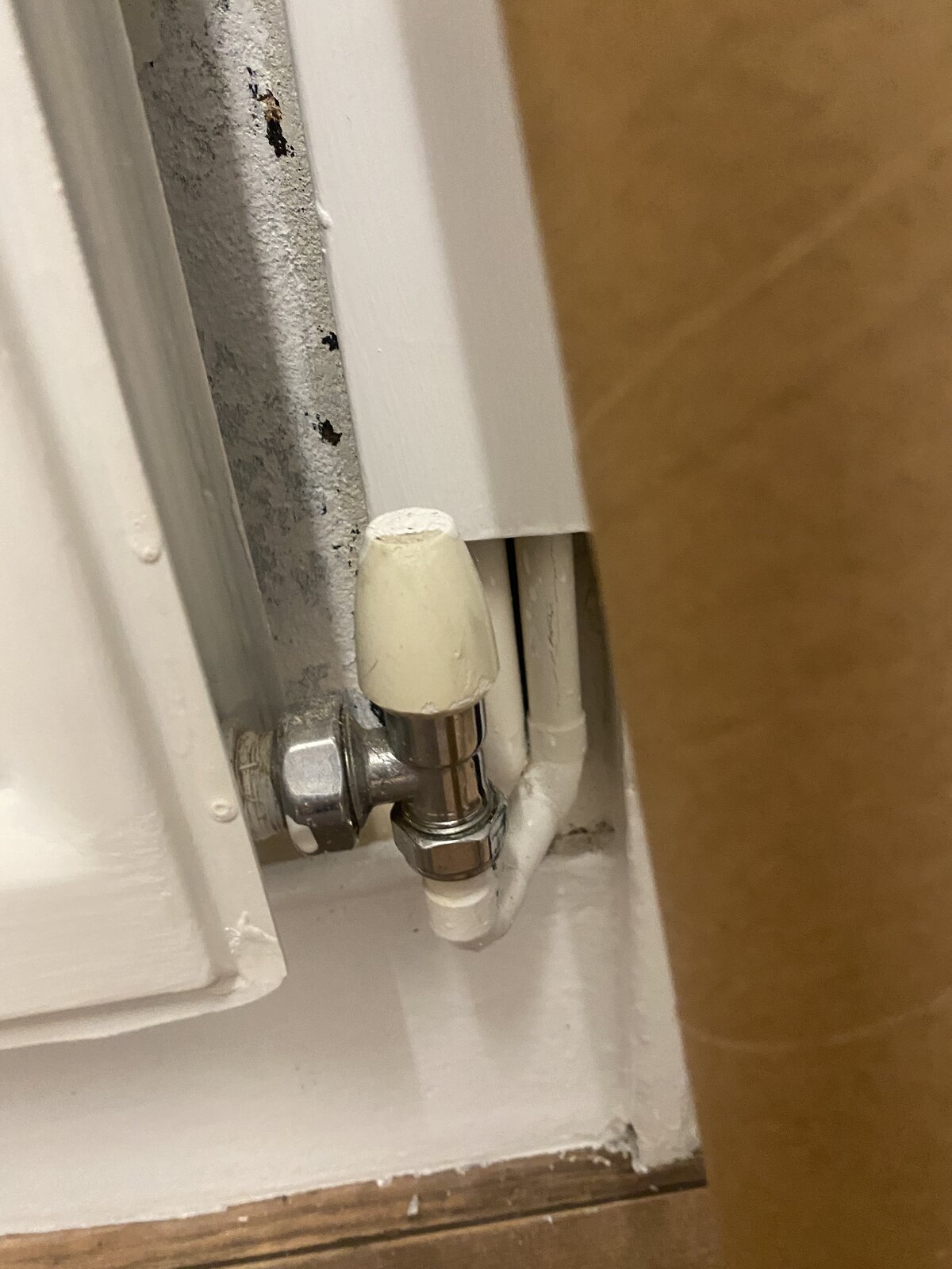

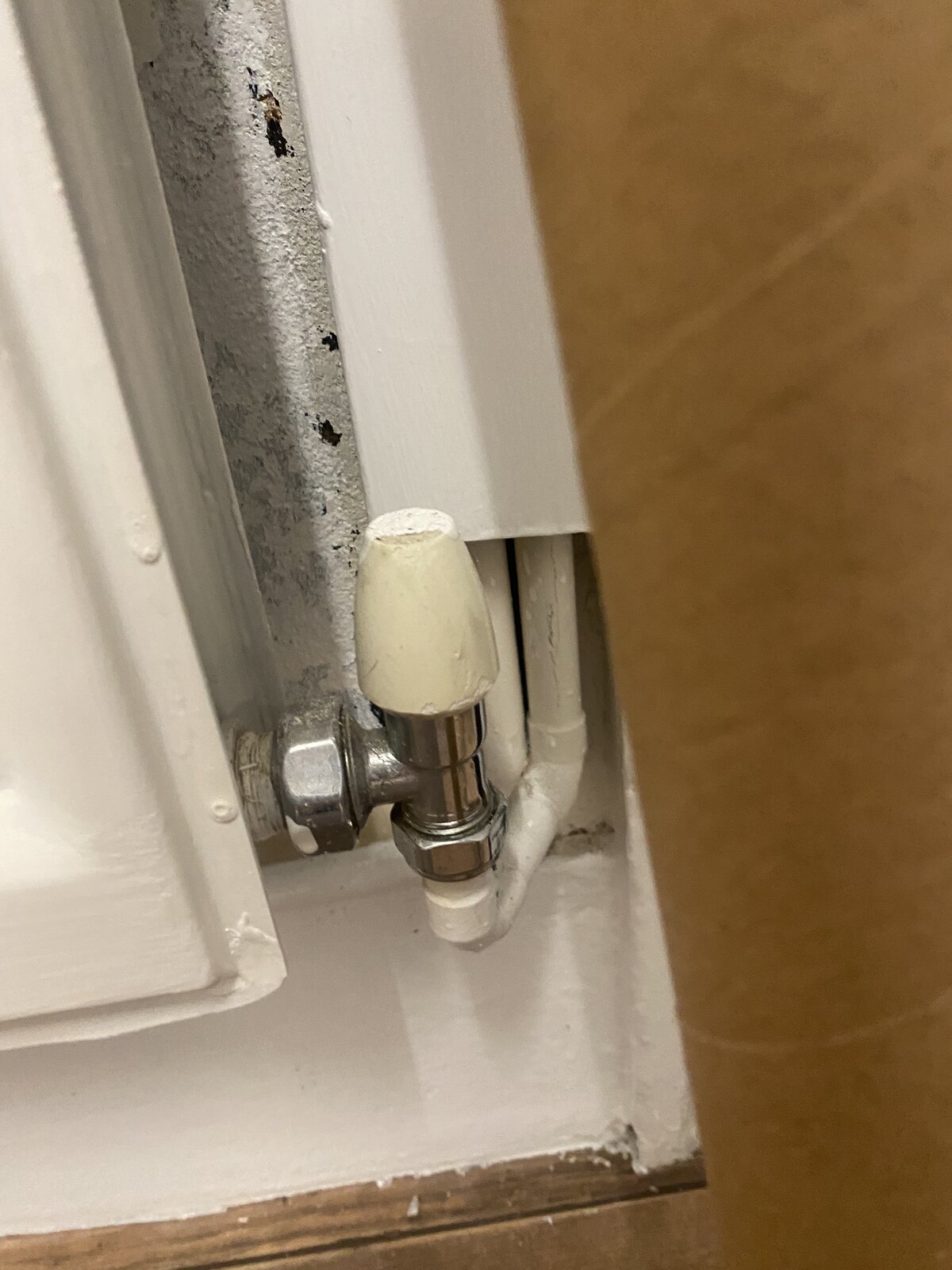

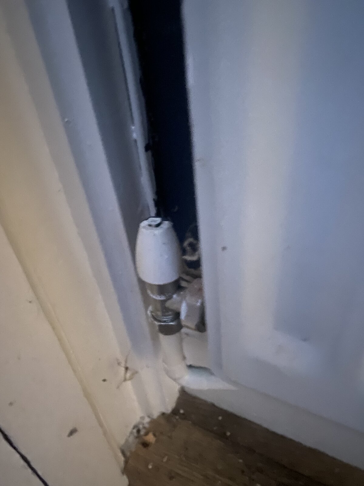

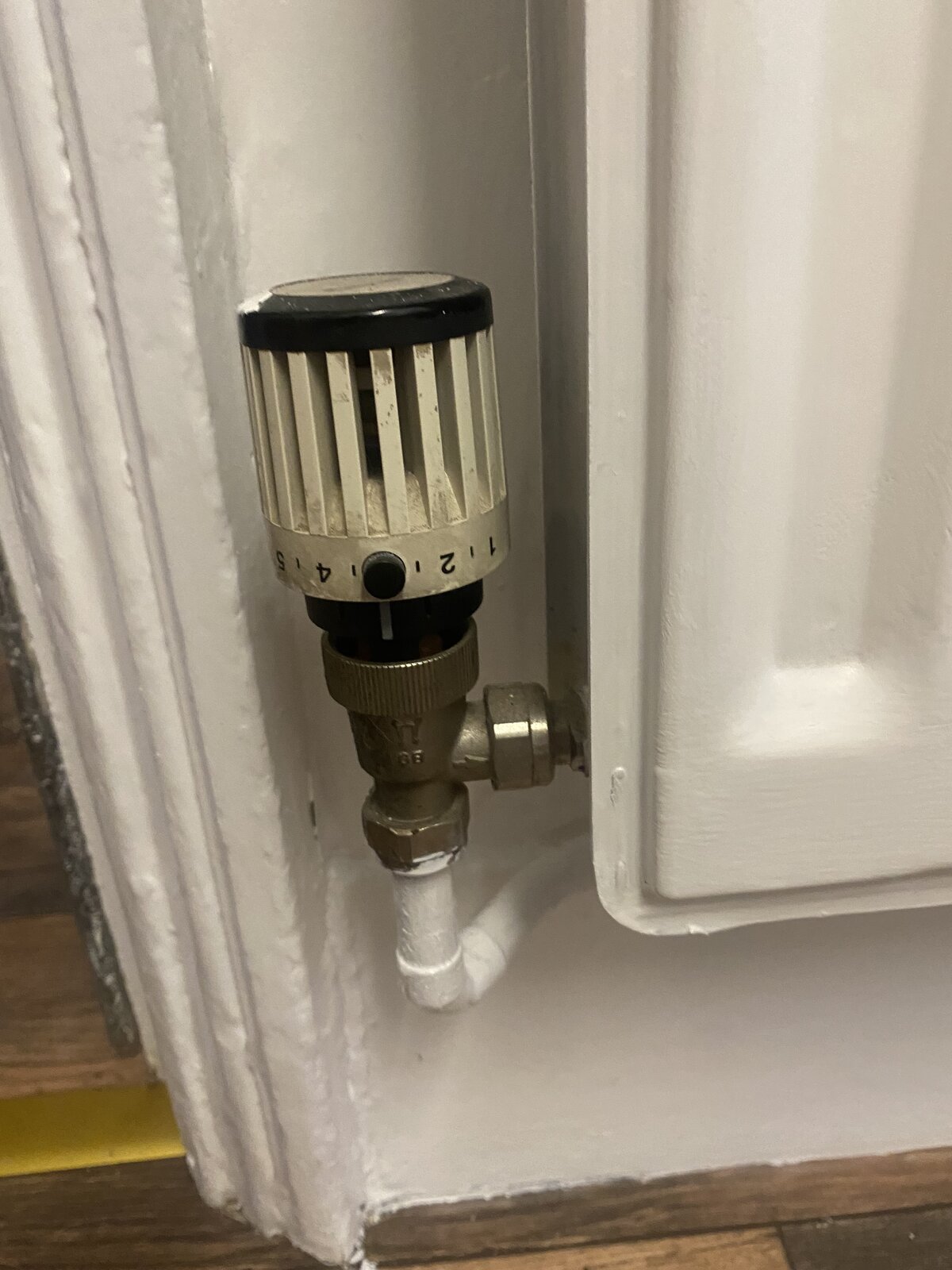

Show us a pic of the valves on rads that don't heat ,as well as those that do. If the rads that heat fully have a thermostatic radiator valve ( TRV) close them and see if cold rads now heat up.
Is it possible the ones which don’t work do not have enough water in them ,? And how do I fix that? I am not sure if you can tell from the photos previous which heating system I have ? Such as pressure,combi or conventional?

if air in system when you get it all out with the bleed valve. you may need to repressurise the system - was you shown how to do that

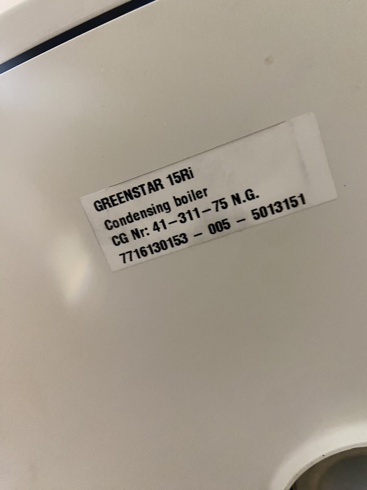

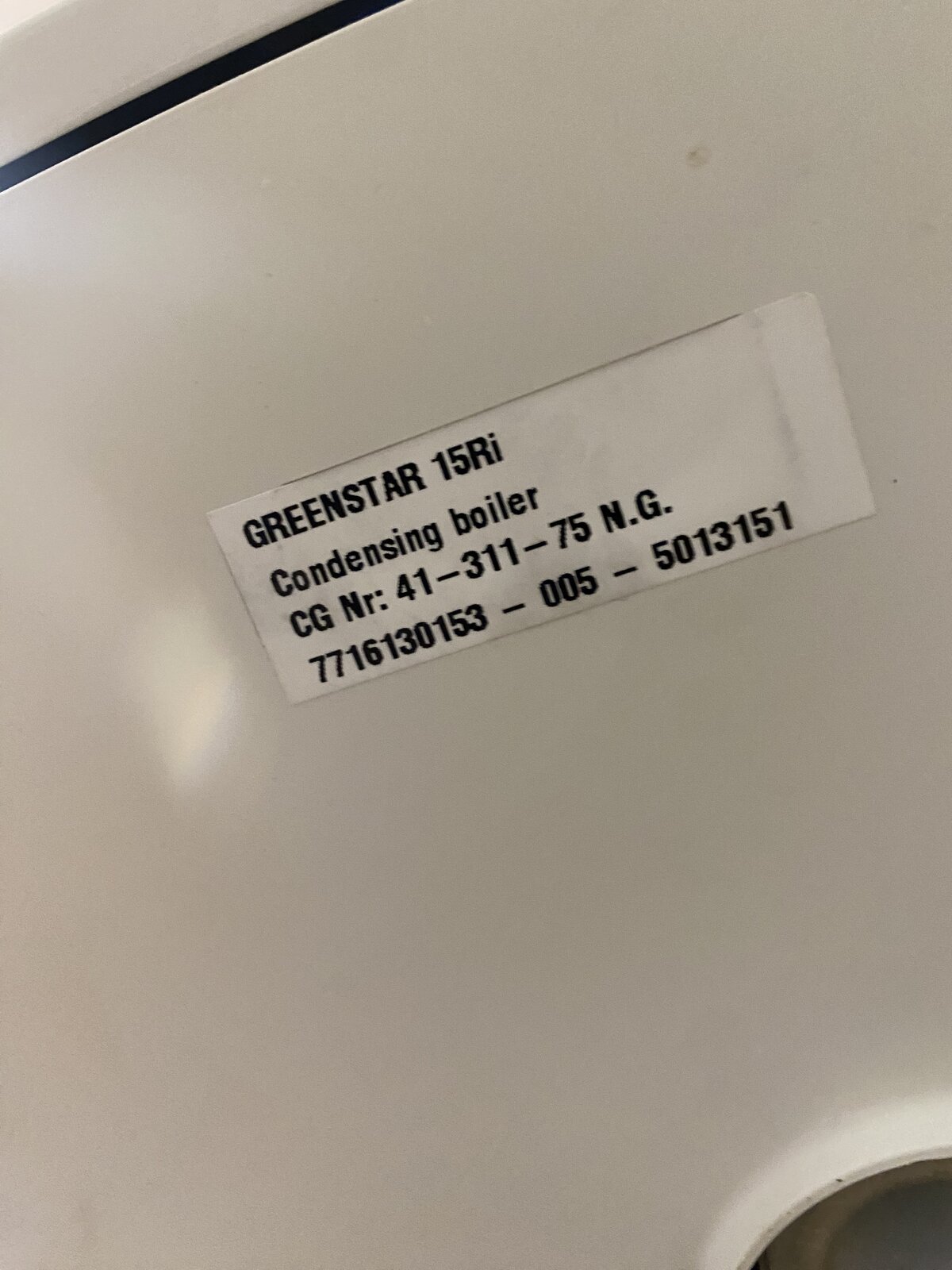

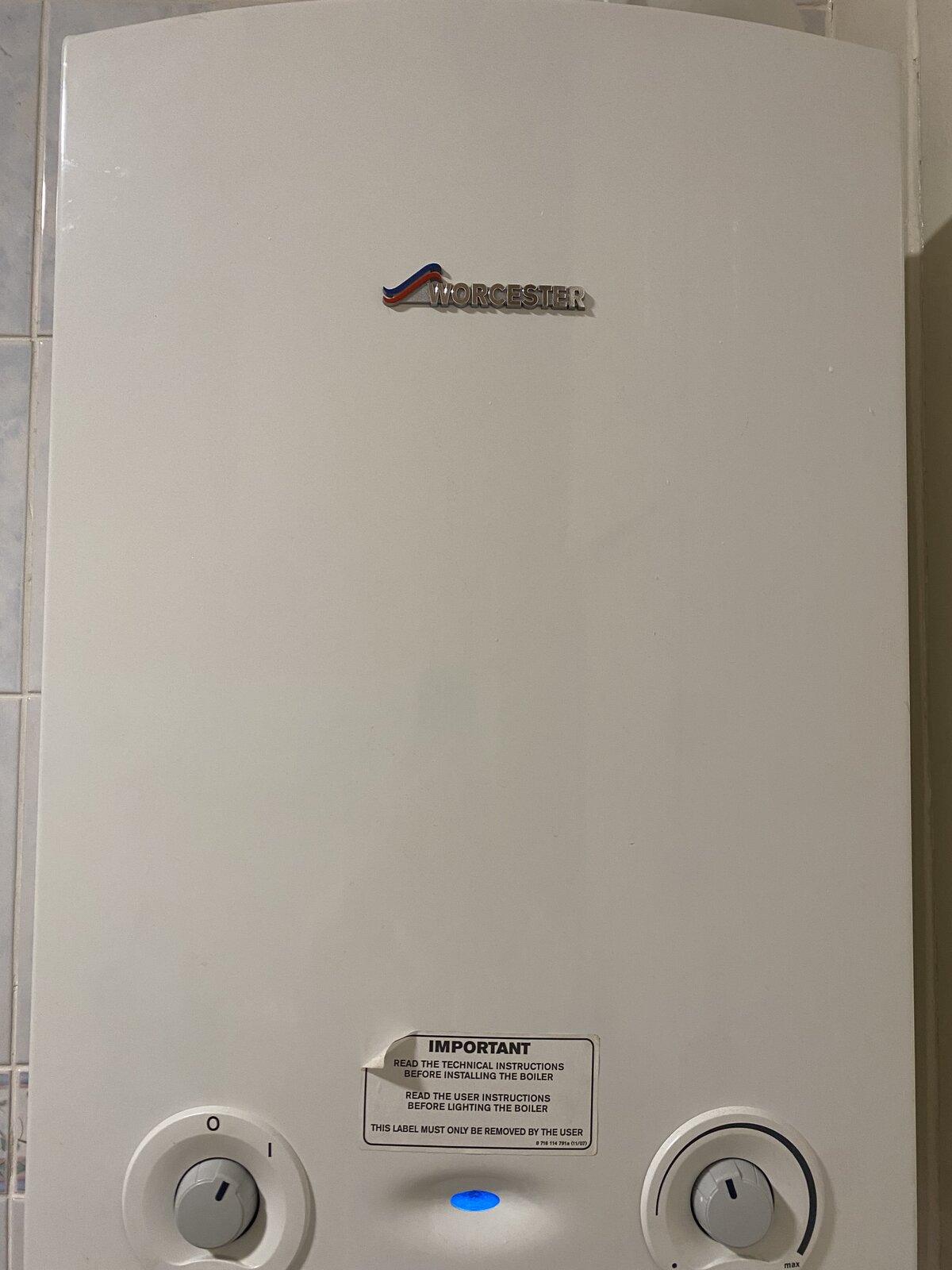

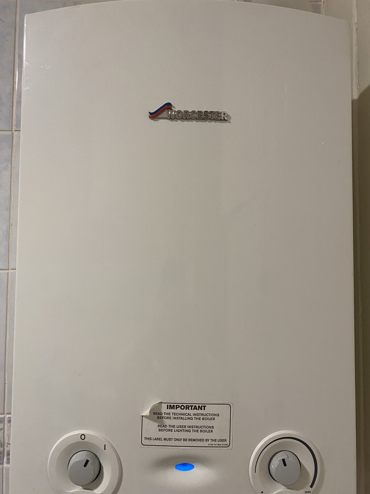

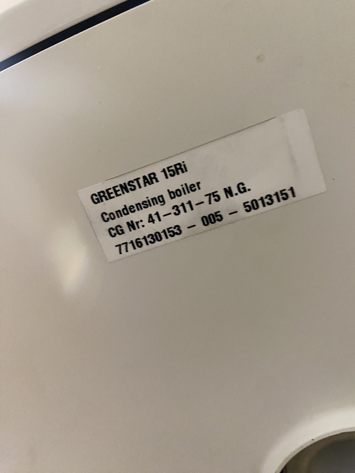

make and model of boiler
I know nothing about boilers , only some of my radiators working . 2 are Luke warm and one cold, others are hot. I thought it might be something to do with not enough water in them and a filling loop ? Not sure , I added some pics if anyone can help me, 1 radiator does not have a thermostat thing on. I don’t know what system I have so if someone could enlighten me! I’m wondering if the ones which don’t work have enough water in them ?

user manual for that boiler here

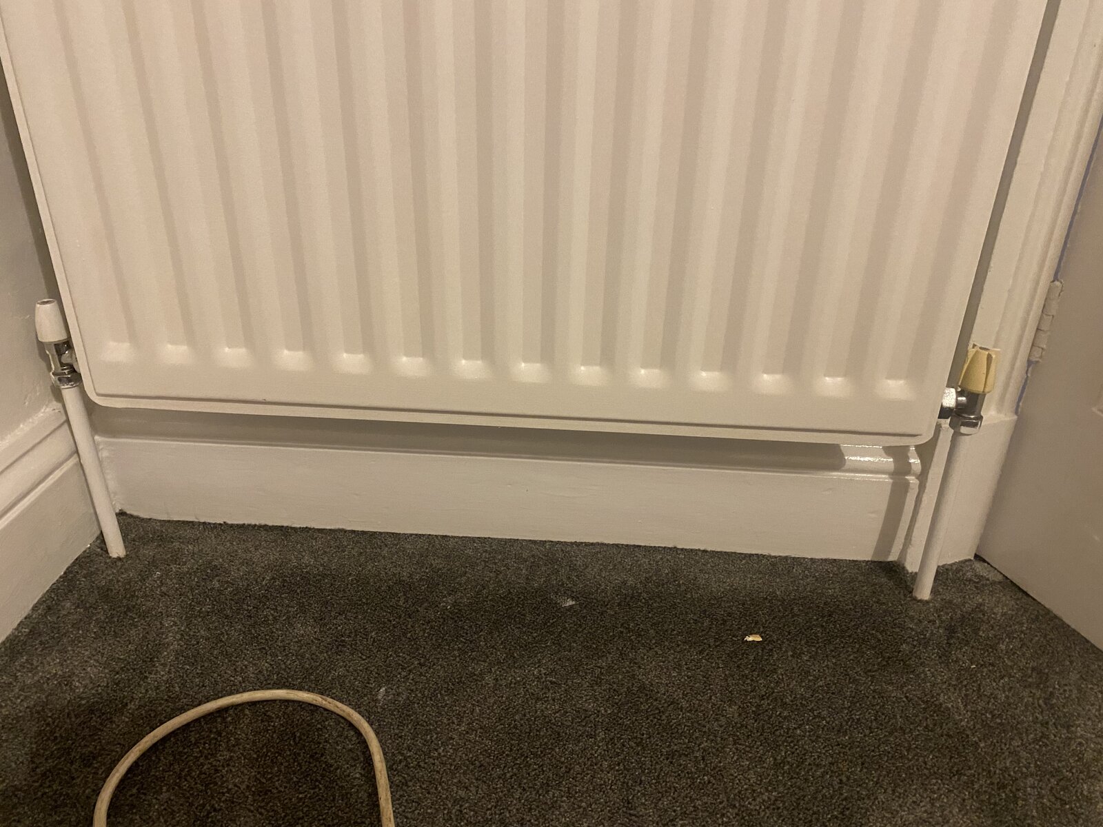

its normal in my experience that 1 radiator should not have a thermostatic valve on
and check the pressure - if a filler loop as mentioned, in the other thread is on the system
can you confirm if you have a filling look with a pressure gauge
see section 4
4 SYSTEM PRESSURE
4.1 OPEN VENTED HEATING SYSTEMS
If the boiler is fitted to an open vented system, that is a system with a header tank, the system pressurewill be maintained automatically
4.2 SEALED HEATING SYSTEMS
If this boiler is fitted to a sealed heating system, the system will be pre-pressurised. Your installer willhave fitted a pressure gauge and filling loop so that the system pressure can be monitored andadjusted as necessary.
Your installer will show you how to use the filling loop and advise you of the minimum and maximumpressure indicated on the pressure gauge.
B Check regularly that the pressure is maintained.

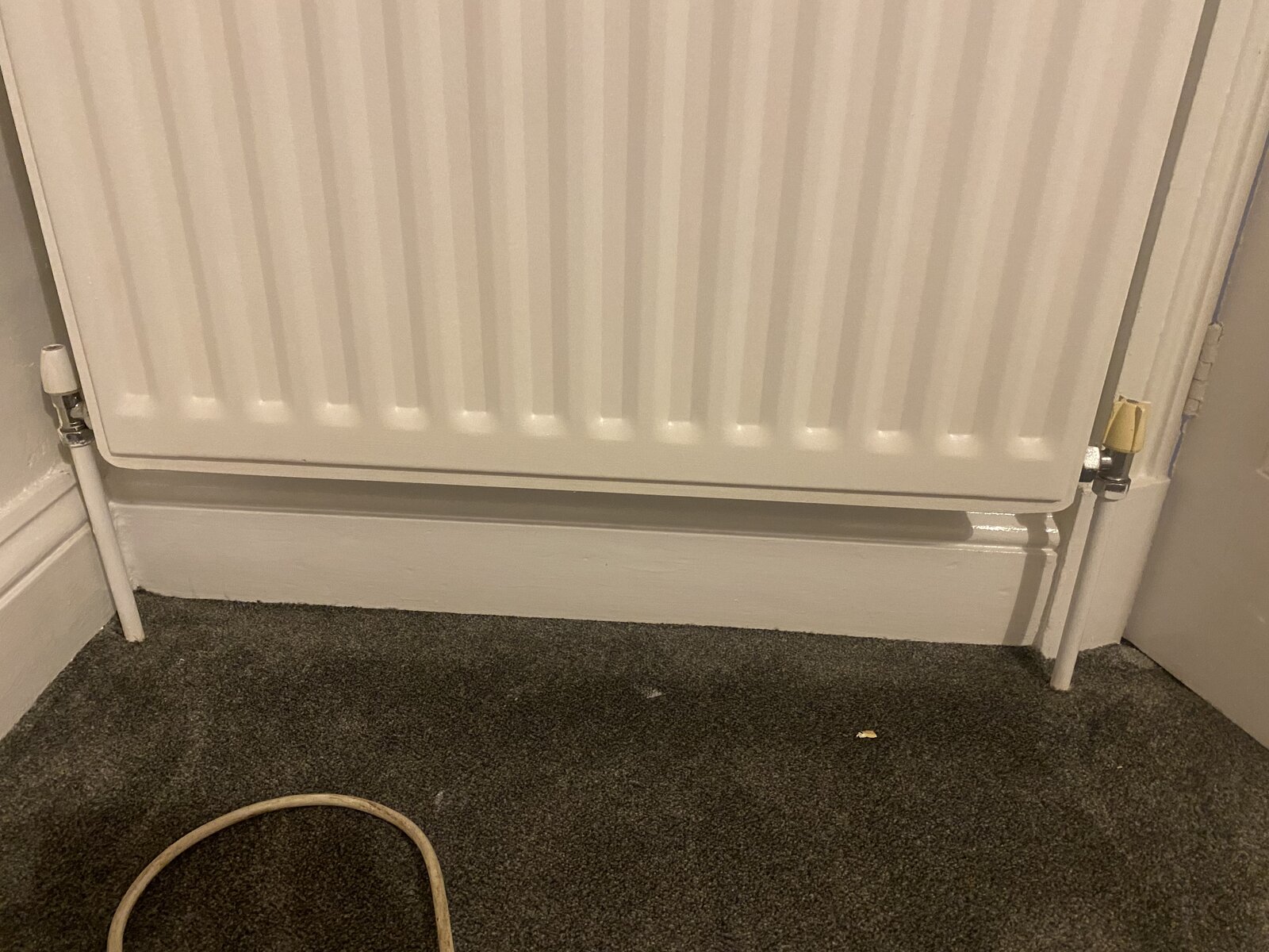

The ones that don’t work

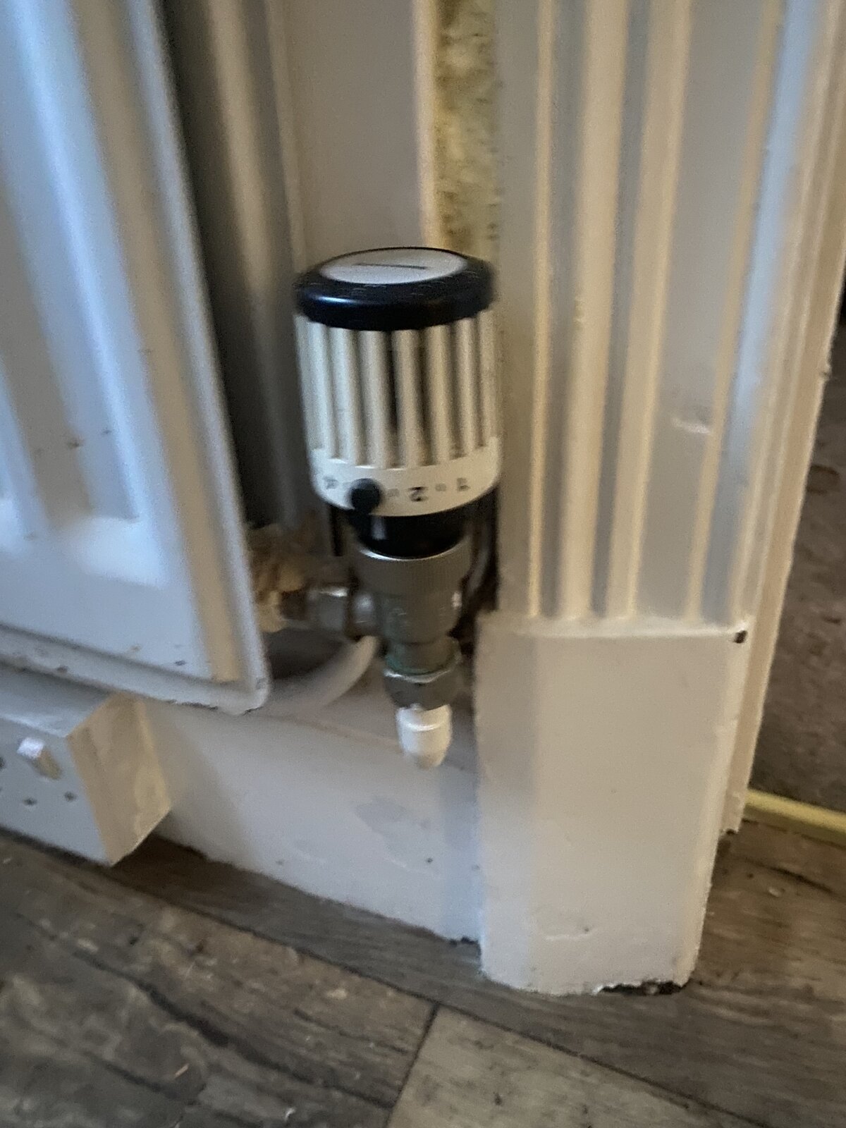

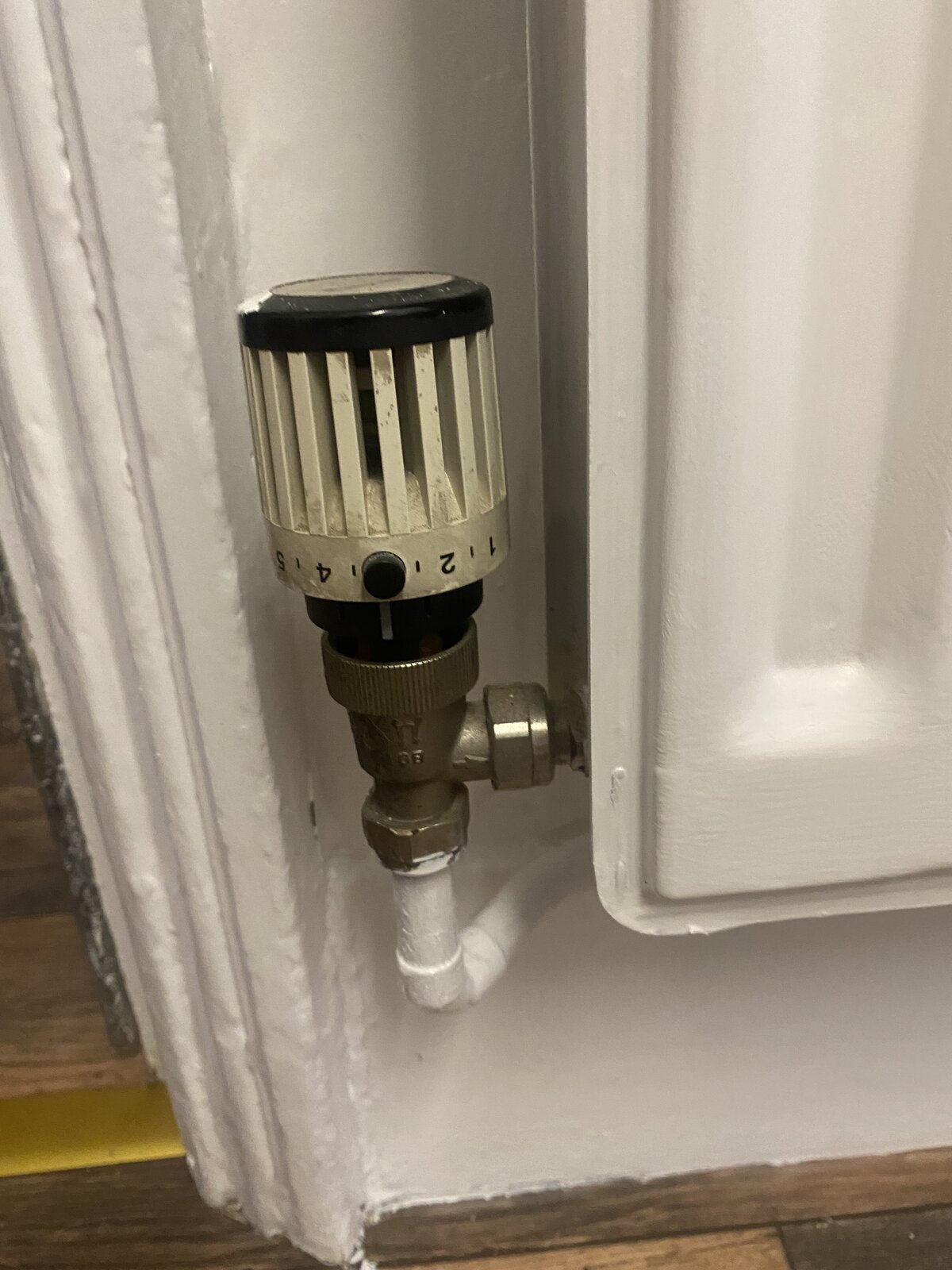

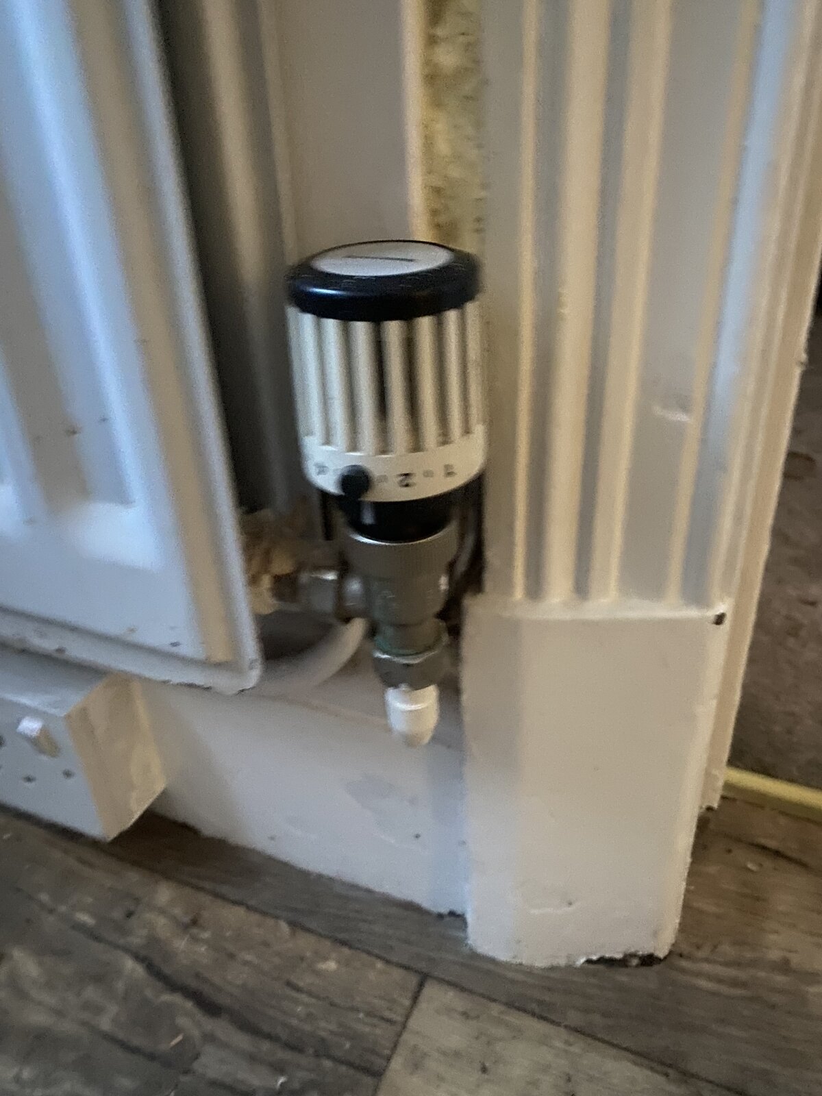

Ones which work
If it is a new house/flat to you, then assume that the radiators have to been balanced. The "TRV" at one end is effectively a thermostat of sort, but just for that radiator, so when it is warm enough (depending upon whether you have it set for cold or hot). The cover on the other end has a valve that you can partly shut off a radiator that is too close to the boiler, that way you make sure heat gets to the others. If you shut off any 4 with the other one set to max it will be really toasty. then open one other and shut the one that is hot, if you go round all of the like that you can prove if there is no blockages anywhere. Then after you know that you look at what needs to be done next. That is why Terryplumb asked you to close down the ones that are currently hot.
