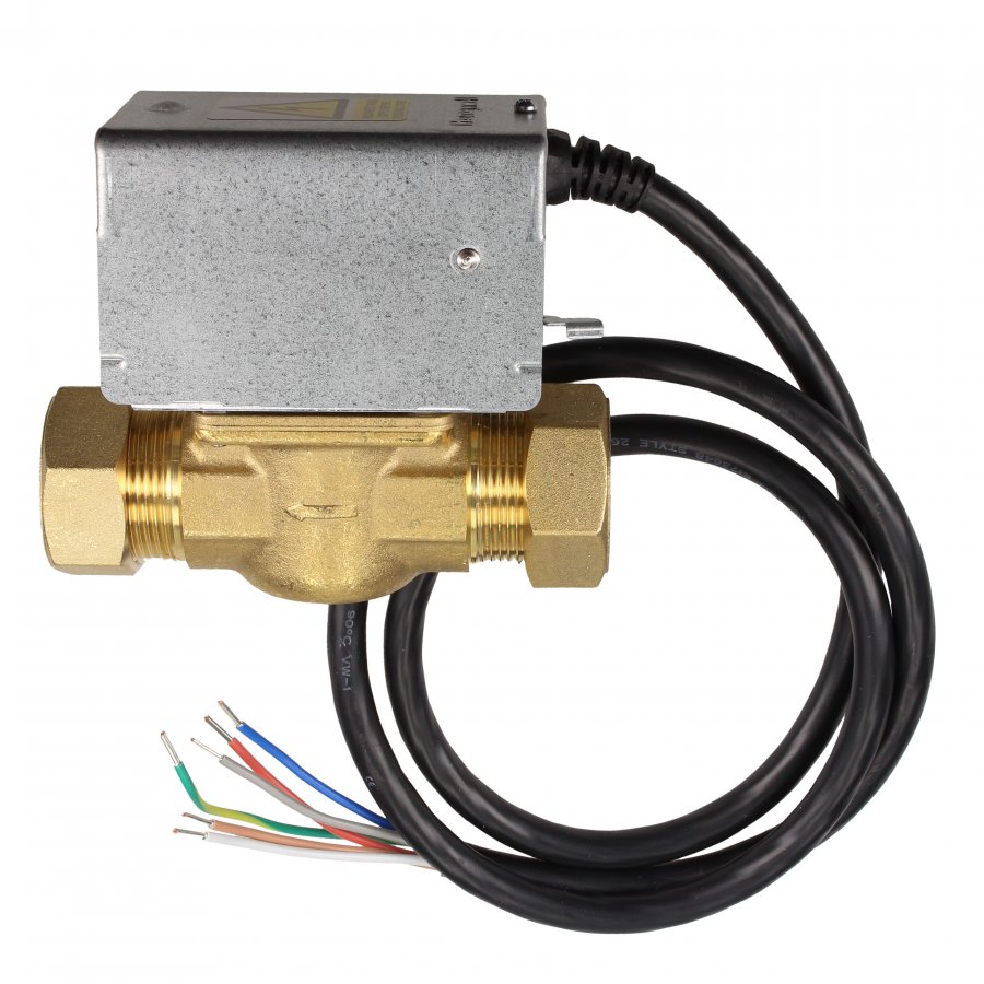

Could someone please confirm the orange is the 5th cable up? on mine it looks a dark brown
must just be me then but to me one looks beige one looks dark brown but means i have those connected correctly

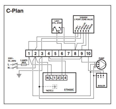

White core terminal 9 pump live and linked to terminal 4 for terminal 4 of ST9420C CH ON
Won't cut anything on those valves, barely long enough as they are ;)
Might ditch the wiring centre though and use some Wagos instead
