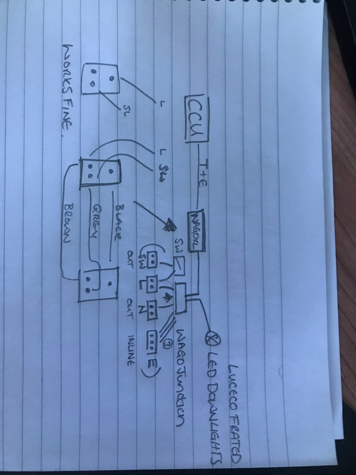

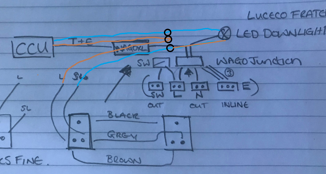

Hi guys, having read some of the posts and seeing how helpful you lot have been I'm hoping for some help and hoping I'm missing something stupid.
I attached a drawing of what i'm challenged with.
This light setup is on the landing and works fine on a single switch upstairs but I wanted to add a switch downstairs to create 2 way.
I looked at the wiring diagrams and watched the videos, changing the wires in the first switch and ran the 3 core and earth between the 2 switches, nothing! the switches are doing nothing despite power running through them. I ve also tried the 2 cable and com in and out method and that didnt work.
Like ive said works fine on a single switch, I've run a contuinity test on the cable I ran and also tried this with a metre long cable with both switches at the point of the first switch.
brand new mkswitches all new cable and LED's. Also the Wago xl will have another 4 lights and switches run from it eventually thats why it exists
Last thought is its a faulty switch some how but im pulling my hair out now.
Please help.
