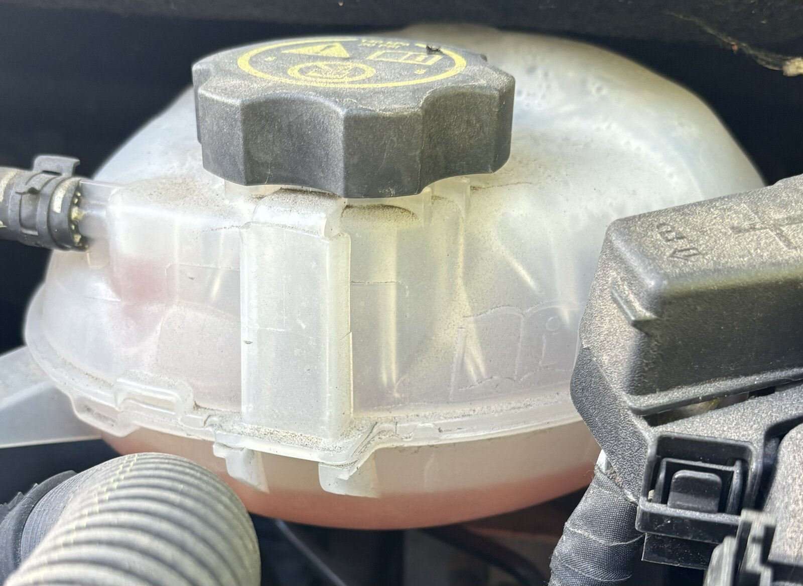

G Gibbies Joined 17 Nov 2019 Messages 154 Reaction score 10 Country 18 Nov 2024 #1 Hi Looking for a bit advice regarding the coolant level on my 2018 Vauxhall Astra as I cannot seem to see the minimum or maximum indicator. Does the level look to low? Thanks Attachments IMG_6640.jpeg 273.3 KB · Views: 293

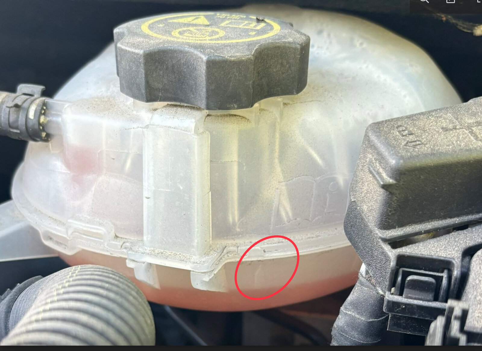

Mottie Joined 27 Feb 2017 Messages 54,641 Reaction score 13,584 Location Essexshire Country 18 Nov 2024 #2 Yes, too low. It’s the seam between the top and bottom of the reservoir. It's where this arrow is pointing to. Make sure you top it up when it’s cold.
Old Salt Joined 31 Mar 2020 Messages 2,746 Reaction score 942 Location Fareham, Hants Country 18 Nov 2024 #3 There will be 2 marks on that expansion tank somewhere but if you cant see them I would bring it up to just over that join in the tank.
