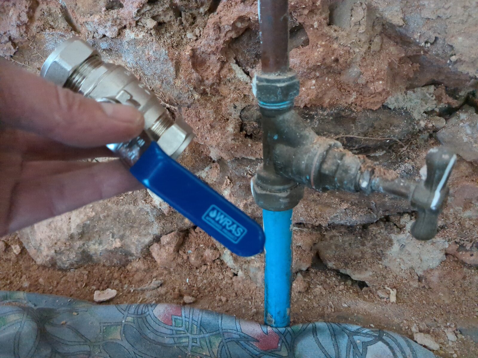

Hi all,
I want to change stop cock from old gate valve to a lever valve... Any advise as to how to make connection?
If the old one isn't leaking then leave it in place and fit your preferred valve above it and leave the original fully open
If you want to get rid of the brass then probably need to use philmac/plasson copper transition coupler to take it from 20mm to 22mm then fit the valve
It’s MDPE pipe and not PEX, various types of adapters are available, most plumbing merchants will be able to help.
