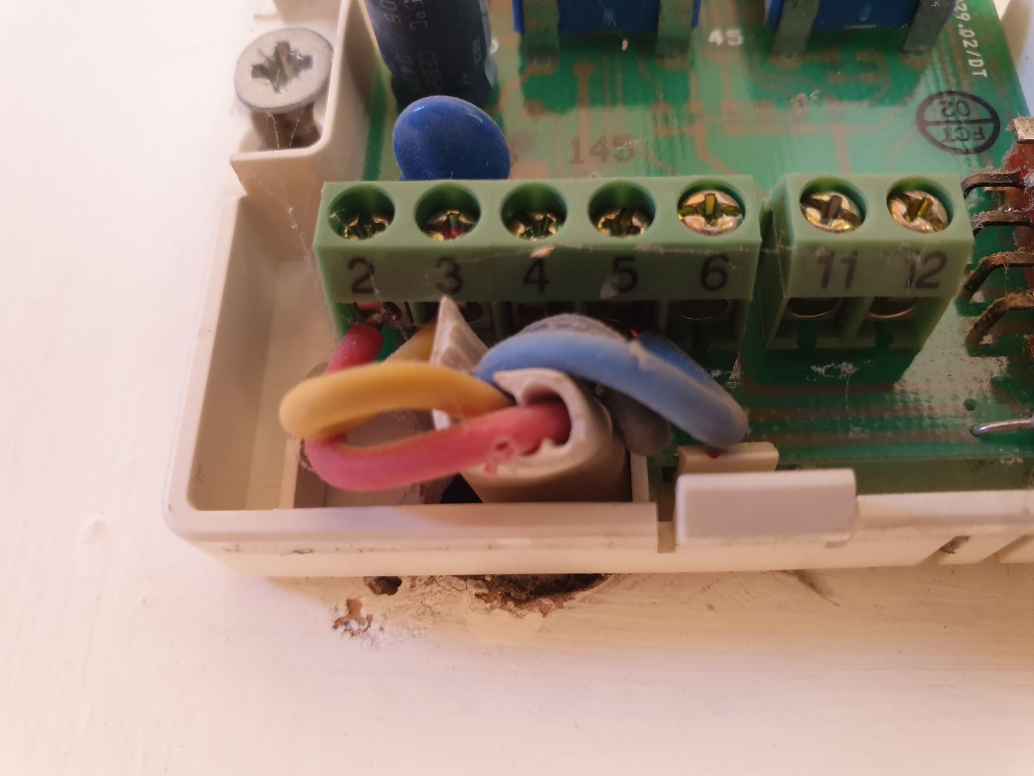

Hi
I have underfloor heating (water system) and I'd like to replace the room thermostat with a smart one (one of the cheap ones!)
However they all seem to be 95-240v and mine is 24V. It's a Wirsbo.
The Nest ones seem to be 24V but are 10 times the price.
Despite the great fat wires it's showing 24V (well 28 actually) on the multimeter.
Anyone help me out with what to get? is there a reason that the cheap ones don't come in 24V?

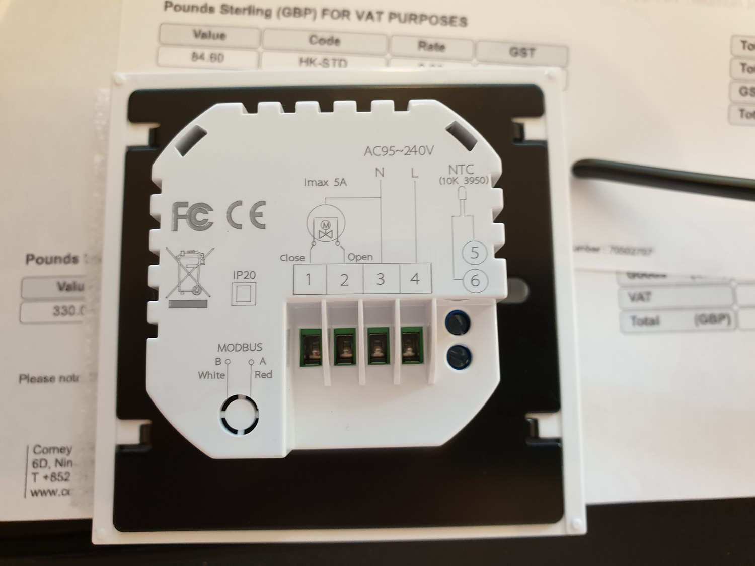

Most single channel timeswitches have Volt free switching, two channel programmers dont as they switch motorised valves, I think the 95-240V you are looking at is to actually power the units, and not the switching terminals

That did cross my mind. I have a 24V one here that I ordered. However the inputs on it clearly state 110-240V
It's not a timer (the old one) it's just a room stat.
I could try it and see what happens!
Anyone have any idea what the different coloured wires going to my stat represent?
As @ianmcd , your new toy requires a supply of between 110v and 240v to power its innards.
The relay controlled by those innards makes or breaks a circuit between pins 1 and 2.
You may find that your new toy doesn't work very well with UFH (from what I've seen the operating band for UFH is much tighter than for conventional heating.
Without seeing some better pics of the back of the existing stat it is tricky to say what your existing wires do
They dont represent anything never go with colours on a heating system
That’s not how I read that diagram!!!
I see a motorised valve which should be connected between 1 or 2 and neutral, with the assumed internal relay between live (4) and 1/2 normally closed/open respectively.
I could be wrong though. I’d open it up to check.
ming666, can you post a link to that device? I’m interested by the modbus connection - though it may be blanked off?
Apologies- yes think you're correct with your reading of the back of that thing, served me right for looking at it on a phone with a cracked screen & erratic zoom.....odd toy, is it switching the neutral?
