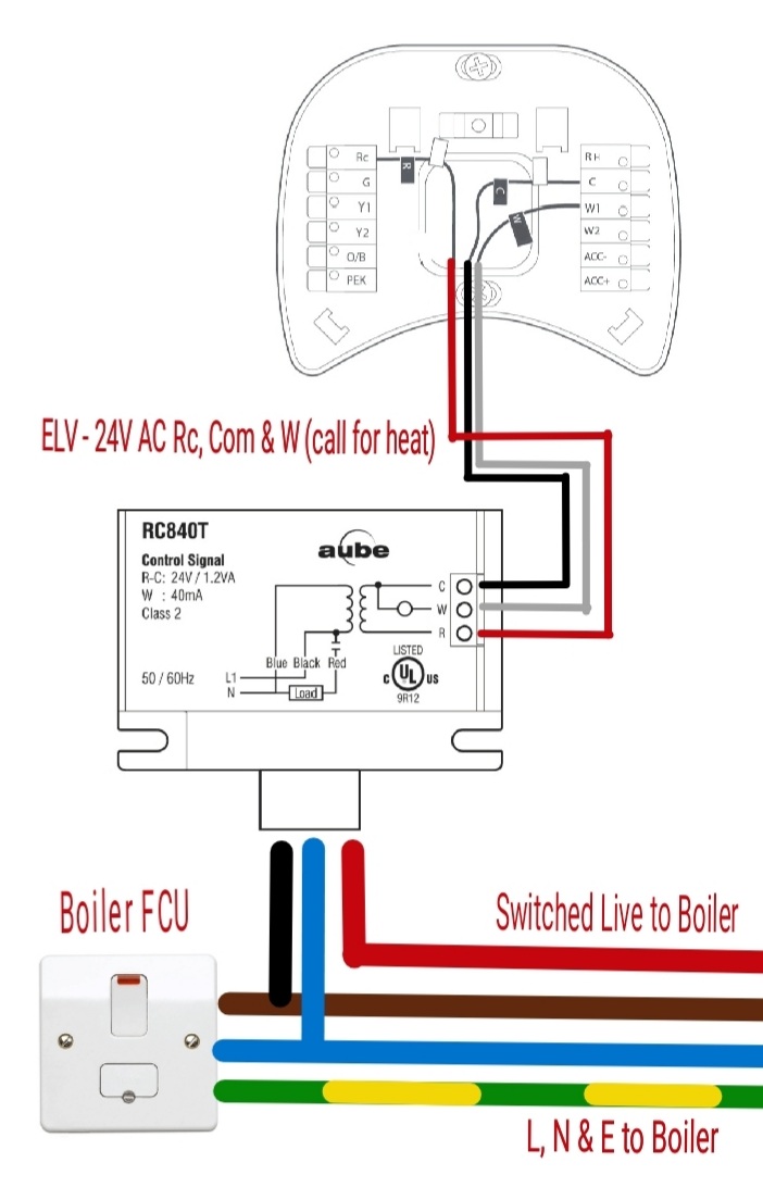

The device @MurthyBruit links to:
Is quite a neat solution - from a mains input, it provides a 24V supply to the EcoBee, and takes the switched 24V output and converts it to a switched live to control a UK boiler.
An electrician should be able to figure out how to connect it (the time taken will undoubtedly increase their cost!), but it will need a suitable enclosure (again at a cost!).
...and the device itself, isn't cheap at £73!

...and just for clarity, here's a slightly simpler diagram for an electrician ;) :
This is for use with an RC840T-240 and a boiler with a switched live call for heat.
The mains voltage connections to the RC840T-240 should be made within a suitable enclosure.
Its power supply should be fed from the same source as the boiler, i.e. the boilers FCU - although all the relevant connections may be available from an existing thermostat.
Beware, the RC840T-240 is built by a reputable manufacturer, but is not intended for use in this country; hence non-standard use of a black wire for the Live connection. As such it does not appear to have a CE mark (neither does the EcoBee!) - although it does also seem to be marketed under the Honeywell brand and is compatible with 230V AC @ 50Hz.
