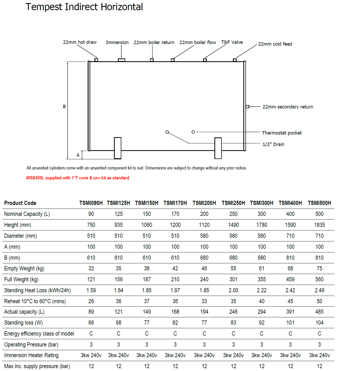

This what a typical horizontal cylinder migh look like.

Is the cylinder indirect - I.E. is it's primary heat source the central heating? If so then the immersion element is only a back up for when the CH fails and should not be considered it's primary source.
The other issue you have is - it's a horizontal cylinder - sorry but to be direct they really are terrible things.
HW Cylinders were never designed to be on their side by the very nature of how they are designed. Using convection as they do, I've always found horizontal cylinders to very inefficient when trying to heat the whole store and they always struggle to provide anywhere near a full cylinder of hot water.
I never recommend them and opt to fit smaller standard vertical cylinders in tandem.

This is what you should have, with top mounted Immersion as standard, don't see blank for the second immersion. It gives a reheat time of 35 minutes using the indirect coil, this means the coil is rated at 24.5kw but this would probably be at a 80C boiler flow temperature which you are unlikely to be running at, however, if only running at 65C then there is no reason IMO why you cant heat that 246L from say 15C to 50C (stat setting) in a hour or so except that the boiler is cycling on/off, the coil should be outputting ~ 10kw so shouldn't be a problem for the boiler, is the motorized valve opening?.
You said you swapped the stats around, the stat pocket shown near the bottom is for the cylinder coil, the immersion stat is often in a pocket in the immersion itself that you access by removing the immersion top, where is the (second) stat pocket that you seem to be referring to?
Hi John the second immersion was a special order, sorry to confuse but I swapped the immersion stats over to eliminate any problem. Yes the HW is working as it should John the boiler is set to 70, I suppose I was expecting the immersion to share a bigger proportion of keeping the tank charged :( I am still a bit confused as to why the Immersion is preset to 60 for 7 hours and the tank stat is set to 50 yet in the morning the tank thermostat is calling for heat, once the boiler is on for some time the contacts on the tank stat open as they should and the valve closes.
