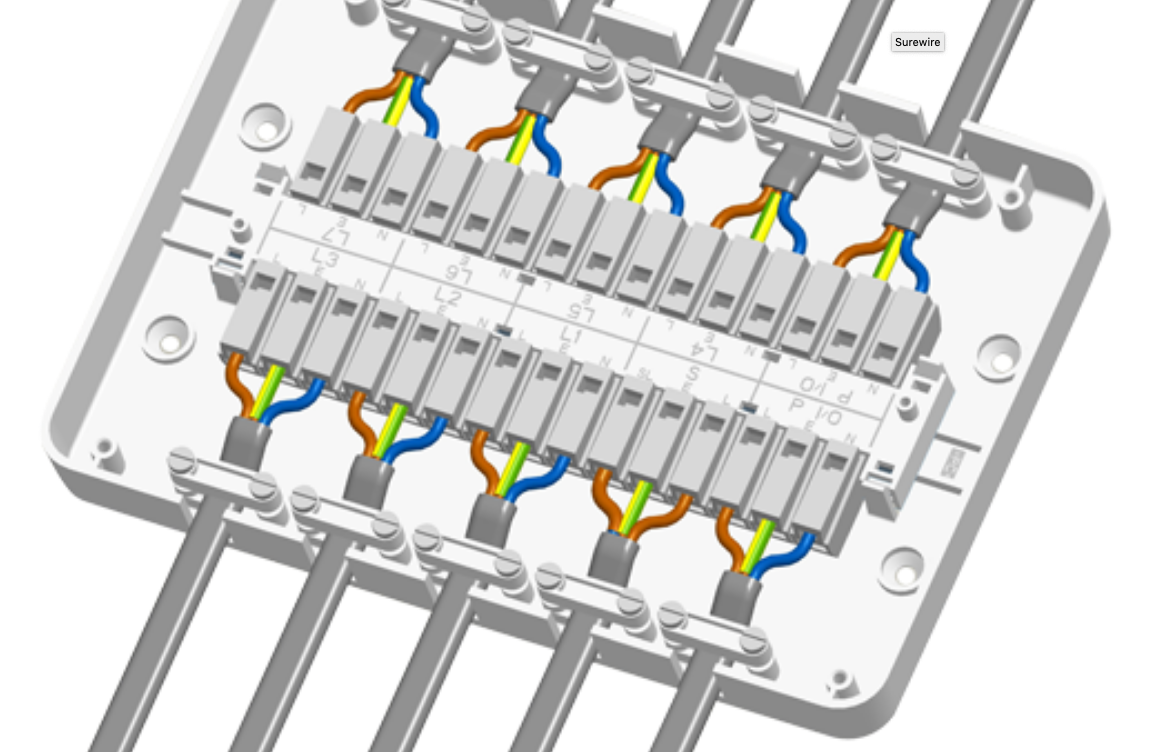

Hi everyone.
i think i’ve read all the posts on this but i’m still stumped.
I’m replacing a set of 2 fluorescent tubes controlled by a PIR in my garage with a cluster of LED bulbs and want to retain the PIR.
i’ve taken the feed from my consumer unit to the i/o terminal of Junction Box. The JB is 2 core + earth with the following terminals:
2 in/out terminals
1 switch terminal marked SL-E-L
7 light terminals
The cable from my PIR is 3 core + earth coloured Black, White, Brown and naked earth.
How should i connect the 3 core?
i’m assuming it should go into the Switch Terminal. Is that correct?
Should i be joining two of the wires together into the SL terminal?
Any guidance greatly appreciated.

For the PIR with its 3 core + earth coloured Black, White, Brown and naked earth, those cables will be
-Live (L) and Neutral (N) to power the PIR.
-And Earth (E)
-And Switched Live (SL) which goes live when the PIR is activated by movement - and sends Live to the Lights.
So to the Junction Box's "1 switch terminal marked SL-E-L" connect the PIR's Live to the hole marked (L), the PIRs Switched Live to (SL) and the PIRs Earth to (E) (The Earth cable needs a yellow sleeve to cover it).
You will then have to also connect the PIRs Neutral (N) to a suitable Neutral connection on the JB - use the (N) connection on one of the "2 in/out terminals".
Does your PIR say which colour cable is which? You may need to open the PIR to see how they are connected.

So with your guidance we have the PIR working...in so much that the infrared indicator flashes when it detects movement...but no lights are working :):):)
The only way i can get a light to work is by connecting it to the spare OUT terminal on the JB and that renders it permanently on...
Stumped again :) Any ideas?

I am presuming you are using one of these:
Surewire 7 Way Pre-wired Multiple Light & Switch Junction Box SW7ML-M
https://www.toolstation.com/surewire-7-way-pre-wired-multiple-light-switch-junction-box/p58205
When you say
"only way i can get a light to work is by connecting it to the spare OUT terminal on the JB and that renders it permanently on"
what is 'it'?
My quick test to see if wiring is correct without the PIR would be to remove the PIR for the moment.
Check that into "P O/I"_Section you have your supply voltage cable (L, N, E).
And into say "L1"_Section (L, N, E) you have a cable that goes to a light/bulb.
Put nothing into the "S"_Section for the moment.
With this setup there is a break in the Live supply cable to the Light/bulb, as there is no connection at "S"_Section between the "L" and the "SL" (the switch is off).
With the power on the Light will be off.
Then (after turning power off) put a single wire on "S"_Section between "L" and "SL" (Typo corrected).
This will make the Live circuit complete and when you turn on the power the light will be on.

I made a typo,
I said: put a single wire on "S"_Section between "L" and "SW"
Should have said: put a single wire on "S"_Section between "L" and "SL"
I have corrected this.
With regards to your Light being on when connected into the second "P I/O"_Section:
Yes that would be expected.
The two "P I/O"_Sections are directly connected to each other with no breaks.
So they are all powered up all the time.
When you put a Light into the "L1"_section, it is designed to not work as there is an intentional break in the Live wire in the "S"_Section.
The lights will only work when you connect, in the "S"_Section, the "L" and the "SL" connections together with a wire (or a switch) to fix this break in the Live.
With regards to your question:
"When you say “put a single wire on the "S"_Section between "L" and "SL". “...this terminal is marked E (earth) it’s ok just to connect a wire here with no device etc?"
"S" stands for switch.
In the "S"_Section the connections between "L" and "SL" is where a switch would normally go.
The test wire I am suggesting acts like a switch that has been closed, so when the wire is inserted it is completing the Live Circuit to the Lamps.
Without the Wire there is a break in the live circuit and the bulbs will not light.
During this test phase there is no need to have a wire connected into the "E" Earth connection of the "S"_Section.
With regards to the PIR:
The PIR acts like a switch. It takes the power in on its Live (and neutral to power it).
And it outputs Live on a different cable (know as Switched live "SL") when it is activated.
So I would connect the PIRs "L" and "N" and "E" onto the "P I/O"_Section to the right of the "S"_Section.
This will power the PIR.
And I would connect the PIRs "SL" to the "SL" connection of the "S"_Section.
The PIR will then send Swiched Live power to the Lights when the PIR is activated.

SFK it works a treat!
PIR working perfectly and now adding lights :)
