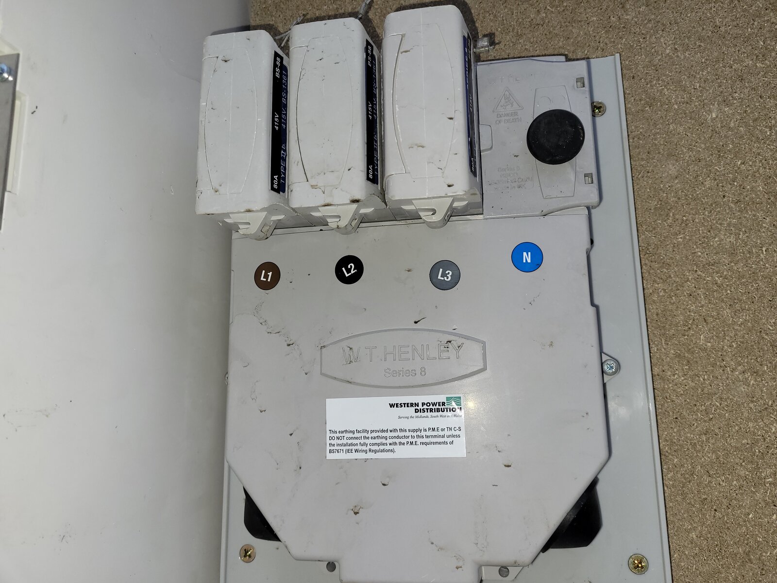

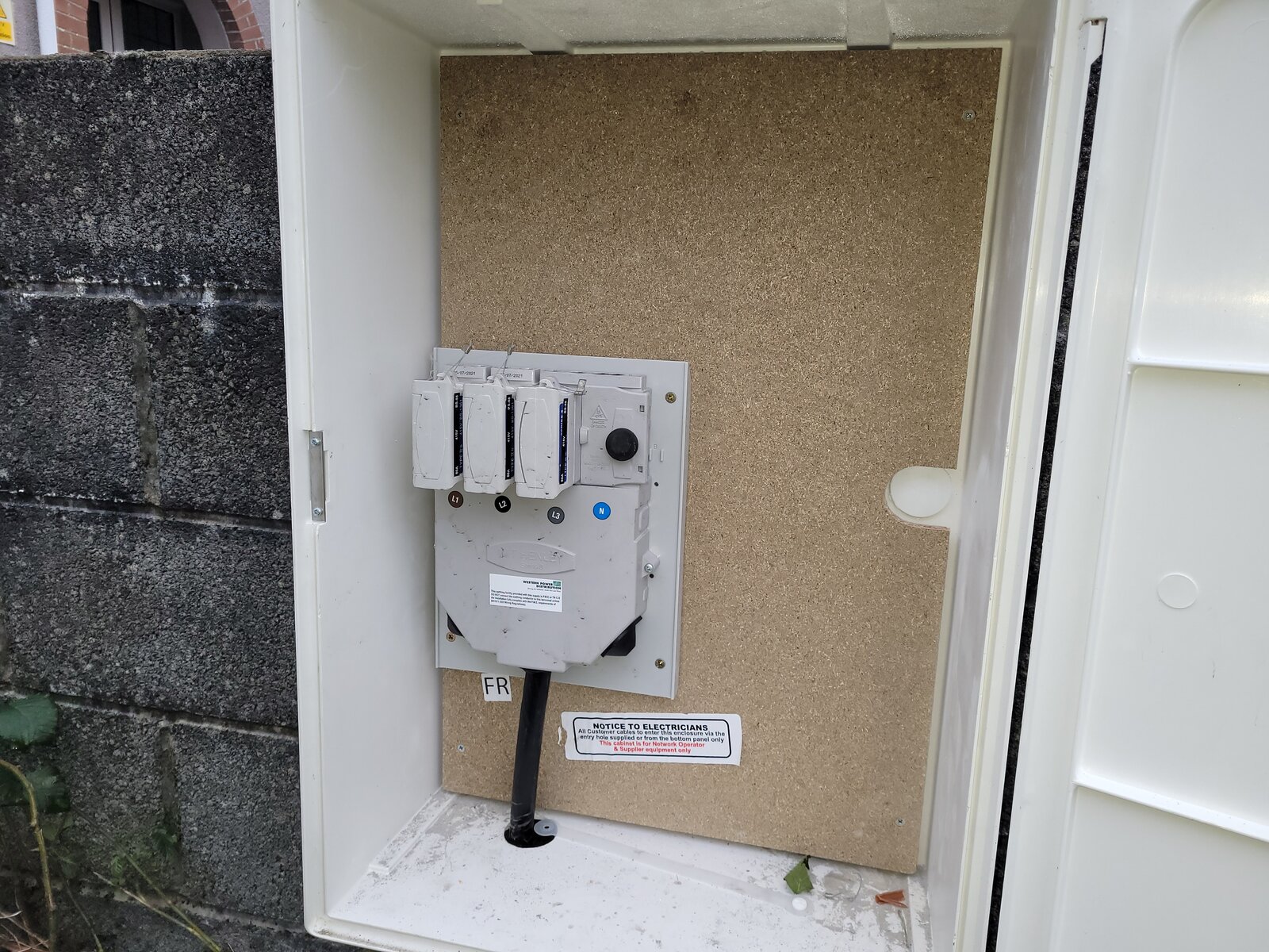

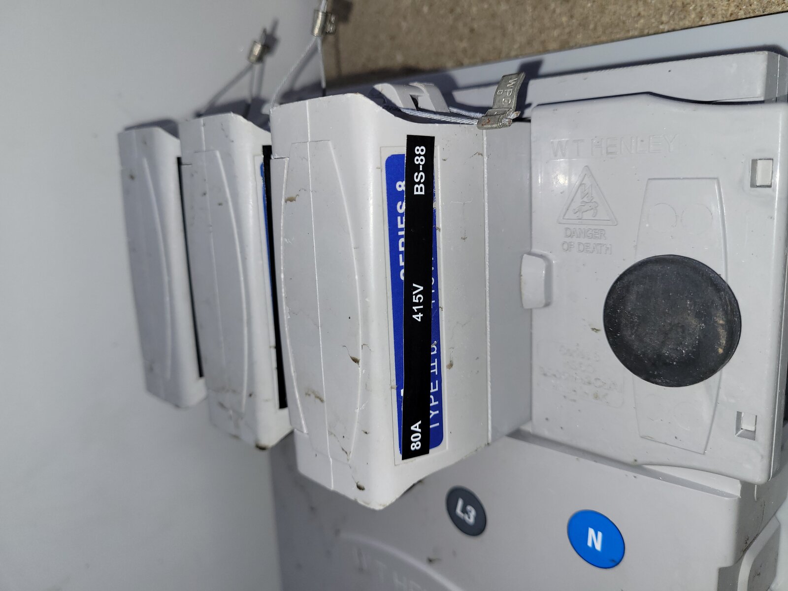

Hi Gents
I'm confused about what size 3 phase cable I should run from my meter to my workshop? I recently had a new supply put in (80 amp) 3c-25mm cu service cable to the top of my drive, and there is another 35 meters to the distribution board, Western Power tell me to carry on with the 25mm, but a sparky I had quote me suggested 50mm with a 25mm earthing cable to reduce voltage drop, wouldn't going up to a larger cable have the opposite effect?
