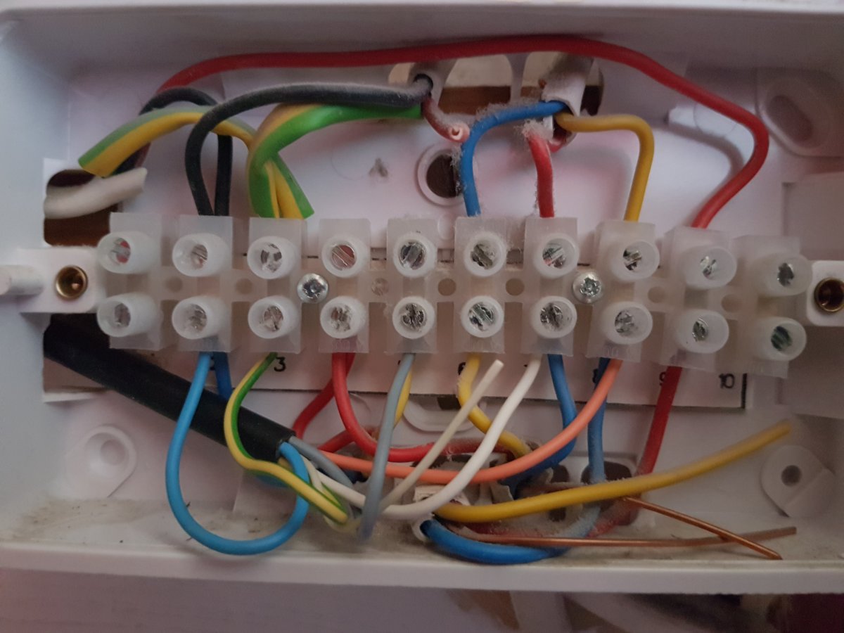

Now the warm weather has arrived we switched the heating off so only hot water would be called but unfortunately the radiators still got hot.
I searched various forums and the answer appeared to be a faulty 3 port valve so this morning I drained the system, changed the whole valve, sat back, thought what a great job I've done and switched the water on, but the radiators still get hot, I have checked the wiring but it appears correct, I have bled all the rads but they still get hot.
Looking at the various forums I can only see the answer is a new 3 port valve, but as I have done this and I still have the problem I am stumped.
Anyone have any ideas what it could be as I am tearing out what little hair I have left.
If as you suggest the controls wiring is correct along with replacing the 3 port (correct orientation) then I'm stumped.:):rolleyes:
Could be cylinder return not the last connection before boiler, bit of reverse flow going on ?
Op: check the wiring again... if you just copied the existing - it may have been wrong to start with!
It's a different 3 port valve manufacturer, old Danfos, new Salus, I remembered this morning that late last year when I manually put the heating on at the controller then I had to switch the hot water on as well, otherwise the boiler wouldn't fire up, I moved the auto-manual switch on the 3 port a couple of times & the problem went away, was this a coincidence or could the problem be the controller??
Im now not convinced the wiring is correct, this is how I have wired it up, I copied from the old Danfos valve
If the blue/red/yellow on 6/7/8 is from the room stat then no the wiring is not right.
I'm not sure if they are from the room stat, is there a way of checking & if they are then how should the 3 port be wired up? thanks for your help with this.
White core for MV (term 7) is fed via room stat call for heat , not sure why you have more than two cores into No7 terminal?
