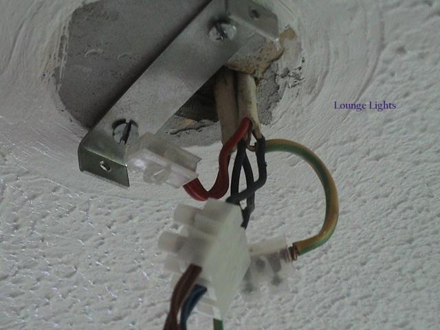

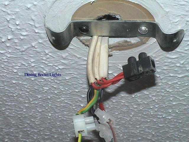

From the Dining ceiling I have a 4 core (Red Yellow Blue Earth) & a 3 core (Red Black Earth) Red Red Yellow Joined then Black Blue joined
From the Lounge ceiling I have a 4 core (Red Yellow Blue Earth) Red Yellow Joined

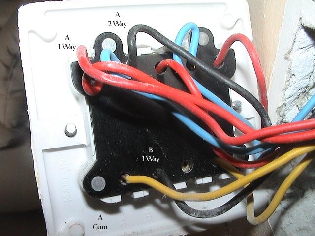

you're missing exactly one set of red and black from the left hand wires in the switch photo..
that 3C+E is not going to work unless there is a red and black at the other switch.. but you say not or havent checked..
we need photo's of the 2 switches as well as the photo's posted.
basically you need to re-wire your lights.. you're just putting makeup on a pig here.. still won't make it a proper date...

from what I can see.. you have...
3 x T+E at one light, and 2 x T+E at the other? no 3 core at either light?
to get the dining room light working put red with red, blue with black and leave the yellow separate..
ideally the T+E cable should be re-routed to the other switch and the 3C+E between each switch should be removed..
the lounge switch that's still on the wall should have the 3C+E removed from it's contacts otherwise you'll have live ends flapping about..
Ok did that but the dining room switch still does nothing. I can turn both lights on from the lounge switch but nothing from the dining room switch

EDIT:, ok so from looking at the lounge light closer I can see you have 3 x T+E cables there too...
so my guess is that you have the neutral from the linking wire in the wrong terminal in one of them.....

These are the switches left:
