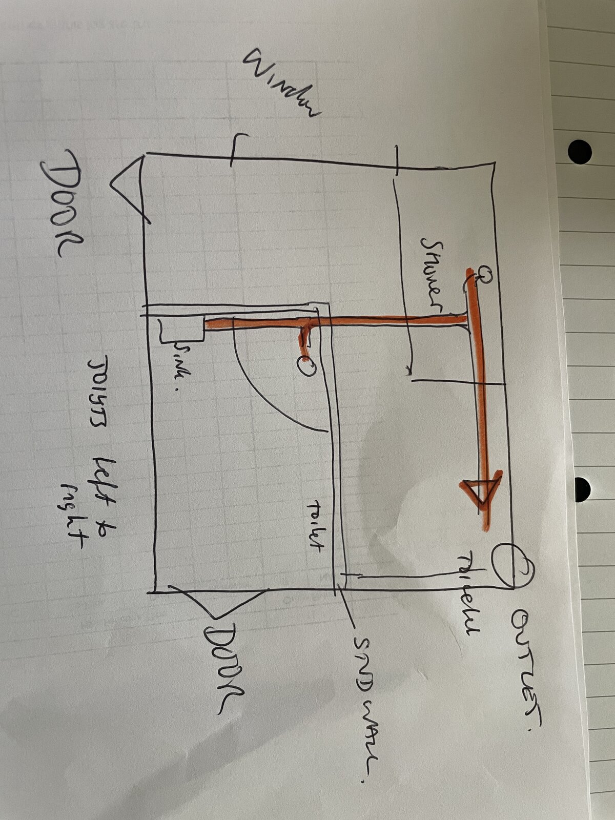

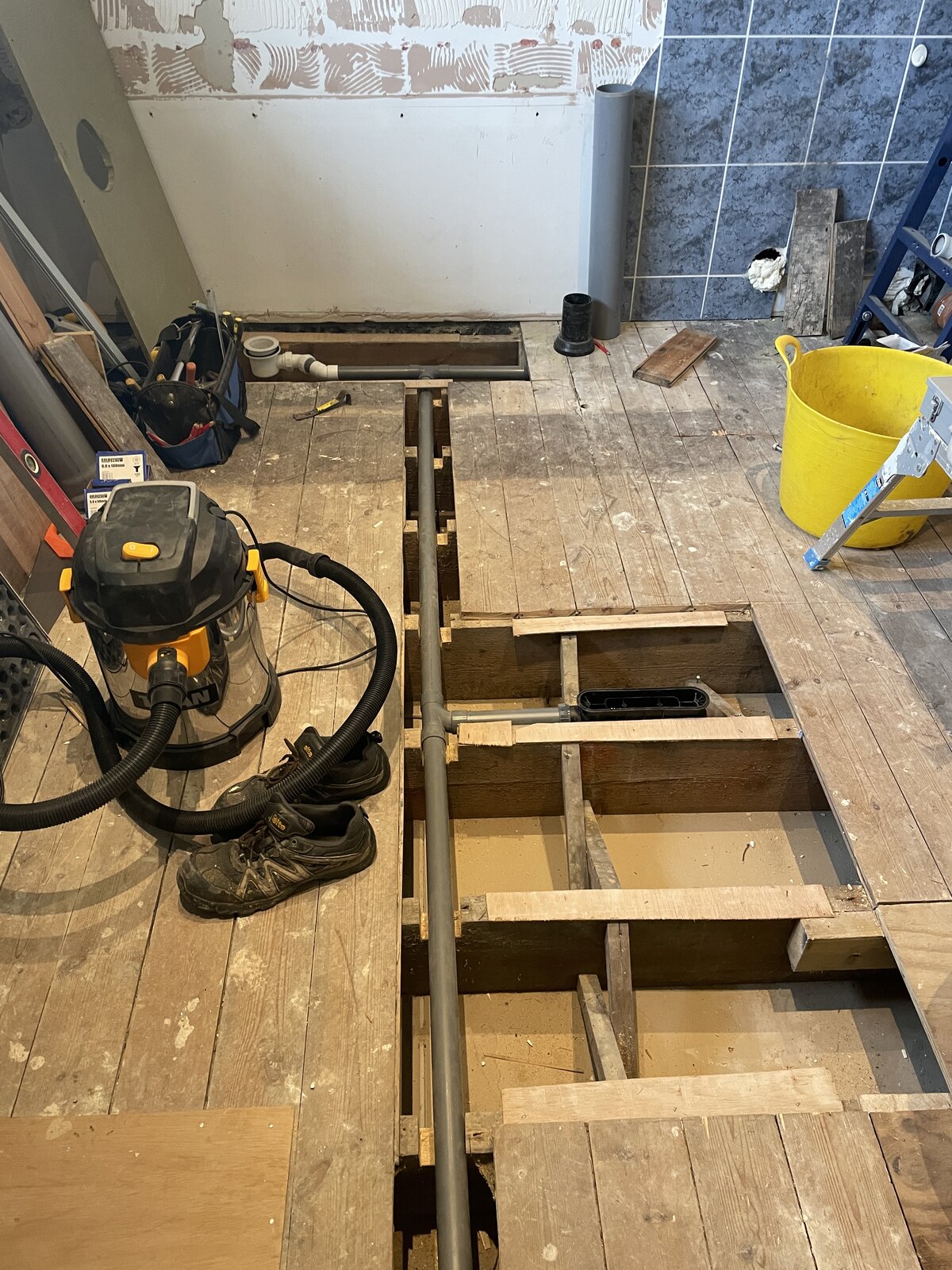

Thanks for input everyone. Attached some photos of plan and actual, nothing glued yet.

So your shower drain has no real restrictions to its fall, the restricted one is the basin drain....(?) Even so, a 36mm (1 1/4") pipe won't fit into a 30mm joist notch.
I strongly suggest that you do not common-up the basin and shower waste pipes, rather take the basin one to a separate tapping on the 4" soil pipe....the advantage is that if the shower waste blocks you shouldn't get back flow from the basin to the shower tray. Use swept bends rather than knuckle joints.
I am confused.
Your drawing shows trays in right hand corner of both rooms yet shower waste is in left hand corner?
Your swept tees appear to be facing the wrong way
Unfortunately it's the proverbial Feux Pas. Never design a 1 1/2" waste run into the floor against the joists, it'll never be right unless the joist are huge and you don't see them very often.
I have had to fail 2 jobs because the previous installer fitted the waste pipes against the joists and excessively notched them out. One job 2 joists were starting to fail because of it and the notch had started to pinch the waste pipe, cracking it cause a leak, the client had to replace 4 joists and the insurance walked away. They had to take the previous installer to small claims to get them to cover the cost of new joists, that wasn't pretty.
Keeping it the way it is, then the problem areas I see would be the linear waste not draining quickly enough, basin could back up into the first shower and both could back up into the 2nd shower.
I'd look to take the quadrant shower's waste and run straight into the stack through the joists, you should get away with drilling a 9" joist for a 11/2" waste. Drop the waste from the basin to 32mm then increase it all to 50mm at the top tee for the 2nd shower then into the stack. Fit an antivac to the basin.

how would I run “through” the joists I would never be able to get the pipe in?
You may be quite surprised just how bendy a 3m piece of ABS can actually be, if you can't get it through, joist centres not withstanding, simply cut it into sections, thread it through, then solvent weld it back together.
Calculate the max dia for the holes, the larger they are the more flexi room there will be.
