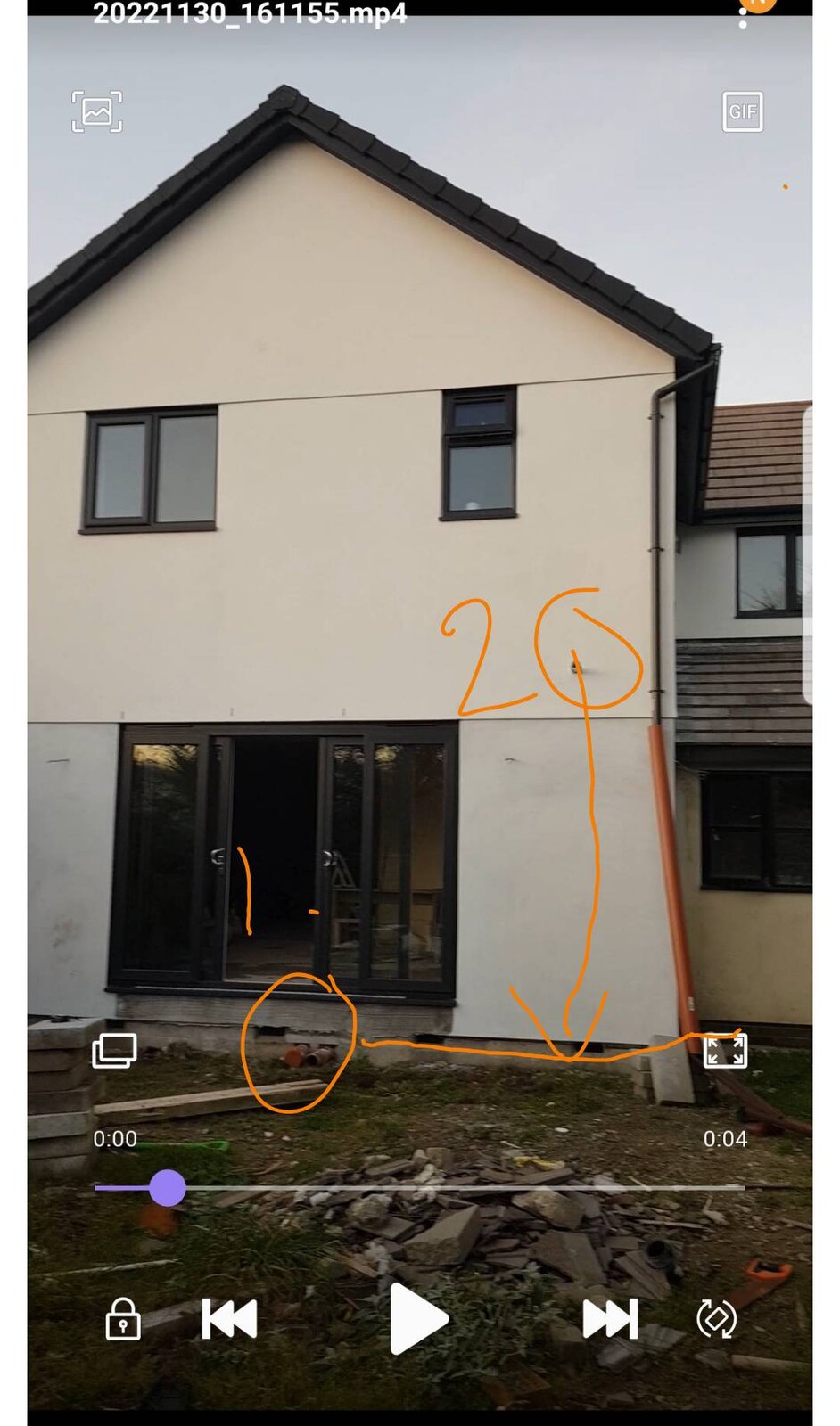

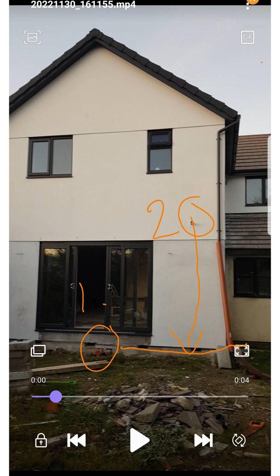

Thanks again guys. Can I just check Ive taken a picture of the building as you can see where I have circled 1 is the main 110mm soil waste which goes under the house. Am I correct in thinking I need to put an inspection chamber here as the waste will be changing direction?
And then as you see from number 2 (excuse the pun) it comes down and will join a 110mm soil pipe there again because the waste will be changing direction I'll need another inspection chamber?
All this will be above ground as you can see there's a bit of a drop from the double doors so we need to build up a patio of some form
If anyone has a brain wave as to the best way to go about it that would be brilliant.
Cant add the pic from my phone
Hopefully this will allow me to upload the picture..... And ignore the downpipe this wont be connected to the waste this goes (eventually) to a soak away :)

You've got 2 110mm pipes in the pic, are these coming out of or going into the property?
Your shower waste ideally needs to go into a 110mm stack pipe, which then needs to connect to the drain. Stack can be capped with an Air Admittance Valve, and would be better connected to the run under the house via an inspection chamber, (the shallow, 300mm diameter type would suffice, looking at the depth of the existing drain.)

Yeah there is a stack pipe further in (connecting the main waste from the house). We had to bring this 40mm one out as the joists were running the wrong way for us to be able to connect. The other 110mm pipe is tge radeon pipe so ignore that one
