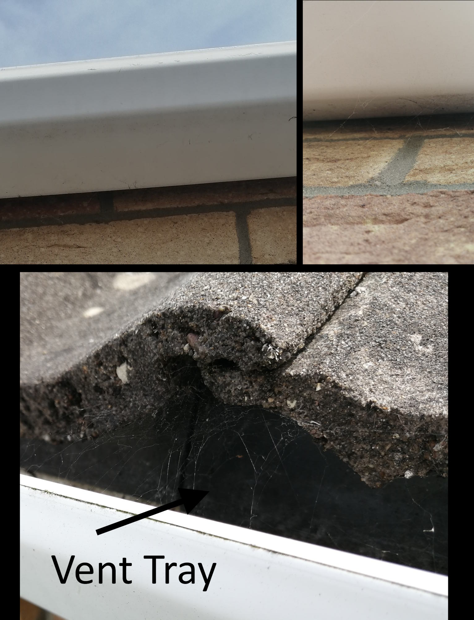

I have an electrician coming out next week to install an outside mini CU and a run of 6mm SWR (inc Data). The plan 'was' to feed the SWR up the outside wall and into the loft . However, I've just taken a more detailed look and the guttering touches the wall, there is no soffit, and the vent trays look to be in the way. Before I consider if it can be done without some changes to the guttering etc, will the electrician be able to do it within regs. If not, I'll have to think up a plan B.

Sould be able to drill a slopping hole up into the loft space but difficult to tell from your pic..I'm sure he will find a suitable way for you.
