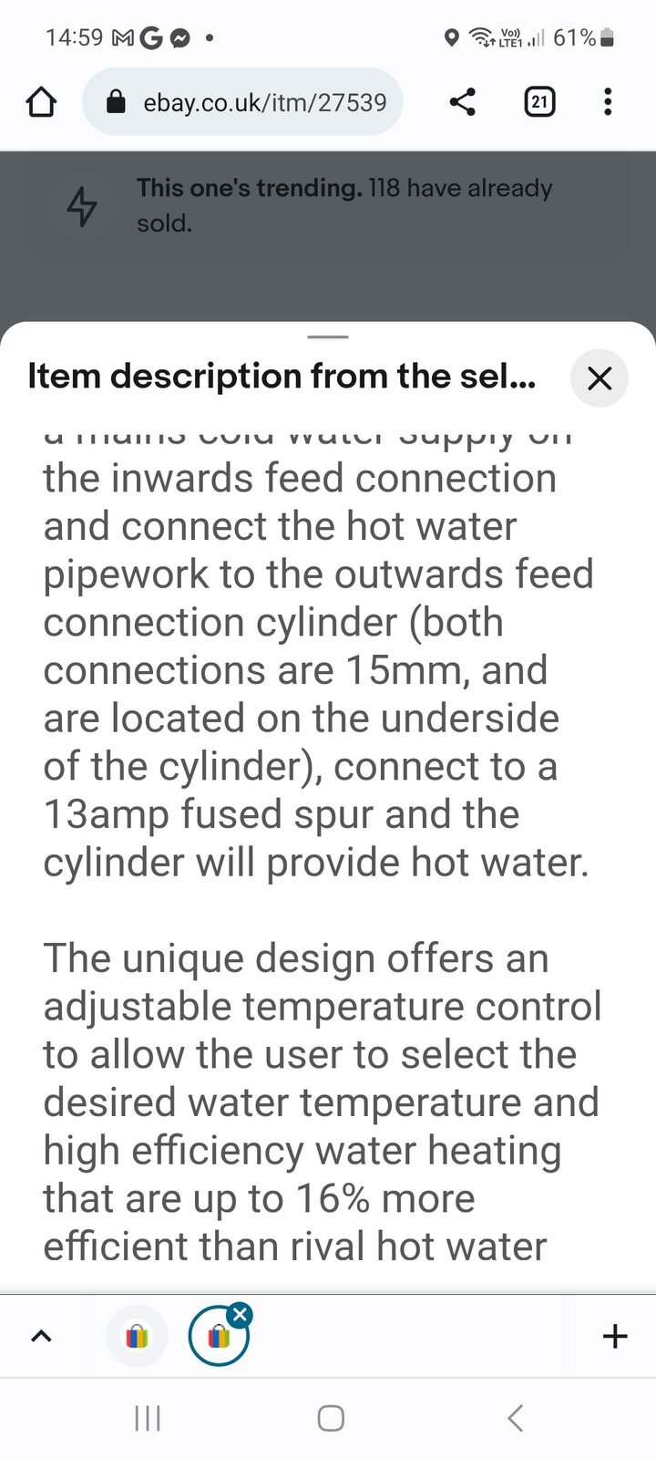

Hi, my electrician finally turned up to view the work in my outbuildings. He says the 80l unvented presurized water heater ive just bought will have to go on its own circuit because its more than 15l. The info from the page of the ebay seller says a 13amp fused spur. Its a 2000w heater european style. Ive been trying to find the building regs on the internet without success. At the end of the day i'll let him do it his way. Im still keen to know the regs

In the appendix 15 of BS 7671 it suggests items 2 kW or more which are fixed, should have a dedicated circuit so the load current in any part of the circuit will be unlikely to exceed for long periods the current-carrying capacity of the cable (Regulation 433.1.5 refers).

A 2kW load will never overload one leg of a ring where ever it is fitted. At just over 8 amps it is far less than the rating of 2.5mm2 cable. There is no reg saying loads over 2kW have to go on their own circuit either.
Back in the past (16th edition, I think) had a reg that said what your electrician had said.
But the requirement for 15litre+ water heaters to be on their own circuit does not appear in the 17th.
The last OSG that I have (green/17th) includes a GUIDANCE that vessels over 15litres should(not must) be on separate circuits, but there is no corresponding reg marker in that OSG.
My conclusion is that your sparky is not up to date and remembering a time when T Rex were in the charts.
Of course, he may have surveyed your ring final circuit and concluded that there isn’t enough capacity to add another 2kW. But I doubt it.

I would have thought that it would be best to treat it like an immersion with a dedicated switched fused spur ( with a double pole switch with the contacts spaced at least 3mm when open if I remember correctly ). I don't see why that spur could not be supplied from an existing ring circuit but opinions seem to vary on if any, and how many, spurs can be added to a ring main.

Hi, ive read through your discussions on the topic with intetest. There is no harm in my electrician putting it on its on circuit and so we may well do that. I will talk to him about it. As for the plumbing in, i have to use a plumber with g3 certificate. I have installed one of these in in our old french house about 20 yrs ago, not hard to do just have to follow the instructions. It has a pressure vessel and a blow out valve. Sadly also i have a hetas stove fitter coming to install a woodburner and a new twin wall chimney. Again ive done these before, was hoping we could do this one and get it inspected by building control. Unfortunately that is not possible here. We are developing part of an outbuilding to be a rentable holiday let. Everything has to be above board and certificated.
