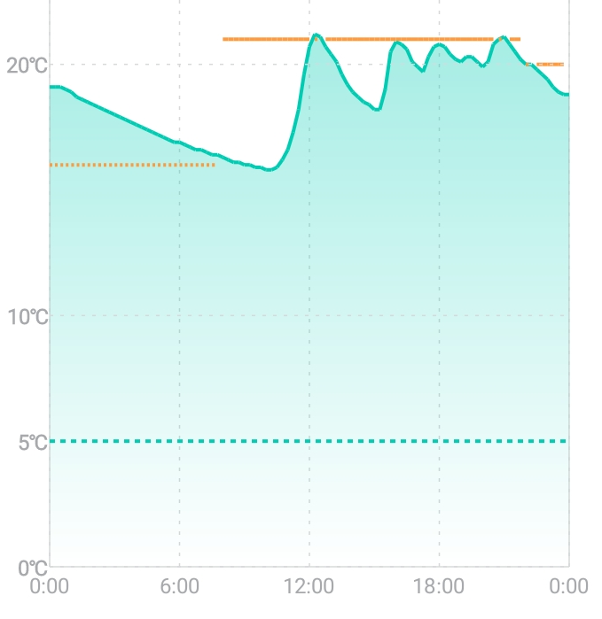

I would say in this house we do get away with 20 kW, but mainly as only 3 rooms are heated to 22ºC and only those rooms are heated as required, living room TRV head reports
for yesterday, switched off heating at midnight, then on again 11 am, and it dropped 3ºC in that time, but measure else where in the room, and the recorded temperature changes, above fire place (no fire lit) I am showing 21.2ºC the wall thermostat shows 21.5ºC one TRV 20ºC and other 18ºC that's the one showing graph, so hard to say how warm a room is, as it varies throughout the room, although doors never fully closed, other rooms in the house can show down to 16ºC so 5ºC outside, and I remember 1978 and power cuts in a house with single glazed picture windows and hot air central heating, and how fast the house cooled, with no way to heat it. Ice in inside of windows.
