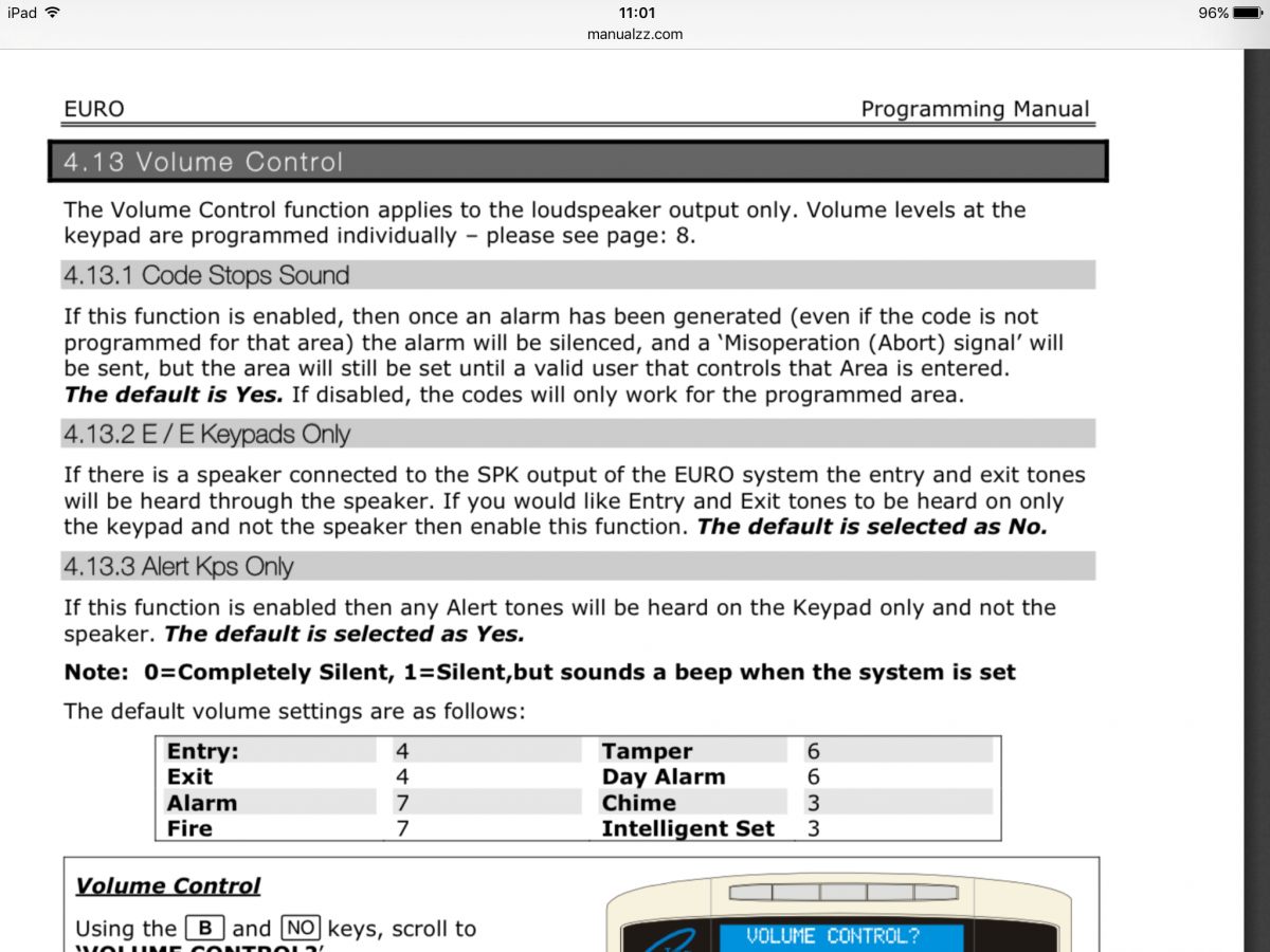

Quick bit of advice if anyone has any experience with the above alarm.
Have a Euro 46 which is serviced and contracted etc, question I have which doesn't seem to be answered without a £78 call out to look at the alarm is can I set silently.
Reason I ask, I have a bedtime set zone which disables the upstairs PIR, I dont use this currently because when I set the alarm after 30 seconds I get a loud confirmed beep from the internal siren, I have a 3 and 2 year old that wake at the slightest noise!!
Any way of changing, I have all access codes etc including engineer, it has been set to not do the 30 second countdown noise its just the end one!
Thanks for any help
Jon
Never tried to turn the final bleep off but it is in engineer program under volume control. If its the B setting then volume control. Exit B. Try 0. It's usually set to 1. You access to engineer mode will show in the log.
Try the alert keypad only , if not alter the intelligence set to 1

The keypad tones affects all the setting modes. However you may prefer this as it still makes tones but very soft.
Thanks for your detailed input, i'll try the volume changes later, any problems, i'll update the thread in case it comes up again :-)
OK this worked! Its driven another question though, the entry didn't go off when I walked back downstairs and that is set to (1) as the exit was originally, all the other set zones seem to be at (2) or (3) with alarms, tamper etc being (6) or (7), i'm pleased about that but just seems to be a bit of a contradiction!
Thanks again
Yes the lowest setting to hear the timer bleeps is 2. Are you sure it hasn't been changed by mistake? Either way just try it.
