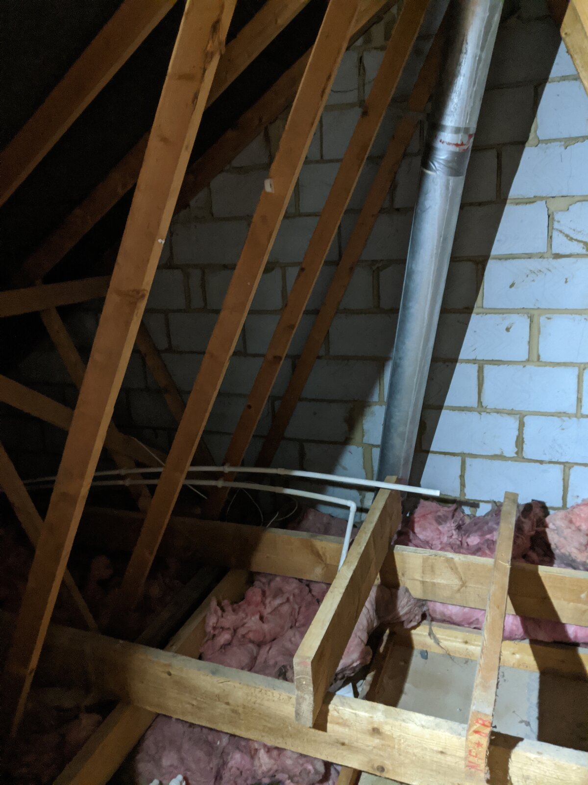

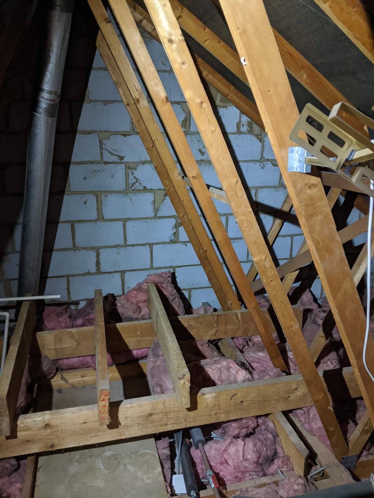

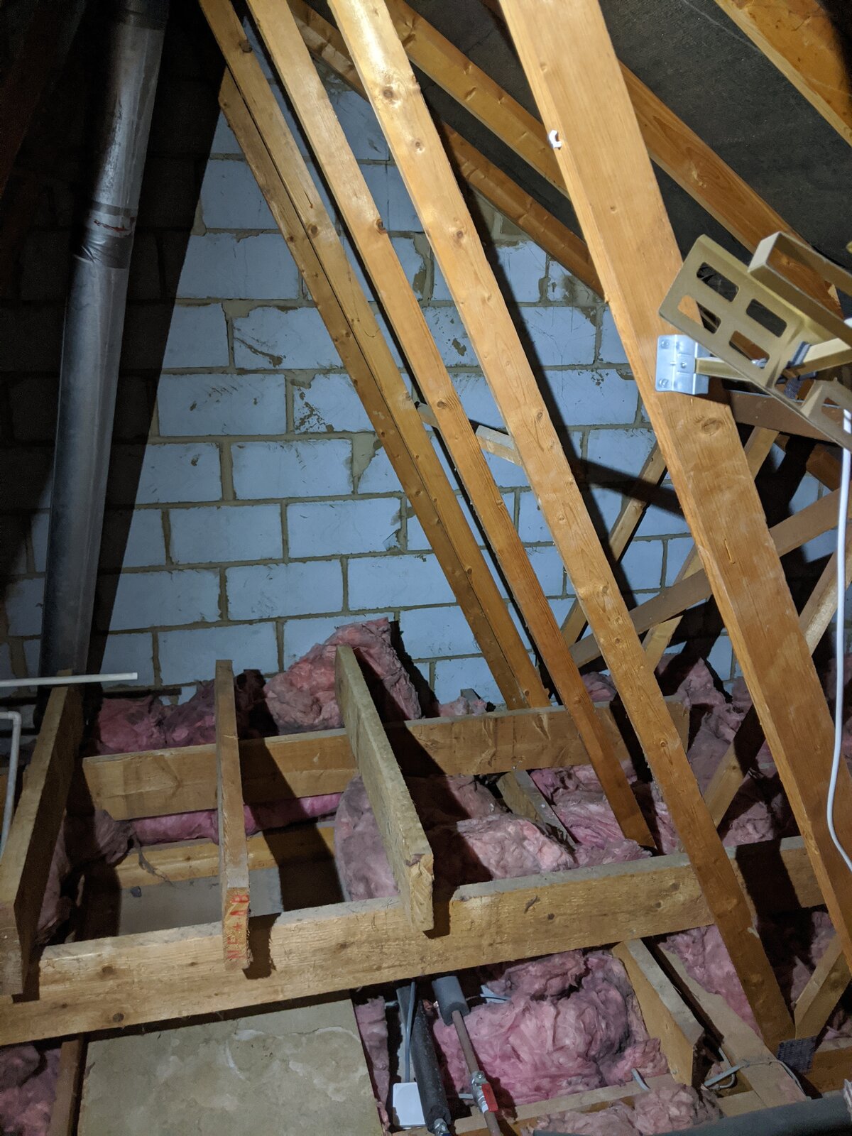

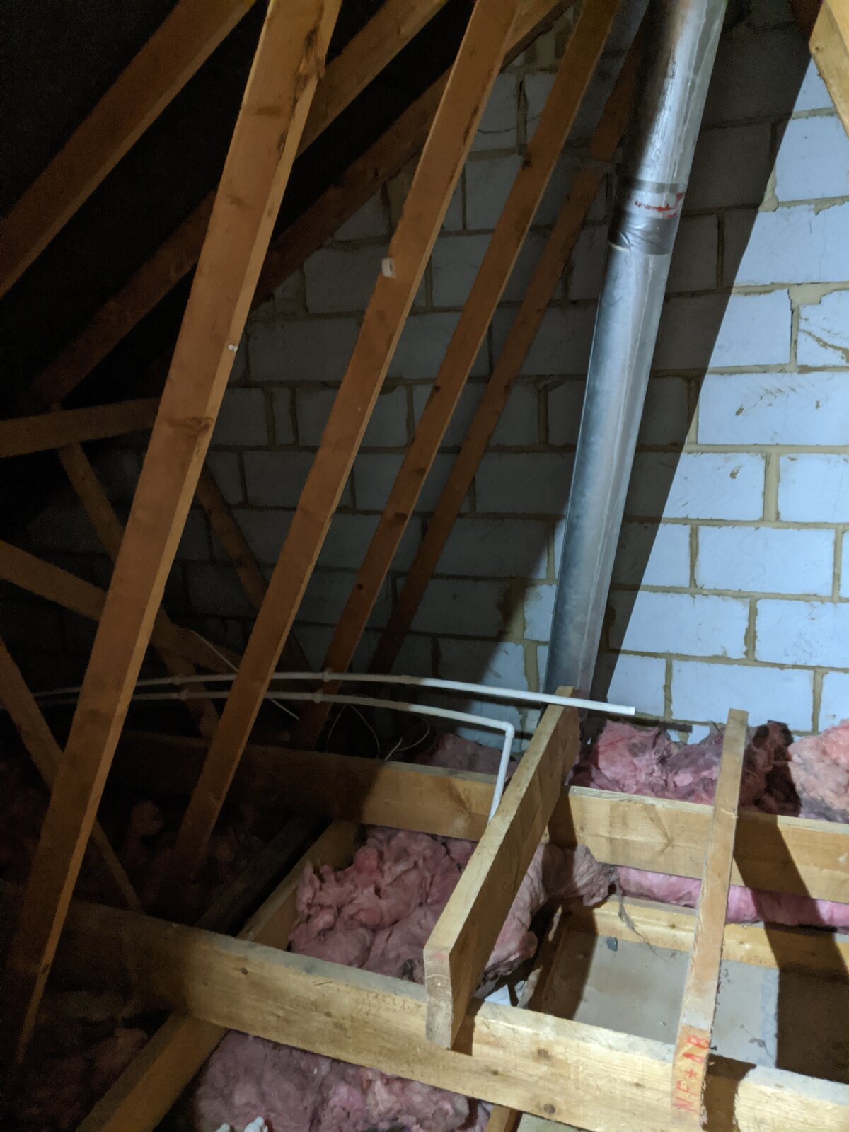

@muggles: I've re-measured and my joists are 35mm wide and 120mm deep if that helps?
@Nige F: Your comment about minera trusses cold water storage reminded me that I actually had a cold water tank in the loft before we switched to a system boiler and whilst it's not where we ideally want to situate our cylinder, we could compromise and re-use the platform from before which I imagine was installed when the property was built in the late 90's.
I've attached some photos of the platform which appears to be made up of 8x2's and 6x2's and ultimately transfers the load across 4 joists, close to where the main apex of the roof is supported and nothing resting mid-span along the joists.
I would appreciate if someone could help me with the following questions:
1) Would the platform be adequate to re-use for a 200L cylinder? My laymans assumption would yes, given the load would be approximately 60-70kg per joist?
2) Could I re-orientate the uppermost timbers on the frame, so that they are lying flat before ply lining it again, so that the height of the platform is lowered?
3) If I made a quick A frame across two trusses, could the plumbers secure the expansion vessel against that, particularly as the cylinder will no longer be up against a wall?
