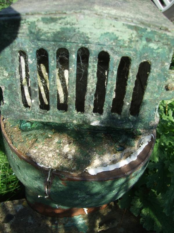

It's not so much a vent, but an air intake valve. They were put on the last manhole before the main sewer if an interceptor trap was used. The idea was to balance the air pressure and stop the trap from emptying of water. There should be a mica flap outside to stop any sewer gas from escaping. Most of these don't work anymore and it may have been broken off and buried anyway.
Usually look something like this
full
full
yep - that's exactly what it looks like
The actual purpose of the vent on that chamber was to ventilate the house sewers. The Victorians had a bid thing about 'drain air' believing initially, it was the cause of most ills of that era, and then when drainage developed into the typical systems we still see today, they used an interceptor to seal off the house drains from the main sewer in the road. The idea then was, as air passed over the top of the stack, it would draw air into the system through the low level vent and then out through the stack, thus venting the system. The main sewers were vented independently with cast iron stacks in the street.
I would advise you do not fit a bung in that rodding eye. They can become dislodged in the event of surcharging in the main sewer, and then cause further problems downstream. Provided the bottom outlet is kept clear, and the flow can pass through here as designed, then the arrangement can be left as is. The rodding eye on the top was purposely provided to allow access through to the drain/sewer beyond the interceptor to allow rodding access in the event of problems, and therefore a blind connection to the sewer was often the case.
Where is Newboy 'wrong'? As far as I can see he has named the part in question as an 'interceptor', common name for it, and a common installation of that era, right up to the 1940's, and his other points seem valid to me!
