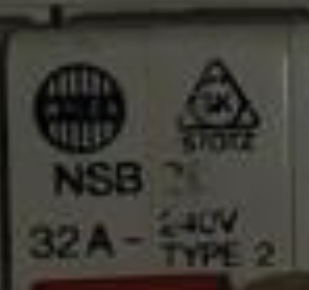

First, is it an MCB or an RCD (or RCBO) that is tripping- pics will be easiest.

This is the circuit in question
I haven’t opened up the CU to check but assumed that it’s a ring because if I grab (with power switched off) 2 neutrals at any socket or 2 earths, my tester shows continuity. I assume this wouldn’t be the case with a radial?
