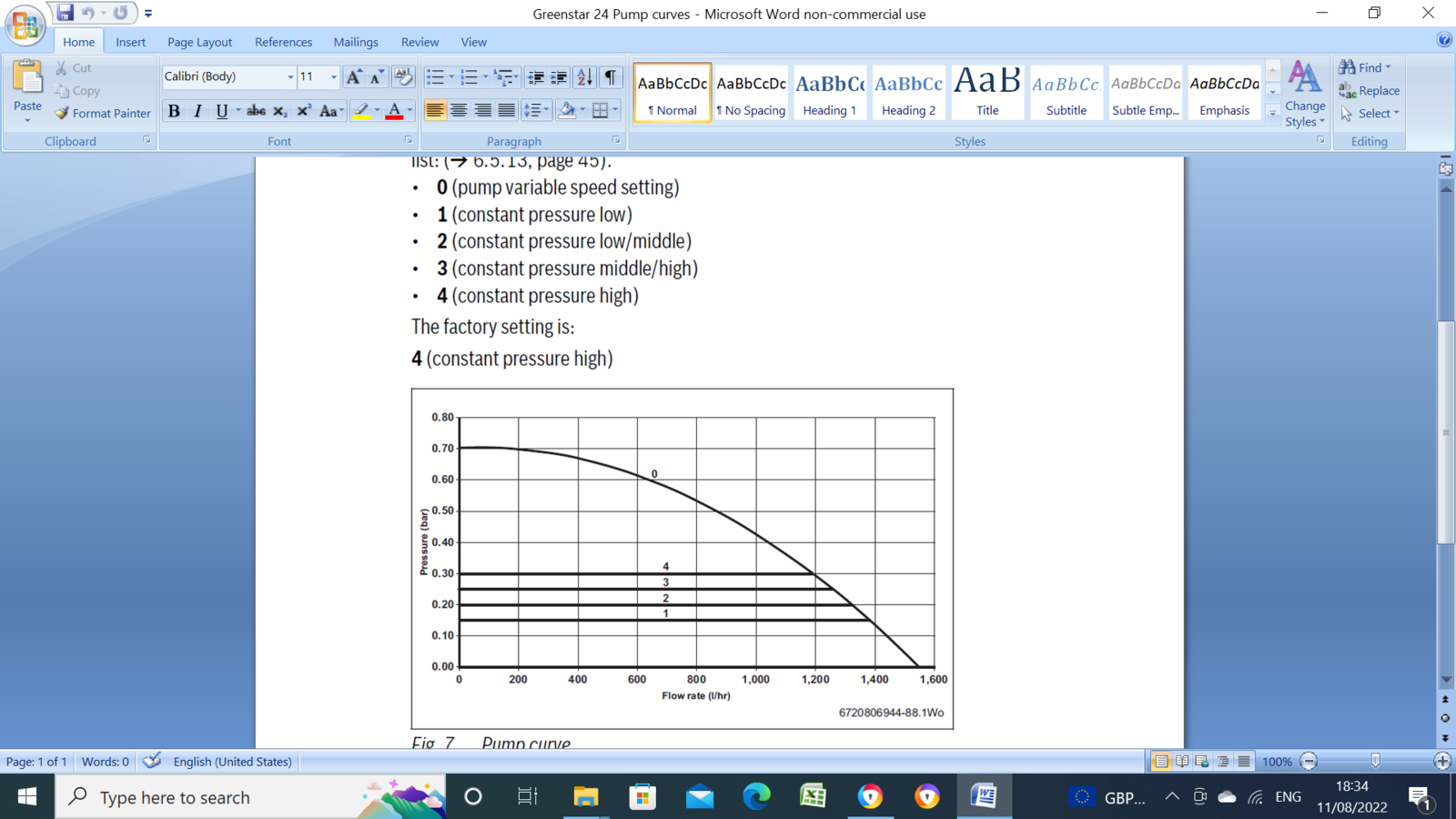

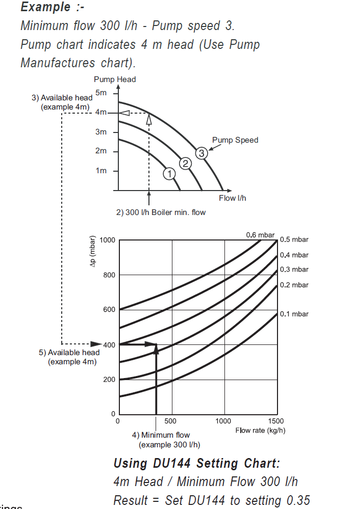

Hi, I'll be fitting a Honeywell DU144 ABV to replace a corroded gate valve. Honeywell's instructions require the pump head and flow rate to calculate the ABV setting. I've found the pump head (2.0m) in the technical data of my Greenstar 24i sealed system but the flow rate is not listed. Is this because the pump runs at variable speeds according to the demand?
Should I simply set the ABV by adjusting it to just open during the 3 minutes after the boiler has shut off when the pump is in overrun?
That's probably your best bet but ABVs are really made to be set in conjunction with a pump with the traditional 3 speed settings (constant curve) where the pump head rises as the flowrate decreases, your boiler circ pump runs in constant pressure mode so quite difficult IMO to set up, I would try and locate the ABV as far away from the boiler/pump as possible as the flow/return piping losses should mean that the pressure at the ABV will be slightly lower at normal circulation rates and will rise a little with the reduced flowrate required on pump overrun which should make setting the ABV easier?. I would also install a new gate valve with the ABV which may make it easier to get the ABV setting right.
