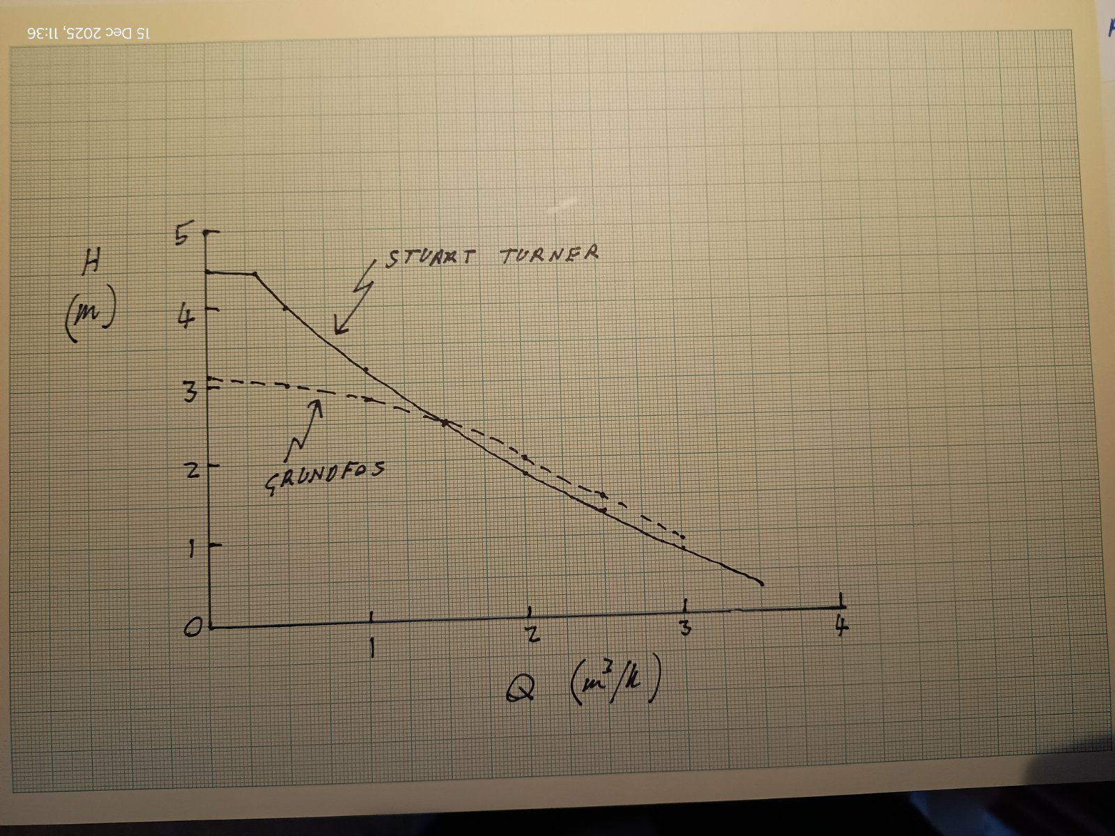

Anyone up for a(nother) discussion) on ABVs?
1. ABVs open in response to the increased upstream pressure that results from closure of MVs (or TRVs).
2. This mechanism will only operate effectively if the performance characteristics of the pump concerned include a pressure increase large enough to open the valve, for whatever change of flow is involved.
3. Inspection of performance curves for different pumps, on constant speed settings, shows a wide variation in the extent to which reduced flow is accompanied by increased pressure. Grundfos pumps for example have relatively flat curves i.e. reduced flow is accompanied by only small pressure increases. Stuart Turner pumps have curves with a greater gradient at low flow rates. Attached is a sketch where I have transcribed the published performance curves for setting II on the Grundfos Alpha2 15-60 on the same axes as the Stuart Turner ST 15-60.
4. Pumps like the Stuart Turner should therefore be inherently better at operating ABVs. With pumps like the Grundfos (i) it will be hard to set the ABV correctly and (ii) in order to allow adequate flow during over-run, the ABV will also be open to some extent during normal operation (bearing in mind that the valve characteristics involve progressively greater opening as pressure rises, rather than a cliff-edge effect).
I have a system boiler with S plan, two MVs, hot water cylinder, Honeywell autobypass valve (ABV)and a mix of standard and TRV rads. The pump is a Grundfos, and my experience confirms these predictions: if the ABV is set to give an adequate flow under over-run conditions (say 300 L/h) it will inevitably also be open to some extent under normal running conditions. My estimate (based on the power consumption of the pump, which is shown in real time on the Grundfos) is that under normal CH running conditions, with the HW MV closed and CH MV open, a little under half the boiler flow is passing through the ABV. Because of this I am considering changing it for another pump with a steeper performance curve, in order to improve the overall performance of the system.
Does this make sense and, if so, why have I been unable to find any coverage of it on the web? It seems a significant issue!

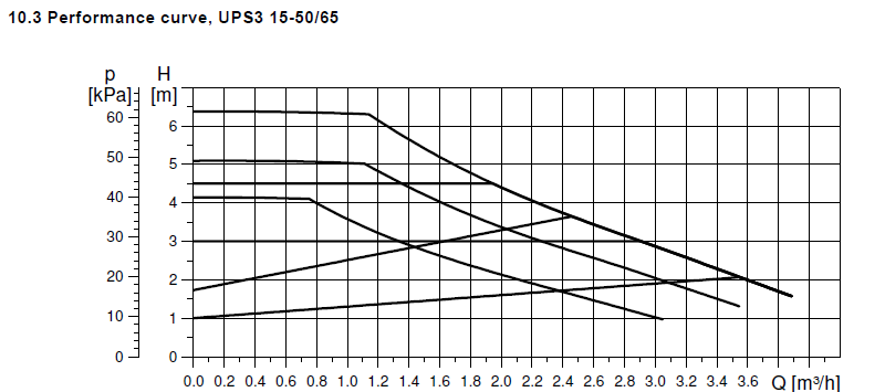

Is there a faster speed on the Alpha 2 which looks more like the Stuart Turner curve.
I've also been wrestling with this for years - partly because I have found that professionals tend to screw the valve down a long way so as to minimise flow during normal running, apparently without realising that this is accompanied by inadequate flow during over-run.
I've attached the performance curves for all settings on the Alpha2. As you suggest, setting III on the Grundfos does indeed seem a bit more promising, at least until you get down to about 0.7m3/h, where there is an inflection and the line goes almost horizontal. The Stuart Turner on setting II also has an inflexion (see previous attachment), but this doesn't kick in until flow is below about 0.3m3/h.
I used to run the Grundfos on setting III and the ABV problem was, as predicted from the curves, less severe than it is with setting II. The new boiler does not like setting III however. It repeatedly shuts down - I am guessing because the return temperature is too high for its liking. Setting III is really more than my smallish terraced property needs anyway.
I've always assumed that constant pressure modes are a no-no because there would be no pressure increase at all to open the ABV, when the flow rates declines. And the Grundfos "Proportional pressure" modes are even worse because pressure actually declines as flow rate goes down!

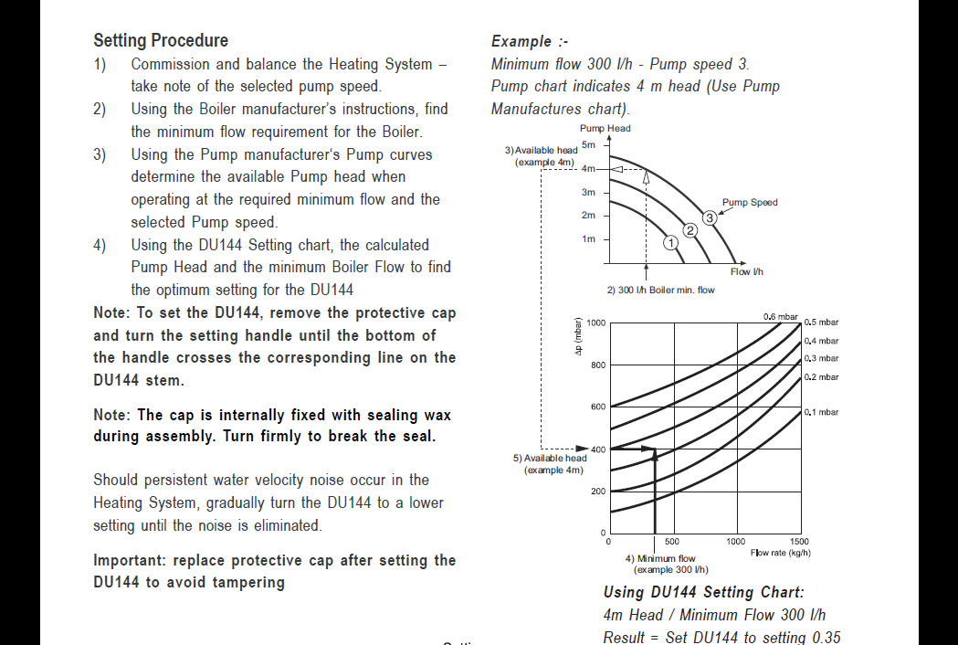

This is, in reality, is NOT the minimum flowrate required, most, if not all, publish a flowrate simply based on a boiler flow/return dT of 20C,
So a 18kW boiler will require a flowrate of , 18*860/60/20, 12.9LPM. A 24kW boiler will require, 24*860/60/20, 17.2LPM, etc. If the minimum output of this boiler was say 5kW then the flowrate required to maintain this 20C dT is only 5*860/60/20, 3.58LPM, etc, quite a lot of (system)boilers do now control the pump speed which controls the flowrate based on the boiler output, the newer Vaillants allegedly allow a settable dT of between 10C and 20C, unfortunately this does not work, or did not work anyway on one that I was in talks with, with Vaillant. PP (control) does give a reasonable reduction in flowrate as zones are shut off or TRVs start throttling down because PP control reduces the pump speed on increasing head whereas with CC (fixed speed control) the head increases with reduced flowrate, this worked very well with ABVs hen using the older (non smart) type circ pumps, for whatever reasons now, some "smart" circ pumps do not give true fixed speed control, some are worse than others, Grundfos, in particular, are pretty poor and the UPS 3, a very fine powerful 6M pump, virtually NO fixed speed control, especially where one needs it most, at reduced flowrate, see below. Some, like my (6M) Wilo Yonos Pico are not too bad.
THe fact of the matter though is that the pump head on any centrifugal pump (on fixed speed mode) will or should start falling immediately any flow commences but we are "outsmarted" by the smart A rated pumps now.
Example, below of setting up a Honeywell DU144 ABV,

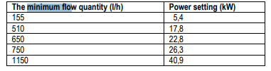

Intergas might be the only manufacturer which publishes proper minimum flow rates for different modulation levels. They say 155 litres/hour at 5.4kW.
