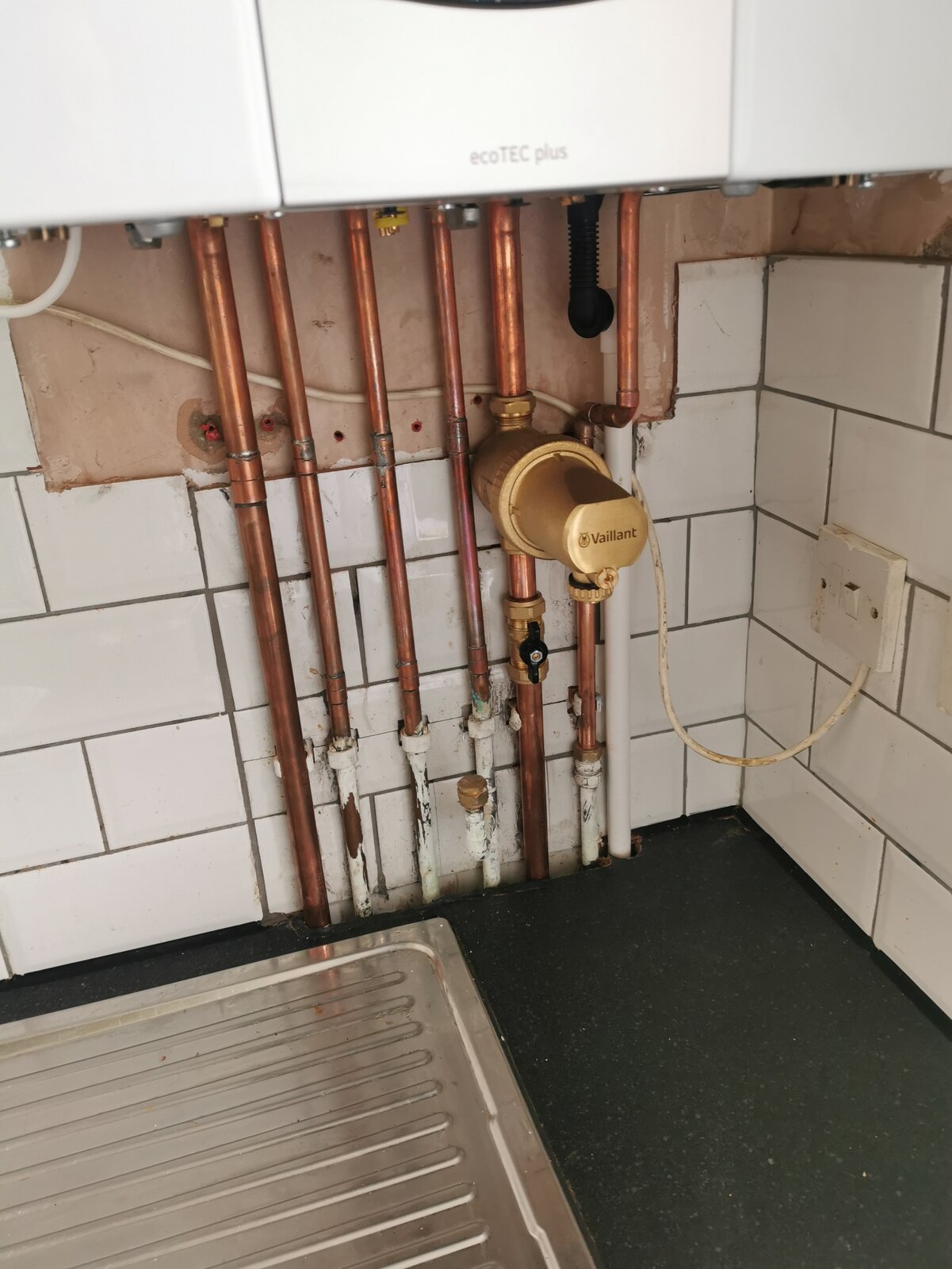

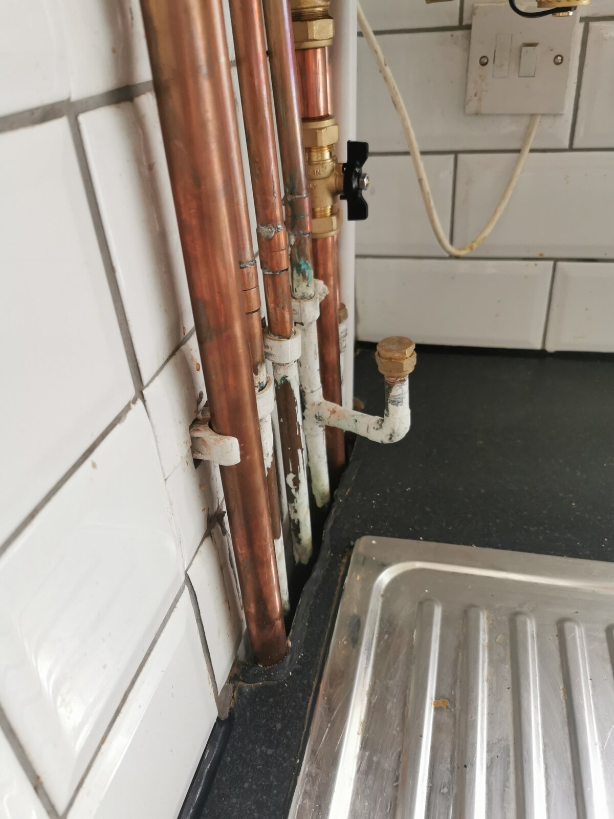

Hi, I've recently had a boiler fitted and was planning on making good the pipework once they had finished. I came back to find they had left it like this. I have posted this on another forum here and the consensus seemed to be that a) this is perfectly acceptable and b) I should have asked them to remove the ugly spigot (which was the old filling loop) rather than just assume they would have removed it if for nothing more than ease of finishing. Aside from the attitude I have noticed thus far from the trade, I am interested in further opinions from currently working heating engineers as to a) is this currently an acceptable standard these days?, b) do you think I am at fault for not mentioning beforehand that I would like the finished job to at least be practical to finish off with some thin boxing, and that I would like pipework that is no longer serving a purpose to be removed? and c) any suggestions as to what to do next?, thanks in advance
a) Yes, but the capped pipe spoils it a bit.
b) I don't think you'd be expected to specifically ask for it to be removed beforehand.
c) Have you spoken to the fitters? Explain that they have done a good job but you'd appreciate if this could be removed?

What upset me was the fact that the fitter told my mother that she could plumb a dishwasher onto the capped pipe, and another lie regarding some chrome tube, the small amount of effort it would have taken to remove the t and swap it for a coupling, the again, laziness in filter position, its been fitted at the exact length of the pipes that come with the boiler, as seen by the other soldered joints, I'm sure that could have been cut back a bit to lift it higher so maybe get a kettle under it, and the general lack of respect to other peoples property. I myself am in the construction industry and the phrase 'cant see it from my house' springs to mind.

ps he left the filling loop wide open so I had to figure out for myself why there was no hot water at the tap. Boiler is currently at 2.2 bar cold.
I’ve seen worse. That capped pipe unless used is considered a dead leg and the cable is touching the gas pipe and should be a minimum of 25mm away. Regards boxing in, do you think every gas engineer is capable of woodwork and was this agreed to be done?

Yes they could have removed the dead leg but technically it wasn't part of the work.

Im sure a message to the company owner would be seen as reasonable and the dead leg would be removed.
