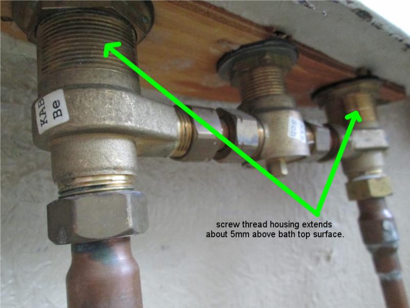

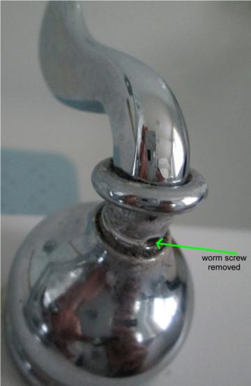

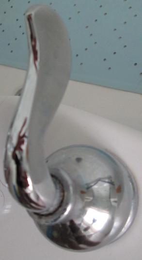

How do you access the tap washer on this thing:
There's no external worm screw to hold tap handle or body on!!
Undo the shroud and see if there is enough room to undo the tap head with a thin spanner.
Andy

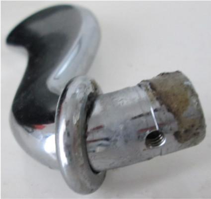

Well I removed worm screw (2mm hex) and didn't alter things, I still couldn't remove the tap handle or the rest of the shroud. :?
You should just be able to pull up on the handle and it comes off, you may need to tap it as it might be stuck on. Have you tried to unscrew the shroud? A pair of grips and a wet cloth over the shroud may move it.
Update: I have tried to hitting tap handle gently but it refuses to budge. I have squirted some wd40 into the worm screw hole and will wait a couple of hours for it to soak in.

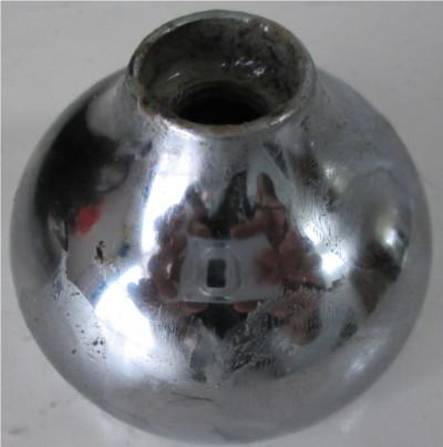

I can undo shroud but the tap handle needs to come off before it can be removed.

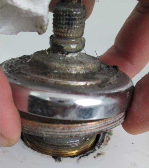

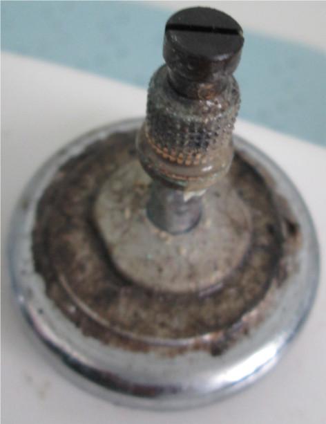

Managed to dismantle tap a bit more but stuck again!
Washer doesn't simply lift out. I have removed the screw at the very top of the spindle but doesn't help me remove washer.
If anyone knows how to get the washer out I would be grateful and will post more pics for future people to see and learn from.
The tap handle
The shroud

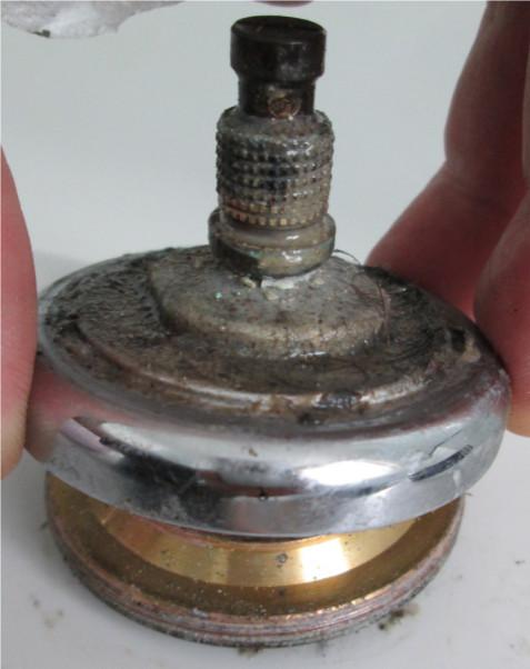

The spindle

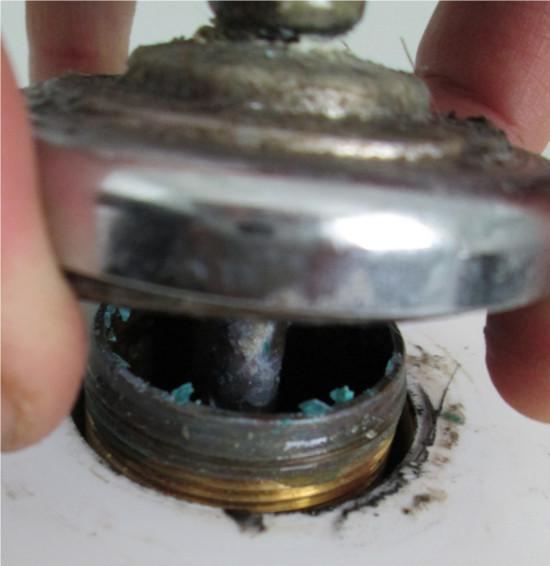

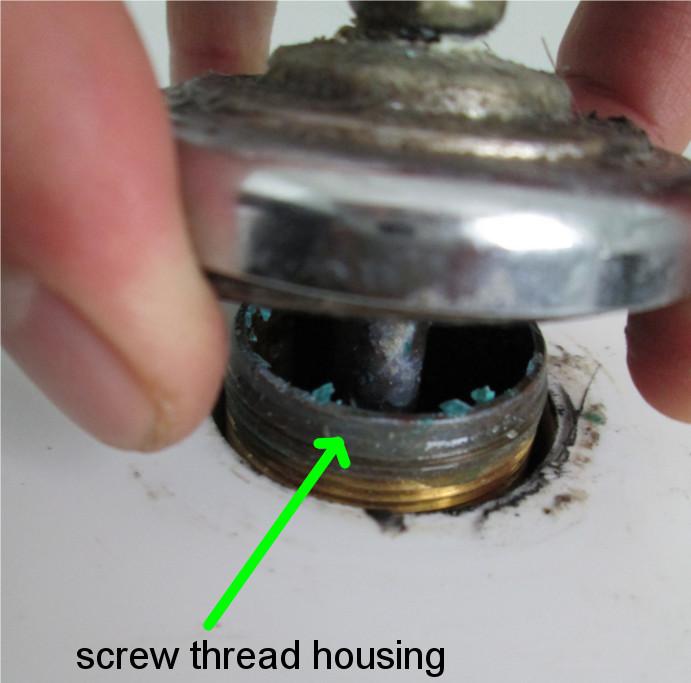

Lifting up the retaining nut and nut housing
Lifting up the retaining nut and nut housing (this is as far as it lifts!)
I have put tap back together as I cannot figure out how to dissemble it anymore :evil: .
However spindle can now be pushed down, and when it is, water leaks up the sides of the spindle onto the bath top! I will probably have to replace this cr*p with a new mixer tap. But I will ask for a demo of how to change the washer before buying to make sure it's not some bizarre cr*p like this one LOL !
