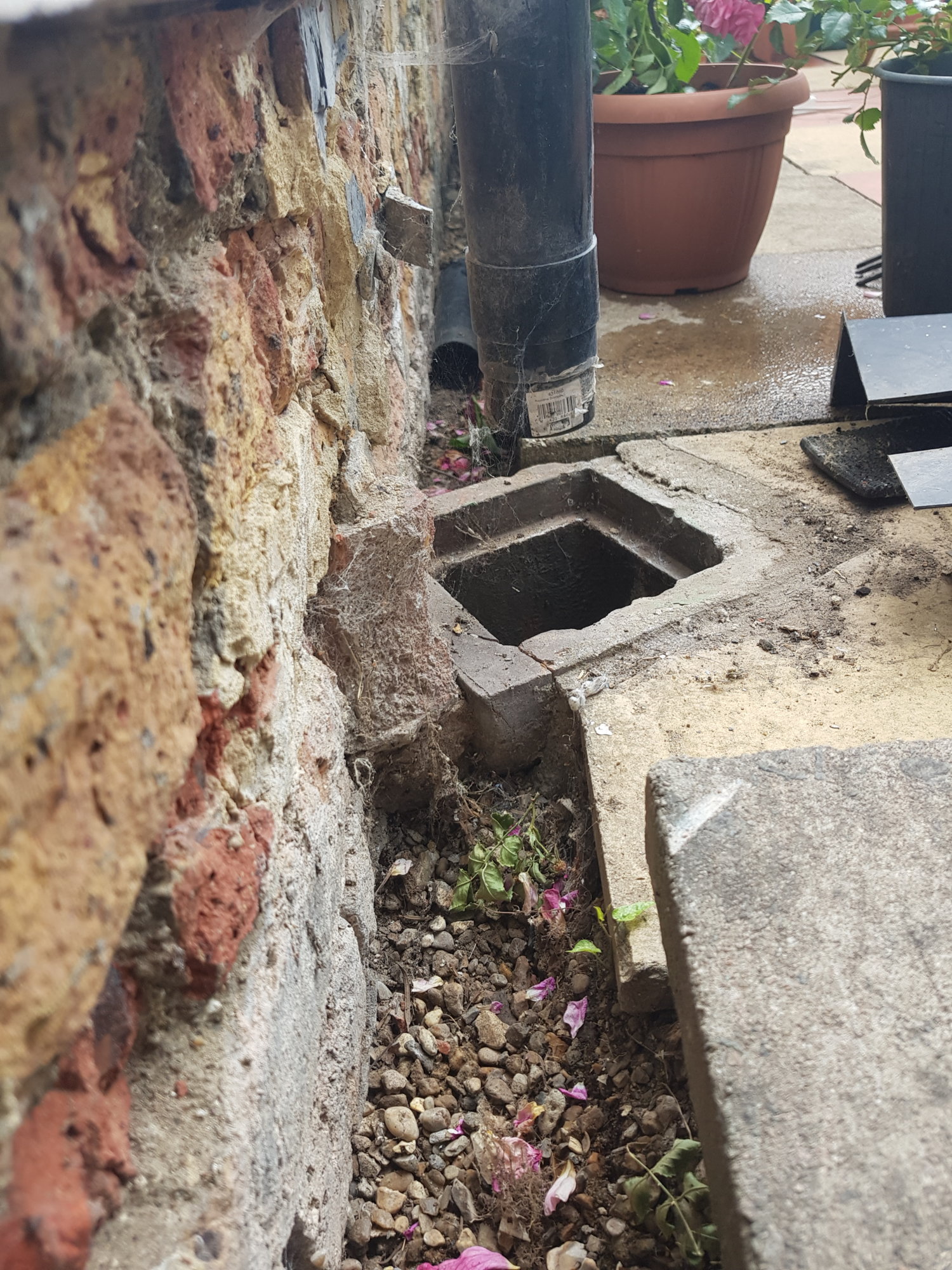

Hi, have a ditch between my patio and back wall of the house, presumbly dug out by the previous owner, and filled in with shingle. Had a damp problem on the back wall, and removing some of the mud/shingle that was going above the DPC, and some of the render to let bricks breath seems to have sorted it.
I now want to install aco drains along this channel so the water doesn't just sit in the gully, and then re-render down to the DPC. However, I'm not sure how to connect the aco drains to the existing hopper, which i don't think i can cut into with out breaking. I don't want the aco drains to protrude above the patio floor.
Any advice? I'm not sure what the hopper connects to without digging up the patio, so am reluctant to take it out and replace. Had a guy who said I could just cut into it with an axle grinder, I didn't take him up on that.

It will be an awkward connection because of the angle your gullys at.
The bottom of the pipe will be level with the top of the water in it so shouldn't be too deep of a dig.
I think you will have to either bodge it like the guy says or get the shovel out, you really want a 4" trap under the outlet to catch any silts then connect into the drain further down.

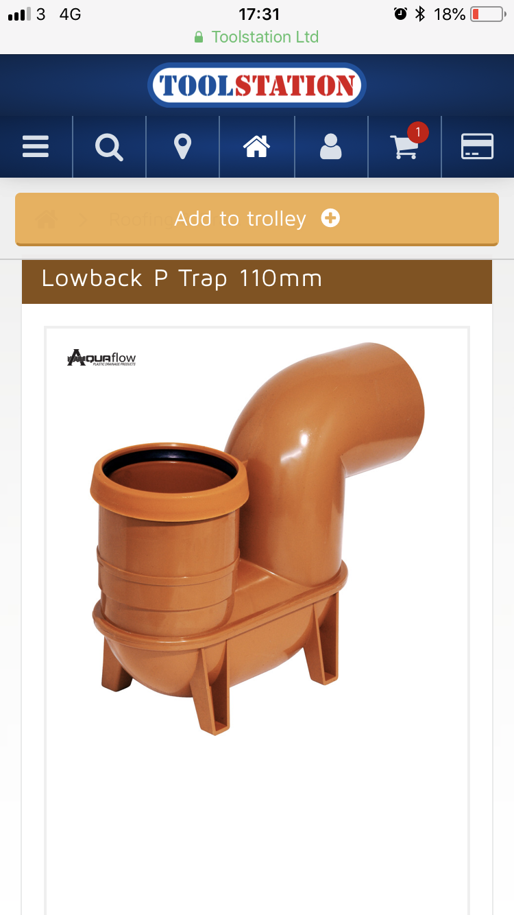

I would swap the gully for an Osma 4d900, run that about a meter to a small inspection chamber.
Then a pair of these under the aco outlets:

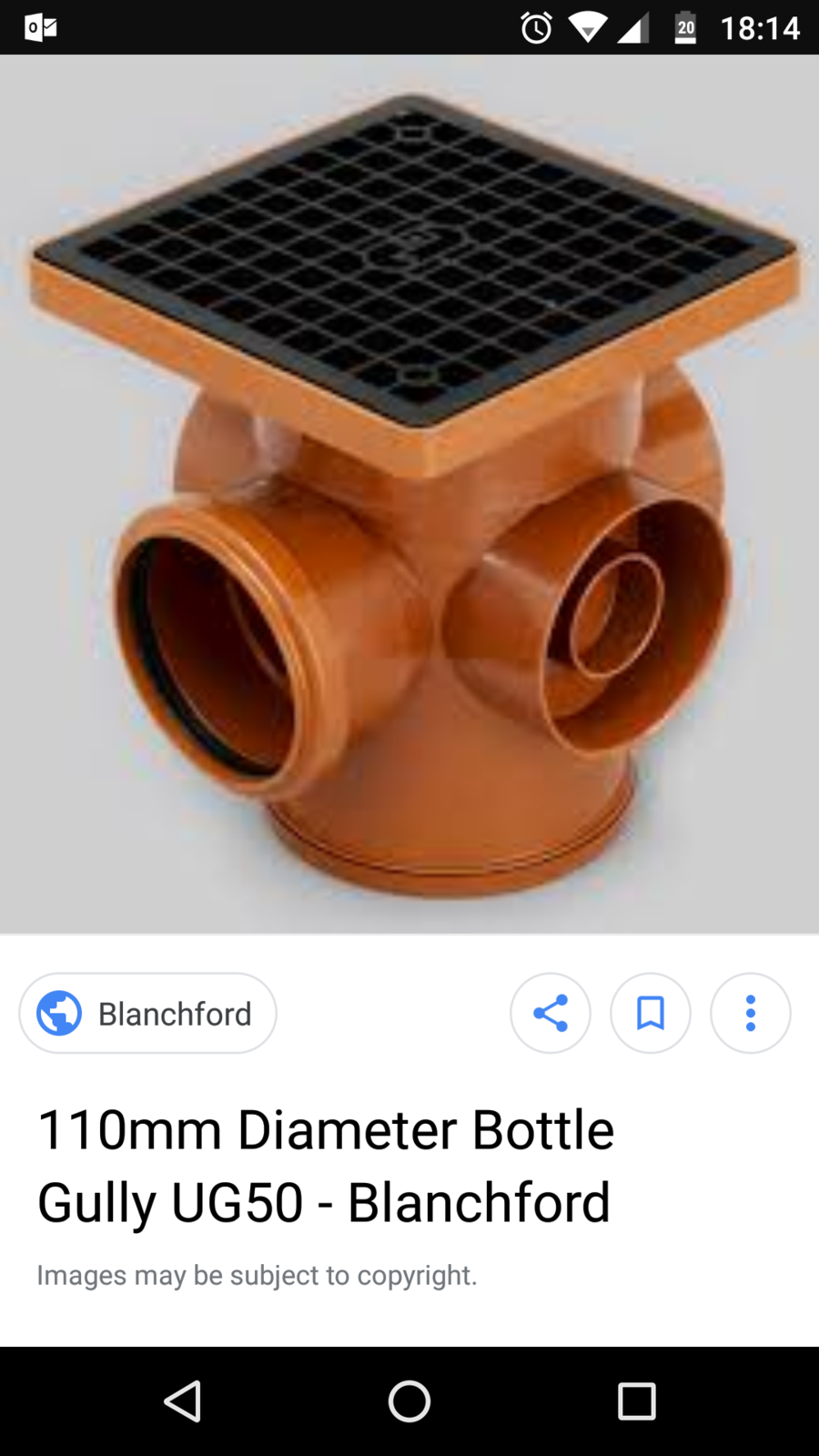

I can't quite be sure (as it's covered in concrete) but I think I used a Marley UG50 when I did similar:
The 110mm end outlet adapters from the channel drainage fit into the 2 side inlets, you'll need a few plastic bends, a length of 110mm pipe and a plastic to clay adapter to join the new gully to old pipe and an angle grinder to cut the pipe. Most of the modern channel drainage is plastic and needs to be bedded on (dry) and surrounded by (wet) concrete.

cdbe is showing the rightfittin for the job. side entry is the way to go.
op, but your troubles dont end ther.
i can see what looks like a slate DPC in the very bottom visible mortar bed. this means your yard an patio ffl have been raised well too high.
an you should go back down 150mm below the slate DPC for the new patio level for a first class job.
that probly wont happen but yove got to stay below the DPC with ground level to give yourself a chance.
your brick faces are spelched an the pointing is rubbish. the lower wall will suck in moisture. the render was originaly applied to protect solid walls of very poor quality briccks.
guessin that youve got a solid floor inside means thers probly still damp.
in the photo why is the down pipe unclipped ? the pipe should be closer to the wall an angled out at the last minute just above any gulley.

No, I don't think that's quite right - the UG 48 looks like just a hopper so will need to sit on a separate gulley (and the 2 inlets aren't large enough for the channel adapters). The second one is a gulley but only has two connections - you need three - two side inlets for the channel and one out the front to the drain. It should become a lot clearer if you dig it all out - then sit down and have a look at it all, including your levels, pull some images of various gulleys etc on your phone and you'll work it all out. Screwfix sell a (floplast) channel system that might be cheaper/easier to get hold of than the genuine Acco stuff, easy cut with the grinder.
Ah cheers, obviously I need to do a bit more reading up on difference between hoppers and gullys! Just found a great site called paving expert, which is helping me understand how it all works.
With the hoppers/gullys I linked seems I (wrongly) assumed I would be able to connect the linear channels directly into the sides of those but if I understand what you’re saying it is better to fit a bend from underneath the channel drain into a bottle gully? Then the gully drains away into my existing drainage system via a pipe coming out the front?

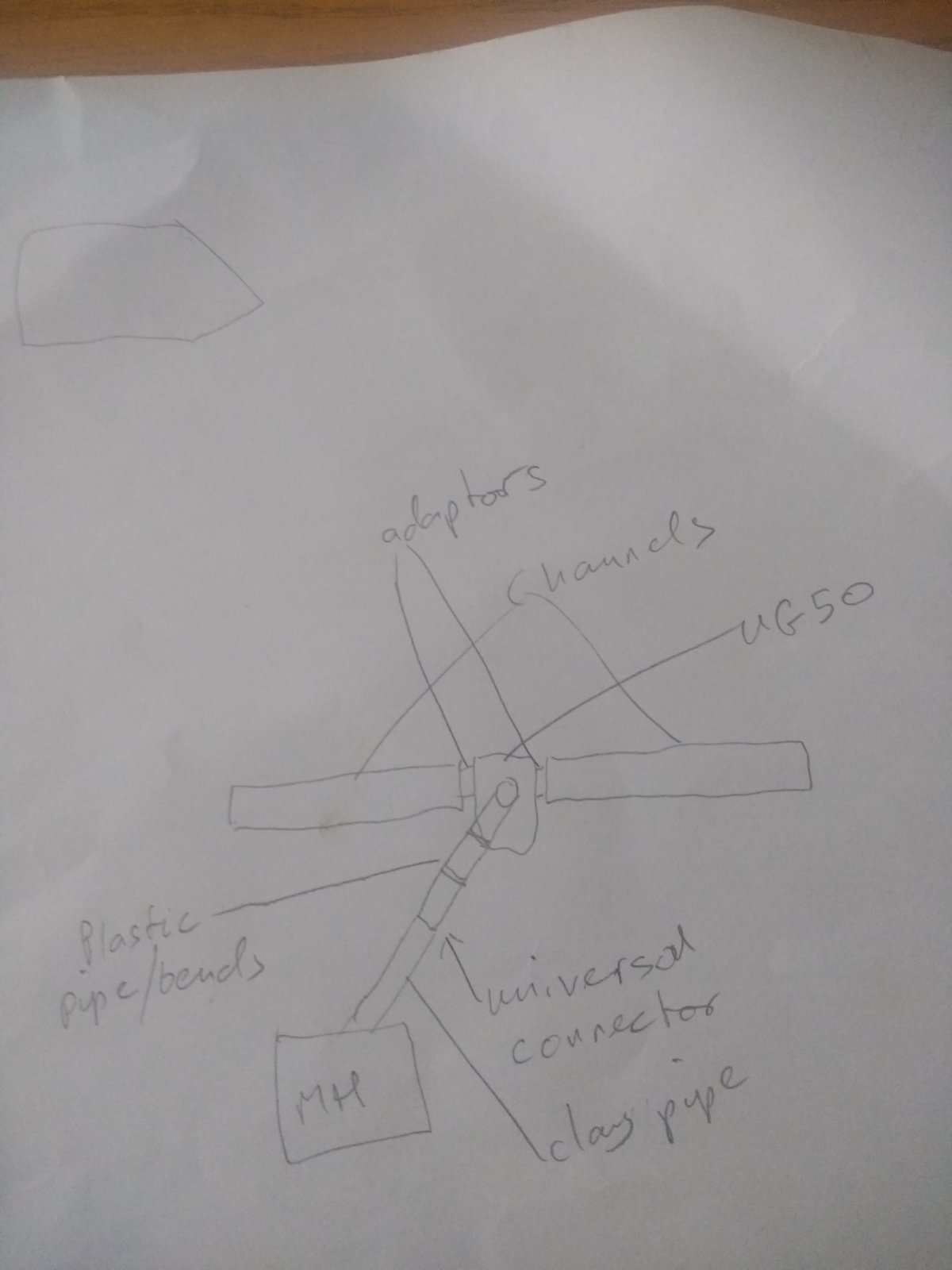

The drainage channel should connect directly to a UG50 type gulley using the appropriate 110mm adapters for your channel:
If you can follow my picture this is what you're aiming for:
Awesome, that makes sense, thanks. I've never seen a manhole in my back garden so have no idea where this even drains to...!
