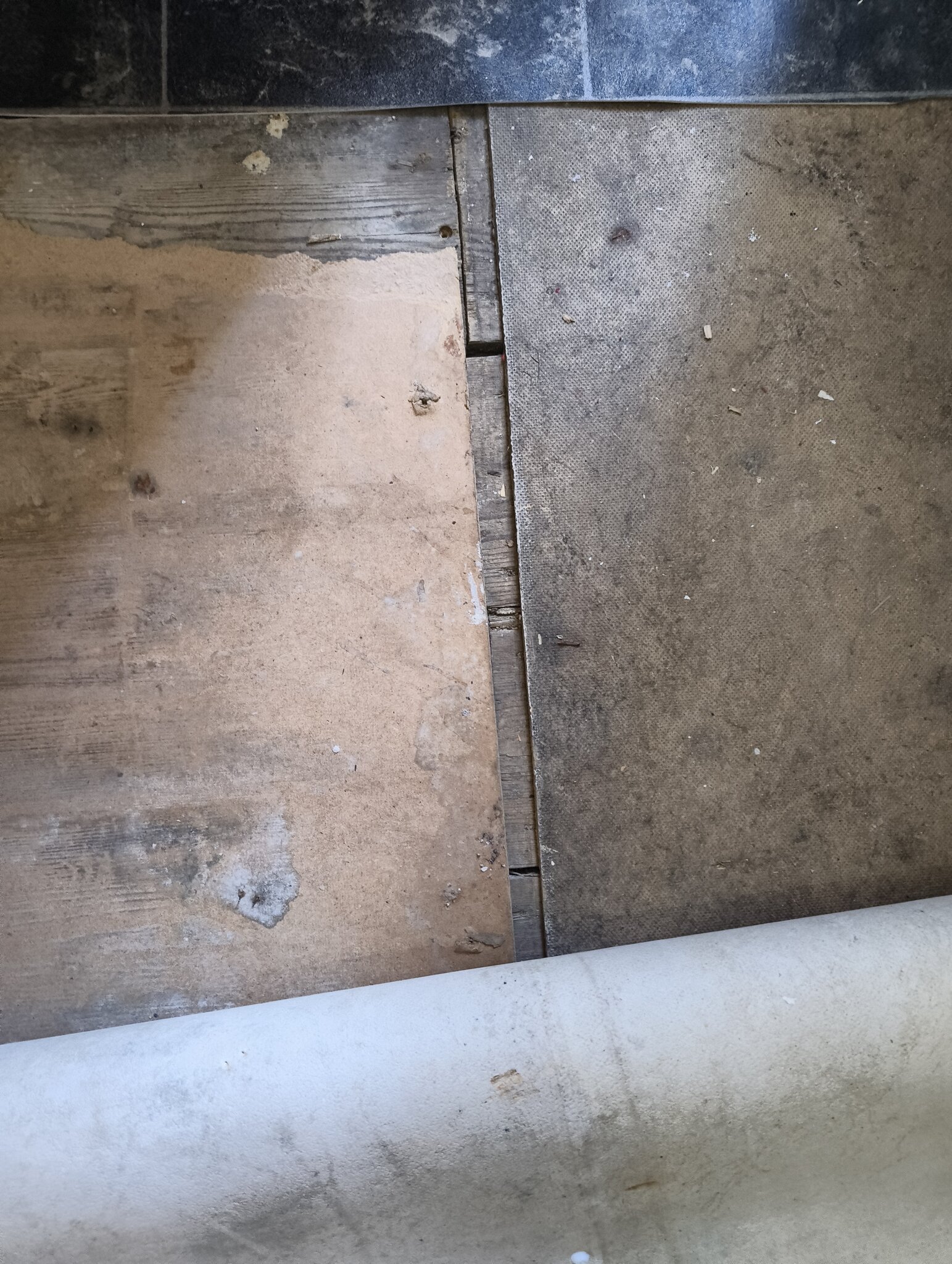

Actually, I only have 200mm to play with between the bottom of my boards and the top of the ceiling. Also, here is a pic of the material under the lino in the kitchen. Same stuff is under the carpet in the hall outside the kitchen and the front room so proably also on the stairs and the back room and the bathroom.

That's hardboard (badly) laid under the vinyl (not lino)
It is intended to cover the joints in the floorboards so they don't show though, but yours is so badly laid that the joints in the hardboard show through as well.
If you ever want to lay any, start it the centre of the room, and put factory edges together ( they will fit perfectly) and smaller pieces round the edges, with any cuts facing the skirting. It is usually stapled down.
It looks to me like it will be fairly easy to get your floorboards up.
Start in a small room for practice.

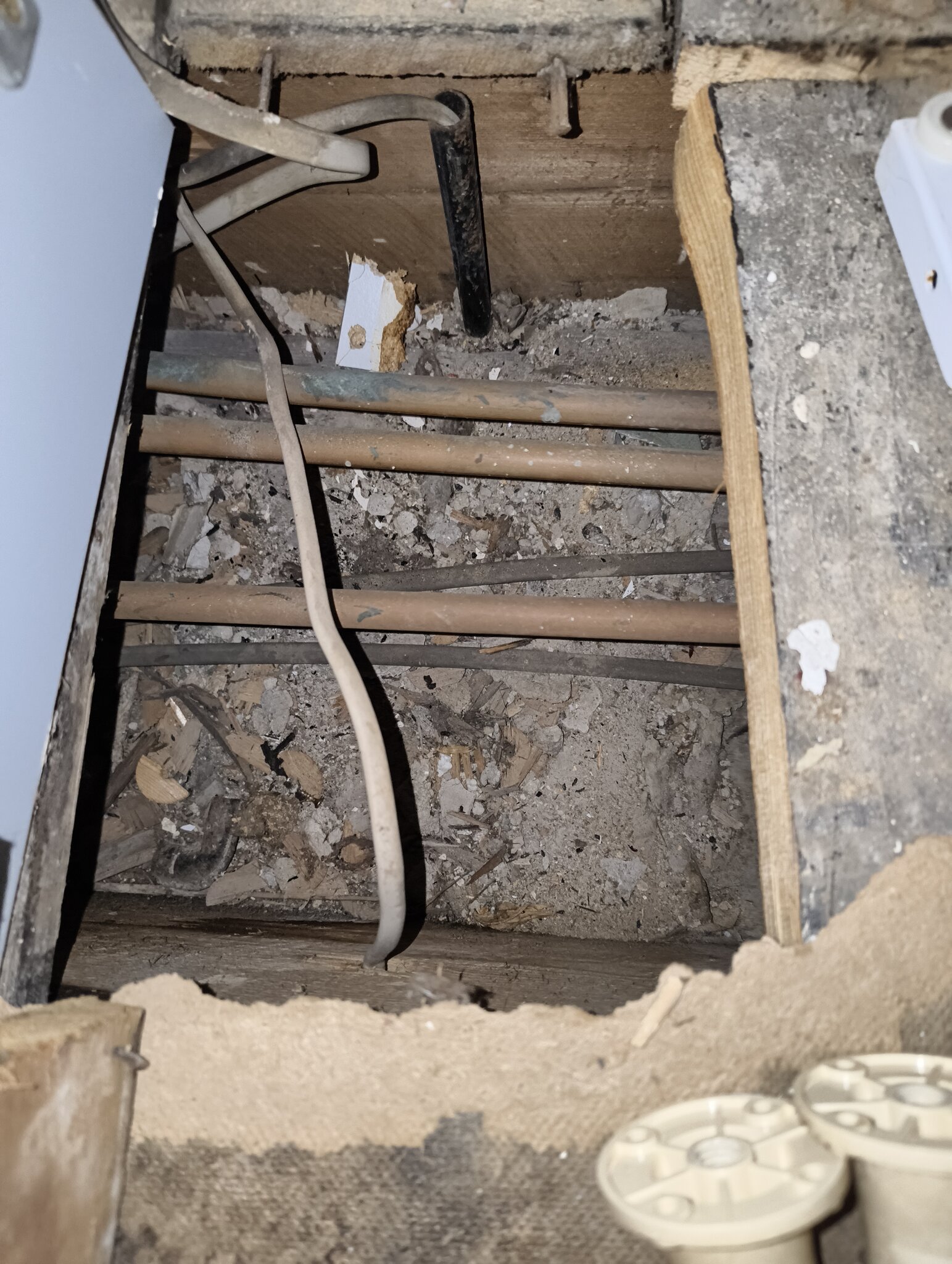

Quick question, where I have had floor boards up in the kitchen to check over pipes, I'm looking at that (two water pipes and a gas pipe running through the void between the joists as well as some electrical cables) thinking the only acoustic insulation possible will be loose fill. So I have some Thermofloc loose fill which, when chucked in by hand, is supposed to be 35kg/m3. And I'm just wondering if 200mm depth of that would have a similar effect as 100mm of 60kg/m3 insulation. It does not matter that much, I'm just wondering. Also, would it be okay putting loose fill into a void like this next to a wall or is that going to increase any issues with the ceiling below by an unacceptable amount?

The black "pipe " is I think black electrical conduit. The original single wires have been pulled out and more modern pvc t&e threaded through the save the effort of making a new chase. The end of the conduit can chafe or cut the cable so it ought to have a protective ferrule. There may be a way of bodging protection onto it, someone may know a good way.
The mineral wool is fairly easy to cut and squash into place in irregular gaps and round pipes and cables, I don't think you need loose fill.
I like to paint gas pipes yellow as a warning to be very careful. It's not a requirement but one day you might be glad you did. No need to be neat, just slap it on.
I use a Henry for vaccuming everything and it will have to do! I think it will!
How would you acoustic insulate that section?
Clean it out and cut a piece of mineral wool to roughly fit
