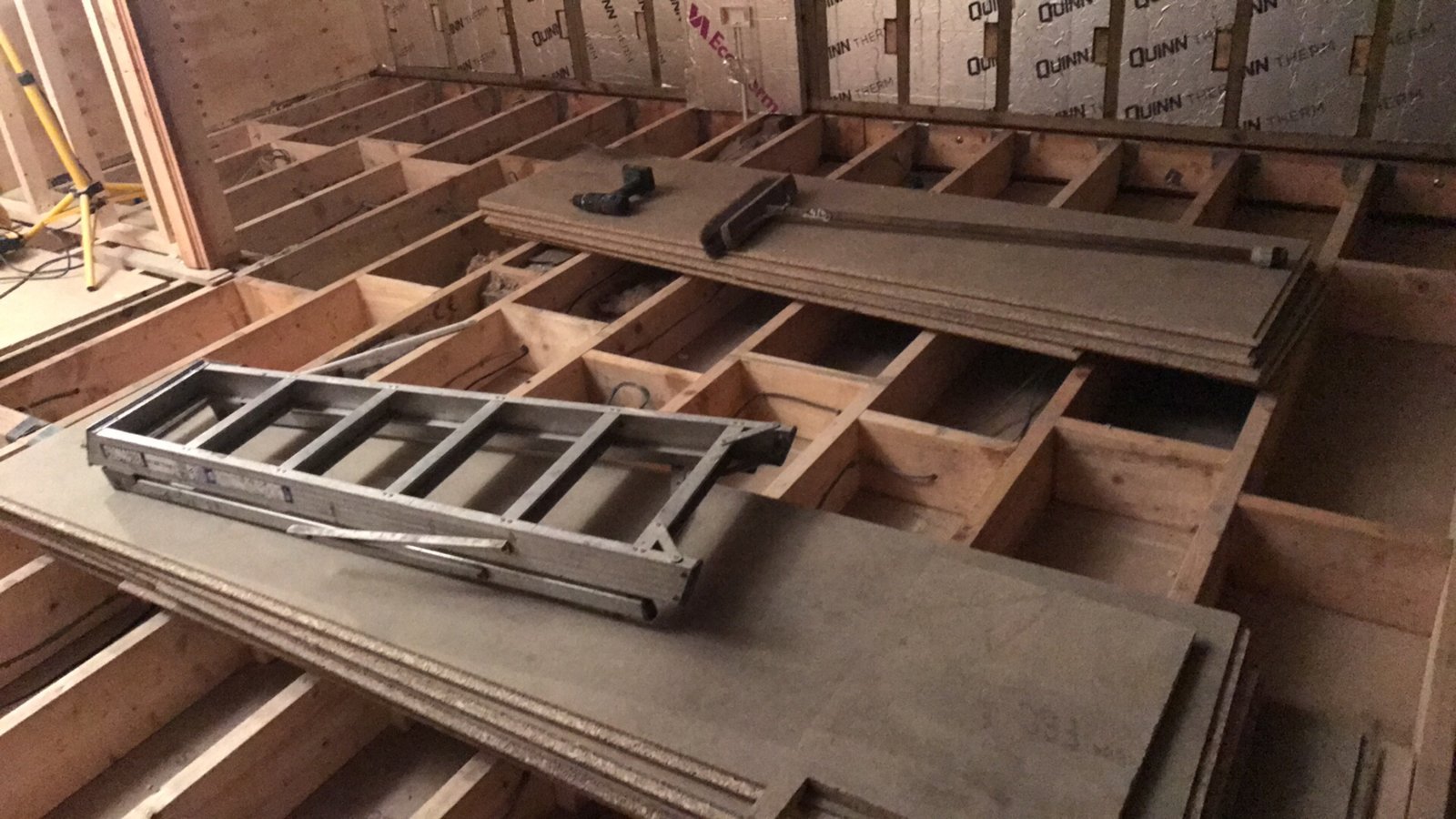

I had my loft floor down for a while and have just lifted it so the electrician can do his wiring before I insulate it and fix the boards.
The floor joists are 200mm deep and the plans show 100mm acoustic insulation.
When I google 100mm acoustic insulation I get all sorts or results but nothing seems to give any figures for its accousticness. I'm thinking of just getting some 200mm loft roll and filling it with that.
Then when I fix the floor should I glue and screw or might it be better if I put some strips of EDPM between the joists and flooring to stop any creaking? Not that it creaked much when it was down unfixed.
I would suspect they're referring to this sort of stuff, but as it's your own property, I doubt if they're going to be too stringent. The 100mm acoustic insulation should sit under any wires, but the 200mm may interfere with some of them; you can cover the lighting wire in the insulation, but not any ring main cables.
Glue and screw should stop any problems, but that's the boards to the joists, as well as to the joints. Interesting idea on the EDPM, it's certainly allow you to get the floor up again if there were any issues, but can't comment on how well it would work though.

Google "acoustic joist strip".
Thanks for that, there's a 3mm one on e-bay that looks right enough (y)
